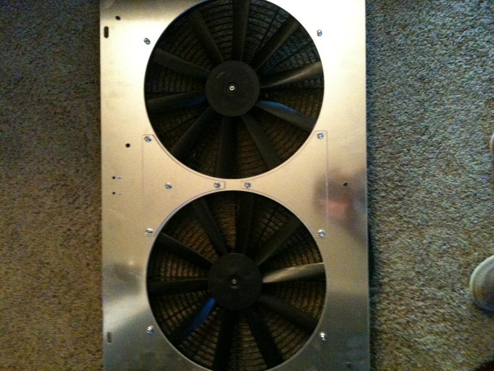

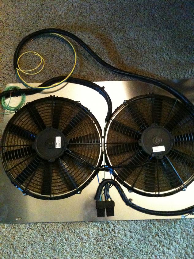

I bought trick performances electric fan kit. They drop right in and bolt up in about 2 mins. With the ls1 fans you have to find your own way to attach them.
