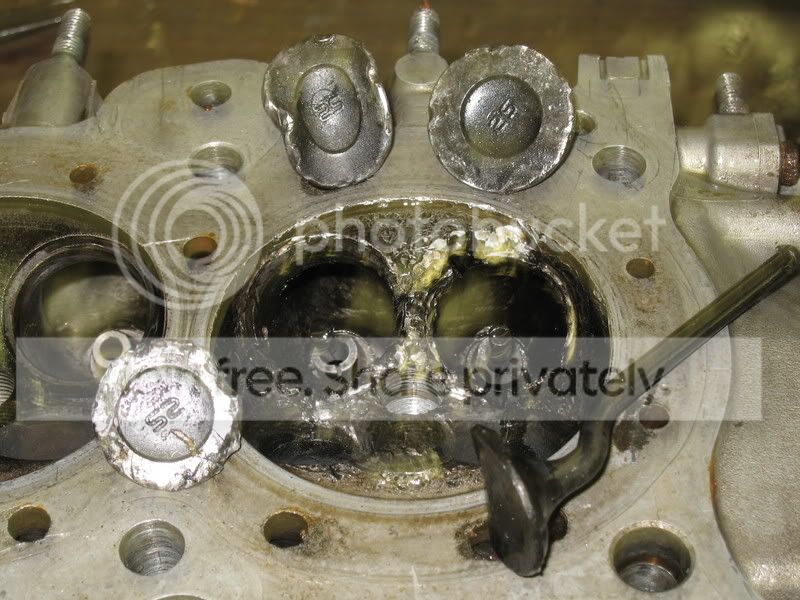

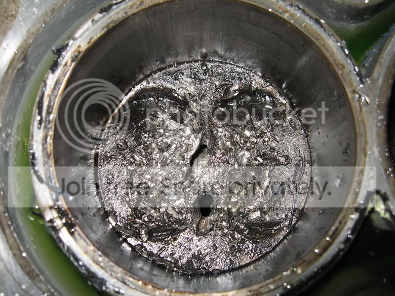

taken from our local forum. swap is the guy who has the dyno shop, and on the first pull, this is what happend. his shop was NOT the one that built the motor.
Originally posted by SwapDOHC
These were taken today of a customer's B18C1 block with a high $$$ port and polish head. Unfortunately the builder thought that dowel (Locating) pins were unnecessary, so he left them out. The very 1st time that VTEC engaged the head shifted and the valves hit the cylinders and 1 second later this is what was left.
Moral of the story, let someone who knows your engine, build your engine.

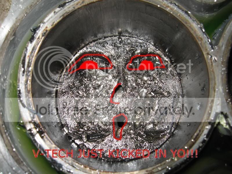

looks like a face to me!

I dont get it, did the hampster get loose when the head shifted off the block?

best picture ever. Don't let a retard build your engine either.

That is a great picture with the face!...I have a feeling that picture is gonna be posted in a lot of thread battles on import forums.

I'm still laughing from the look on the piston's face...looks like a dude who got kicked in the nuggets lol
