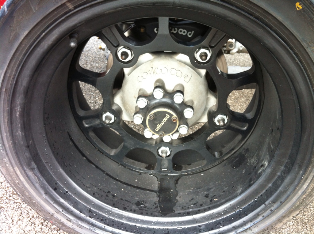

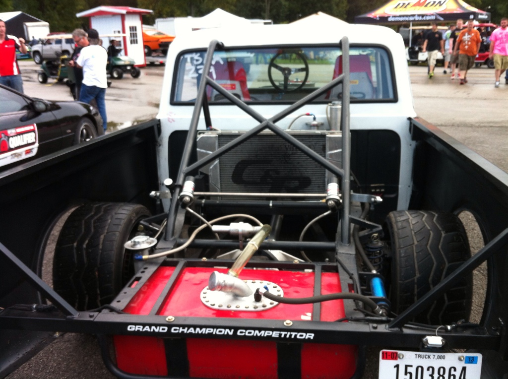

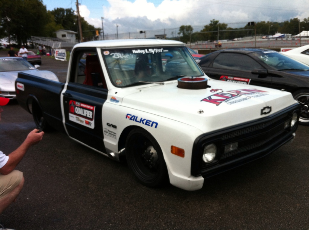

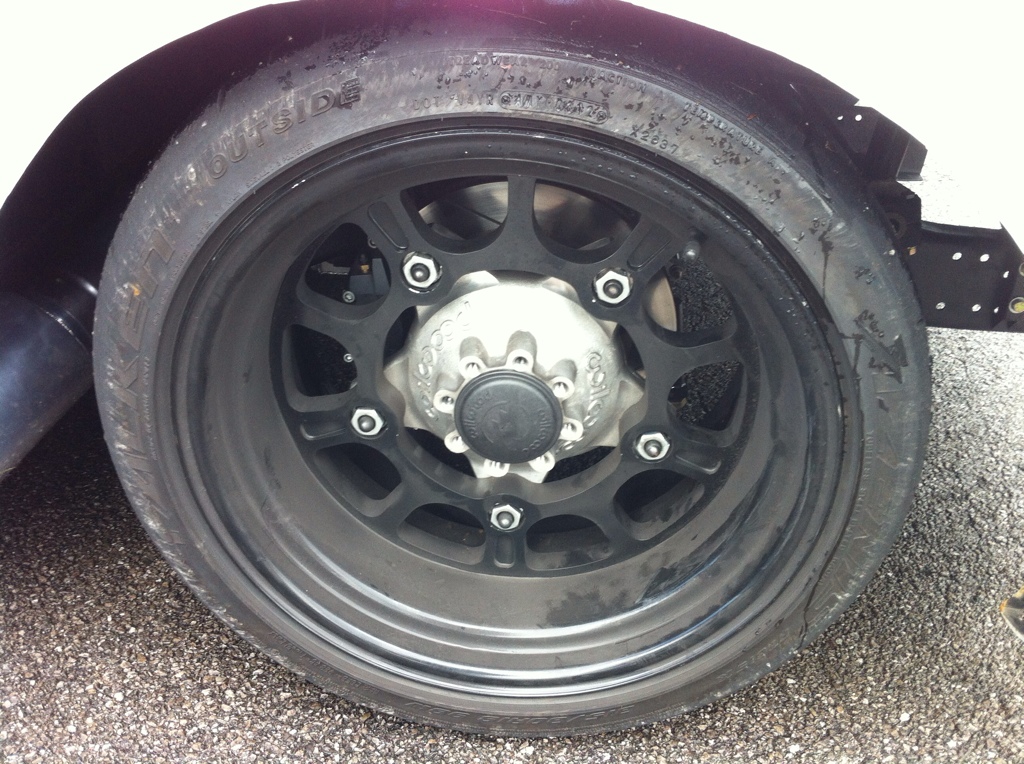

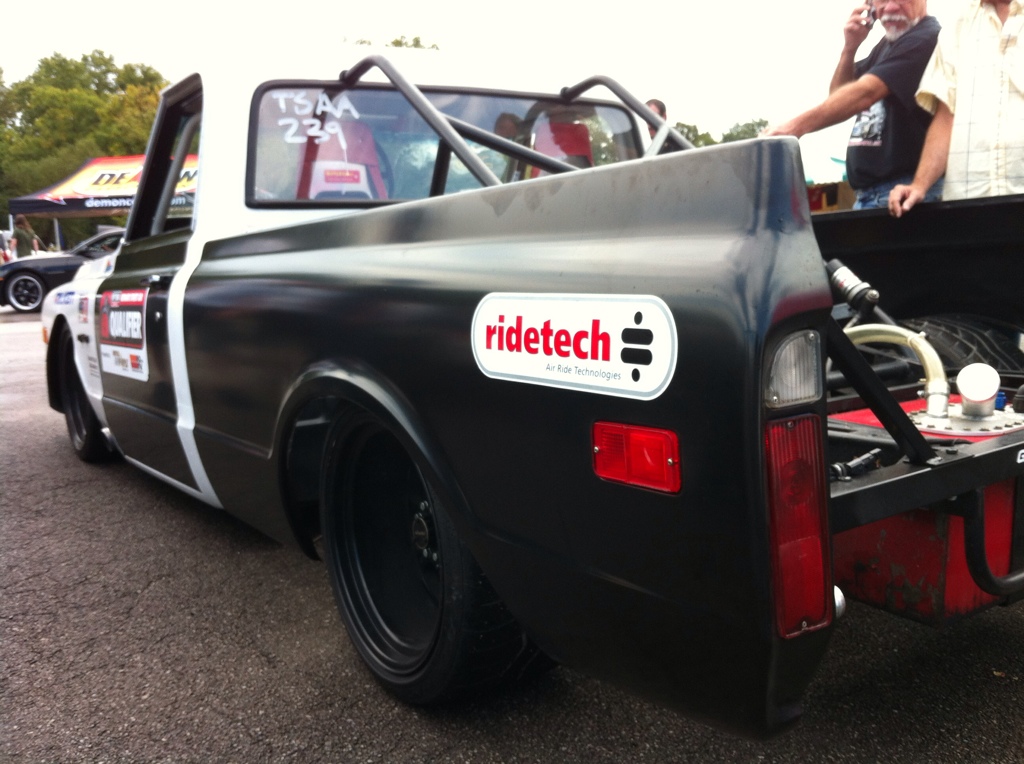

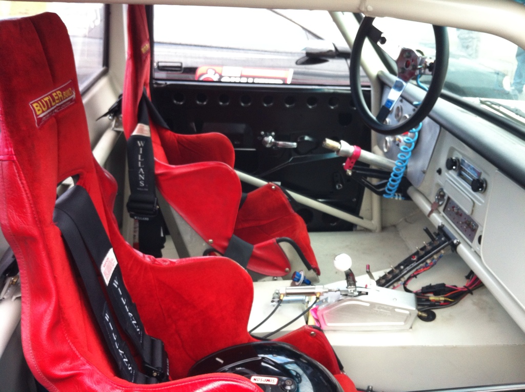

Figured I'd throw this C10 I saw at LS fest out here.. bitch was GNARLY

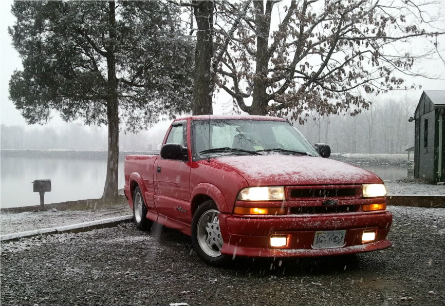

That truck is so badass!!!
Does my truck count?
I do wanna lower it another 1-2" and upgrade the suspension and brake stuff. Eventually do a 6.0 swap. Want to have wheels and tires for the curves and 1/4mi.

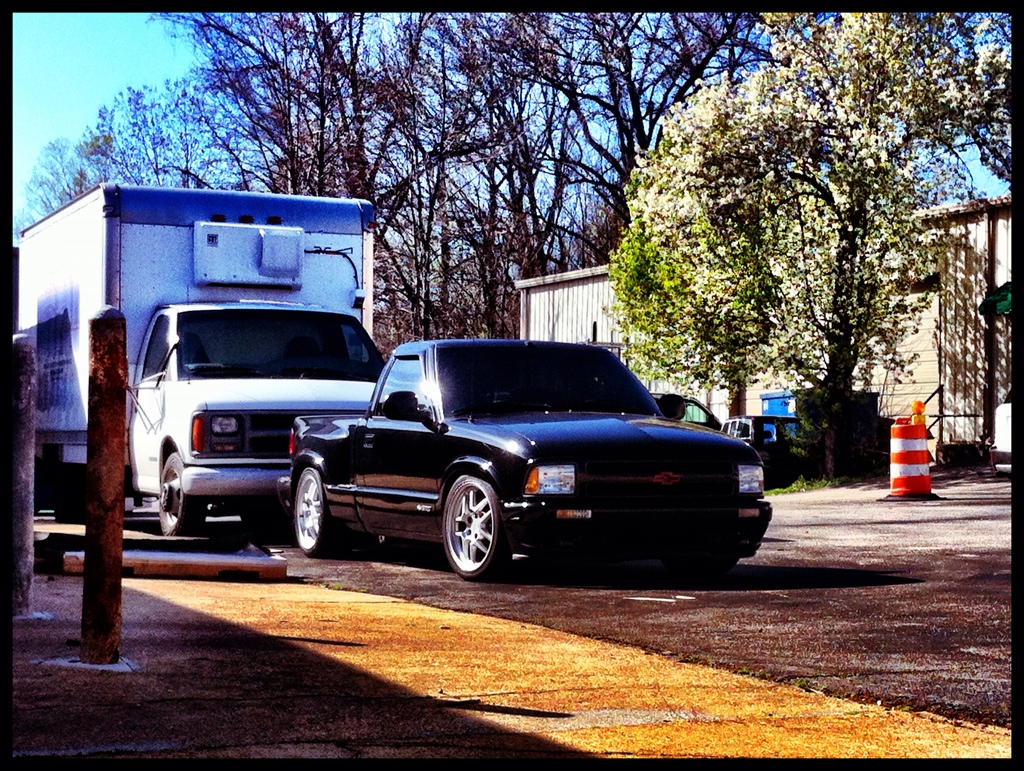

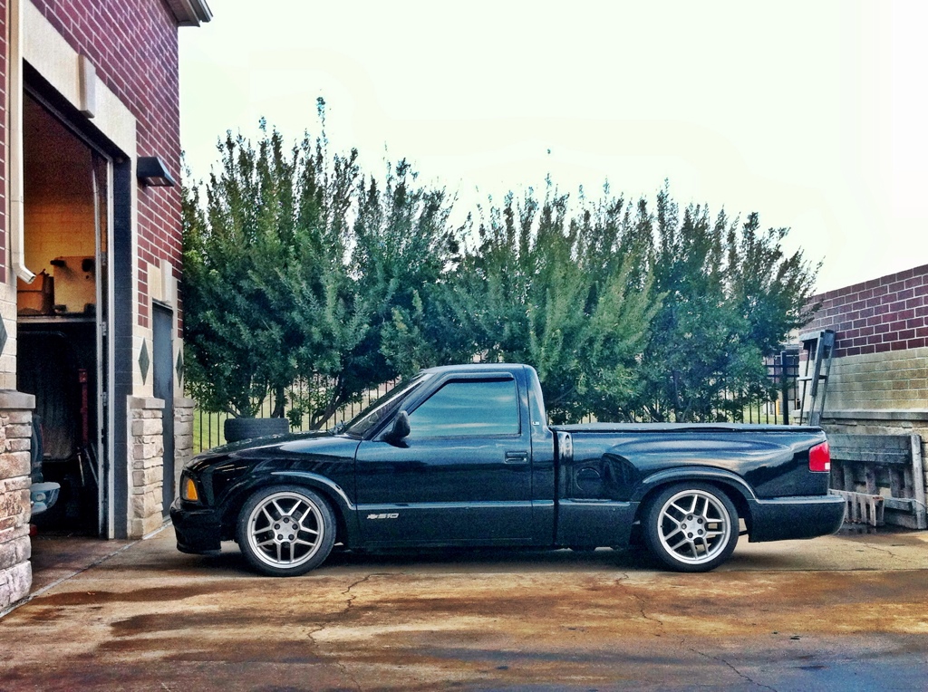

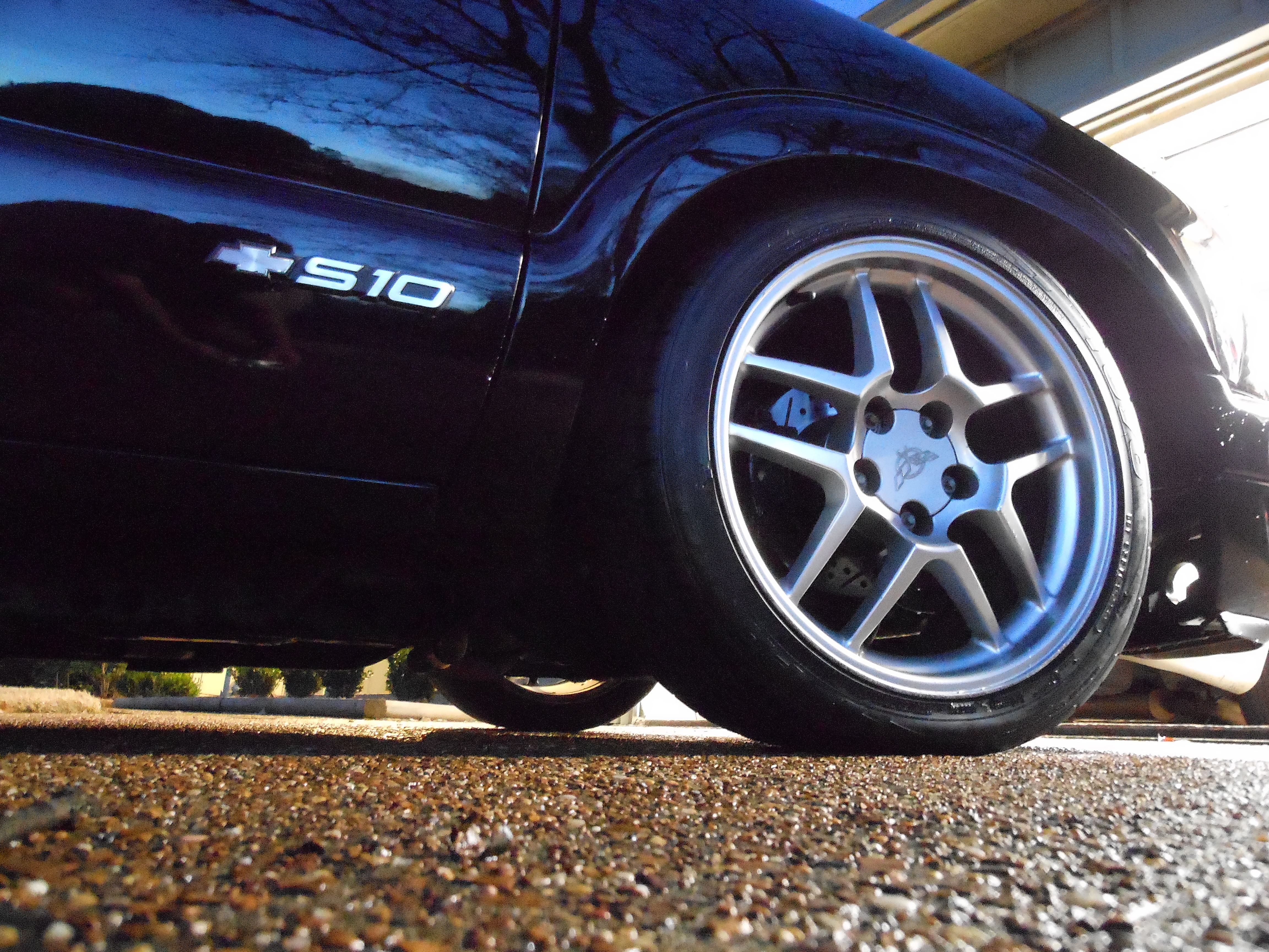

eh if thats the way youre going with it then sure lol

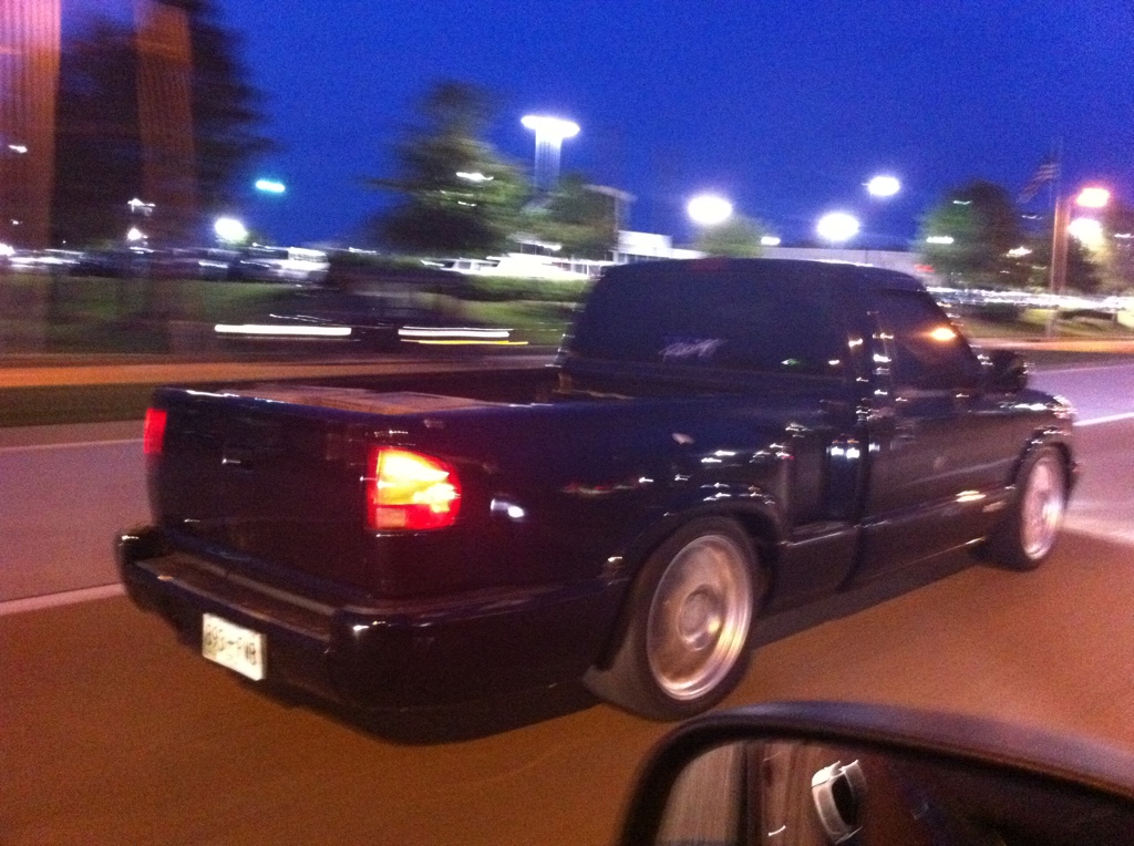

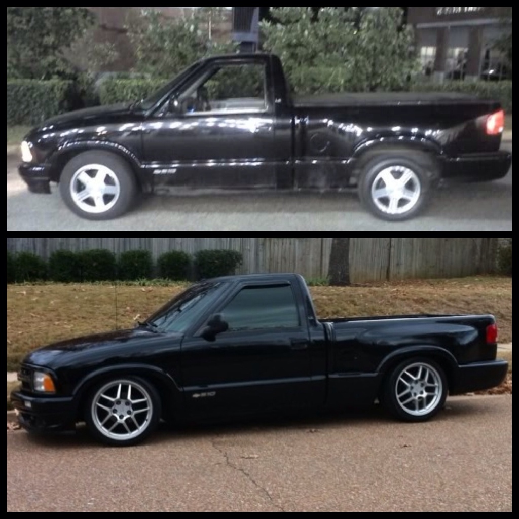

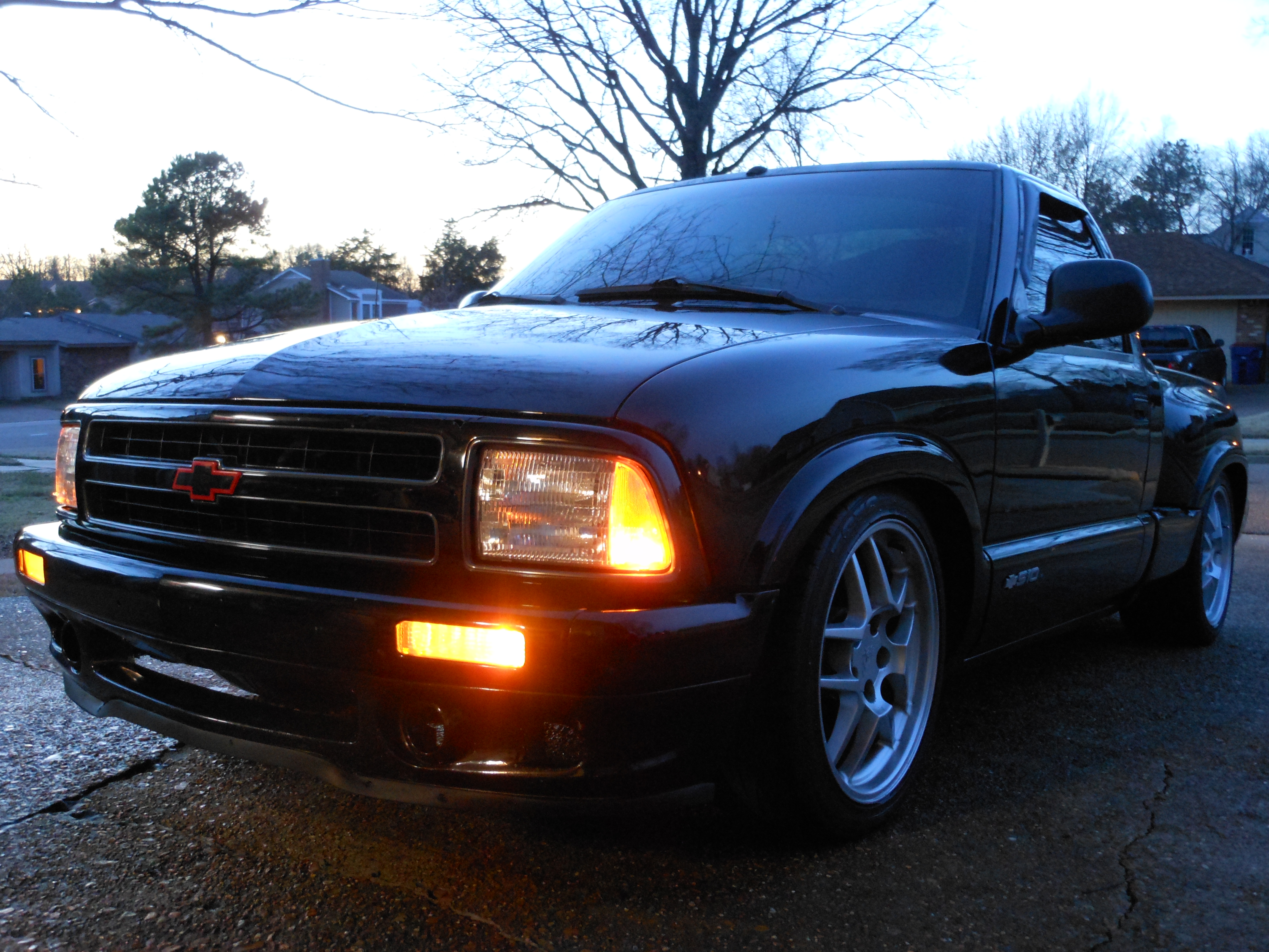

Heres my S10.. its slow as *****, but it handles well for a truck.. itll get a lsx/t56 someday, but once again, busy working on my other truck lol
Belltech springs, Belltech spindles
ZQ8 leafs and blocks
Belltech street performance shocks (up front only right now)
Front and rear sway bars, all urethane bushings
18x9.5 18x10.5 C5 Z06 wheels (2oem 2reps) (2in and 2.5in spacers)
2.2 5speed truck (slow)
oh and its for 215k miles on it lol
It set up for a couple years while I worked on my red colorado, and this is what it looked like when I started back on it and how it looks now

I've never seen anything like these rims. U don't really notice in the 1st pic how minimalist they are, til u look at the other pics I quoted, then go back & say, wow, kinda subtle. At 1st glance, I thought they were some Black & silver 3/4 ton 8 lug rims. I do see some high end shocks too.
I'm gonna come back to this thread tomorrow & check it out. This type of truck is what I'm after. Versatile. More on that later.

I also seen this at LS fest. Not too bad for a truck. It held its own forsure.

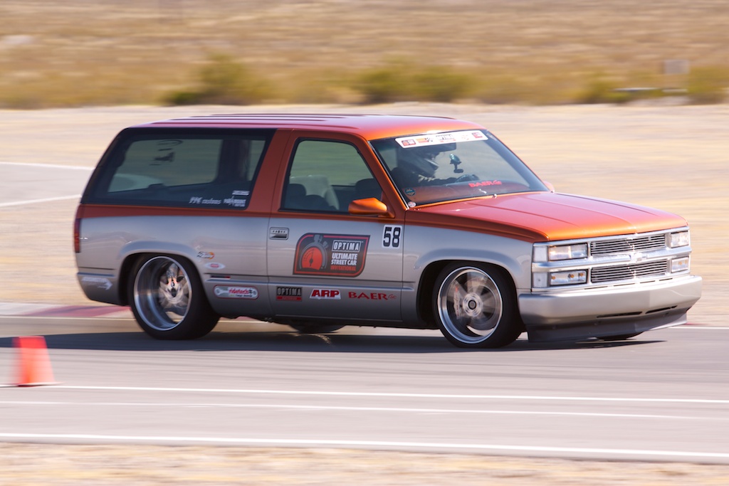

FINALLY ,This the thread I have been waiting for!

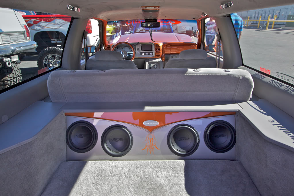

My Daily is a 1998 2 door 2 wheel drive Tahoe that we built to compete in auto cross and Optima style events. I purposly built it to look like its just a cruiser its even got a big stereo
Here's a basic run down of what been done

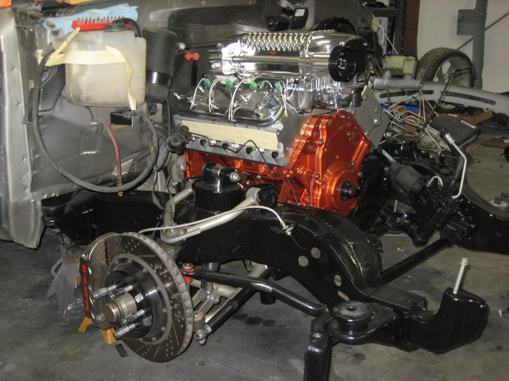

The front suspension has Ride Tech Triple adjustable coil overs the upper and lower control arms are Chopin Block but they are built for the coil overs .I also run Baer Traks to help coorect the bump steer, Bell tech built the 1 3/8 inch front sway bar and the brakes are Baer 15 inch rotors and 6S 6 piston calipers

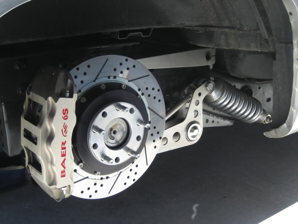

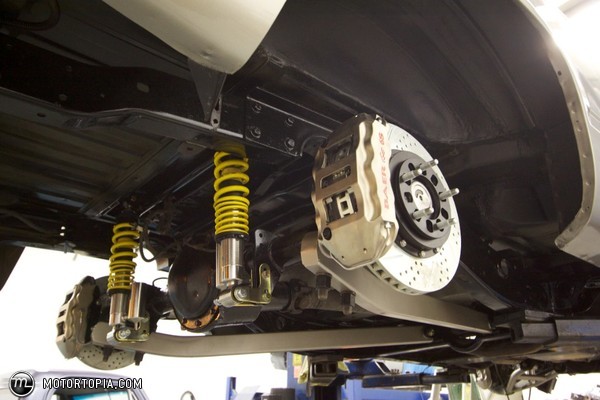

The rear suspension Has a cantelevered set of Ride Tech triple adjustable coil overs ,A custom built splinned rear sway bar ,Adjustable panhard bar and C10 truck arms built by Early Classics .Narrowed (6 inches) 10 bolt rear end with an eaton ,Torino flanges ,ford axles splinned to fit the carrier and ford bearings.The brakes are Baer 6S 6 piston calipers and 14 inch rotors The drive shaft is a custom built Aluminum shaft by Dynotech
Old coil over location but you can see the truck arms
New set up works great

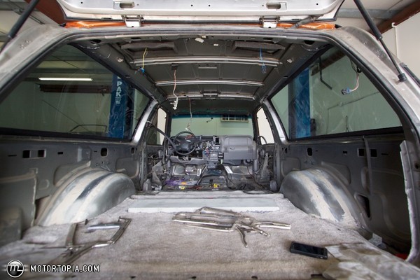

Mini Tubbed

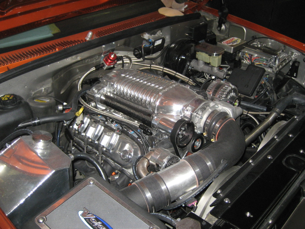

The motor is set back 1 1/2 inches to help with the weight distribution.
Its an LQ9 ,forged internals, ARP studs and bolts every where we could use them all the way down to the balancer bolt , Fluid Dampnr Balancer .West Coast Racing heads Stage 2 L92 heads ,manley valves. Custom Ground Comp Cam, Fully polished 2.9 liter Whipple Super Charger, Injector Dynamics ID 1000 flow matched injectors ,Noonan Racing Billet CnC'd valve covers and coil pack covers ,Maradyne E fans,

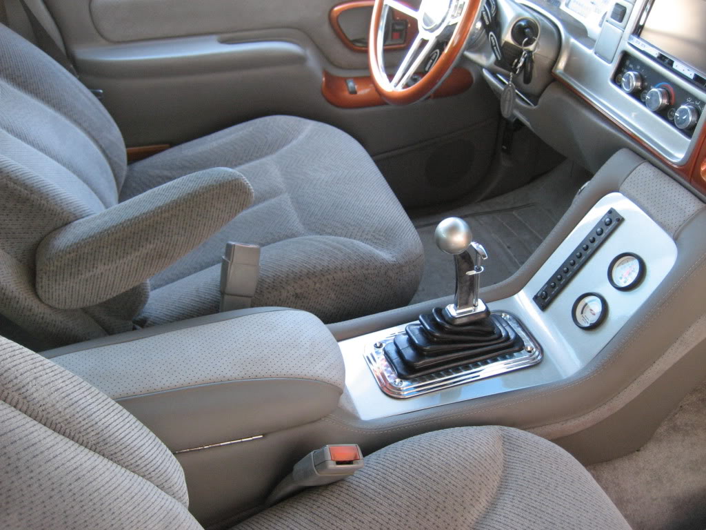

Trans is a built 4l80 with a 2600 stall Edge racing converter low stall so i keep some engine braking hd2 shift kit and a b&m floor shifter
The seats are now leather to match the center console and the seat belts are now Simpson platinum 6 point harnesses
