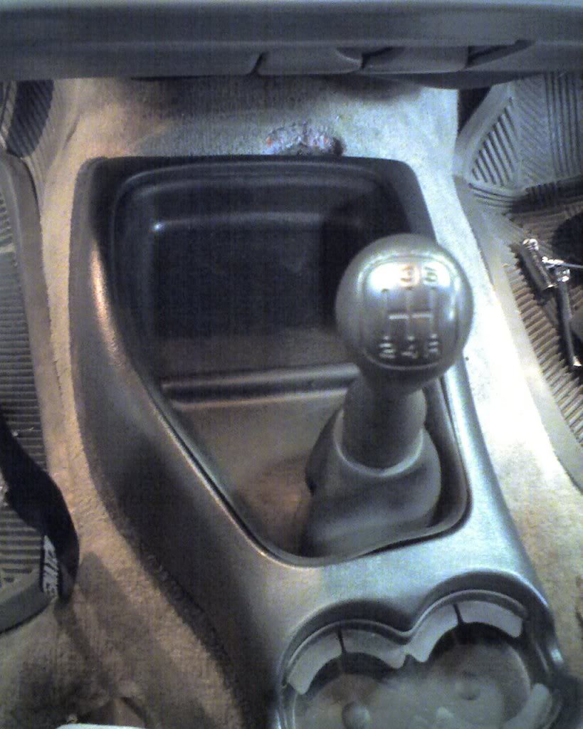

I am very jealous of the center console in that tahoe man. I have the floor mount shifter as well. I need to make something like that instead of the ugly plastic base it comes with. Great work man!

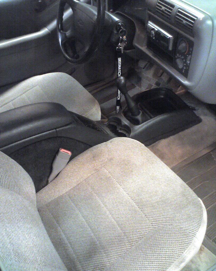

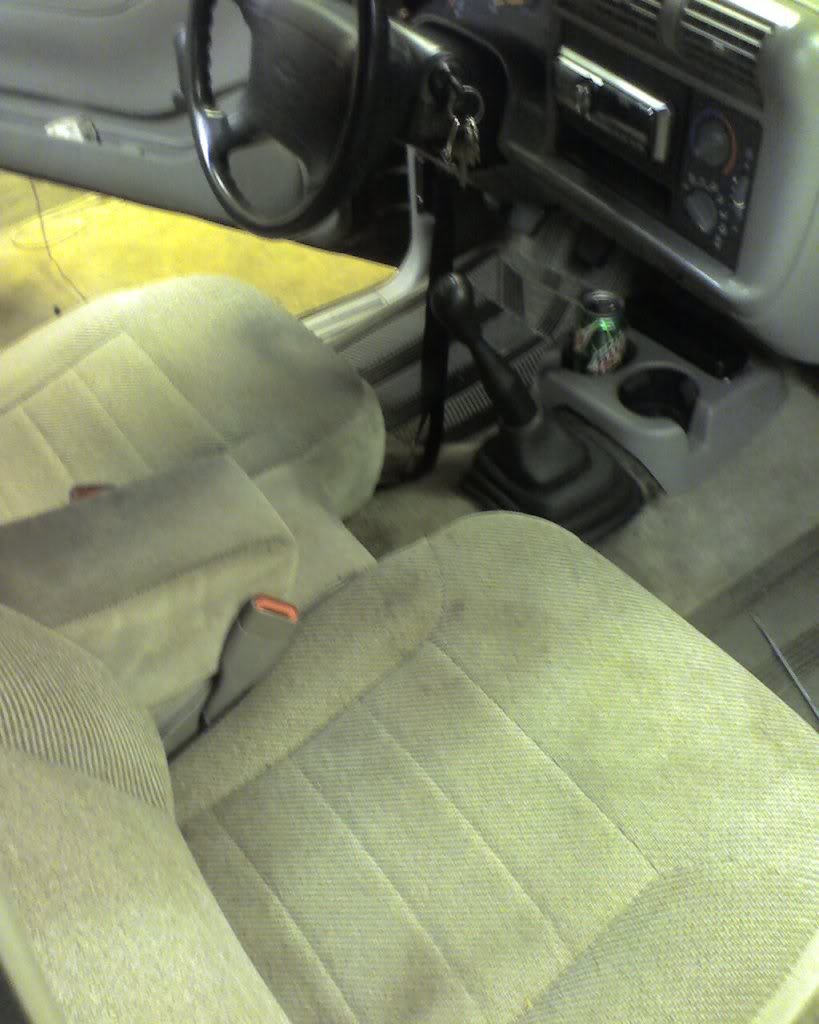

Can always adapt something from another truck..
I used an Automatic console in mine and cut it, moved it to fit and look factory with my 5speed (S10)
