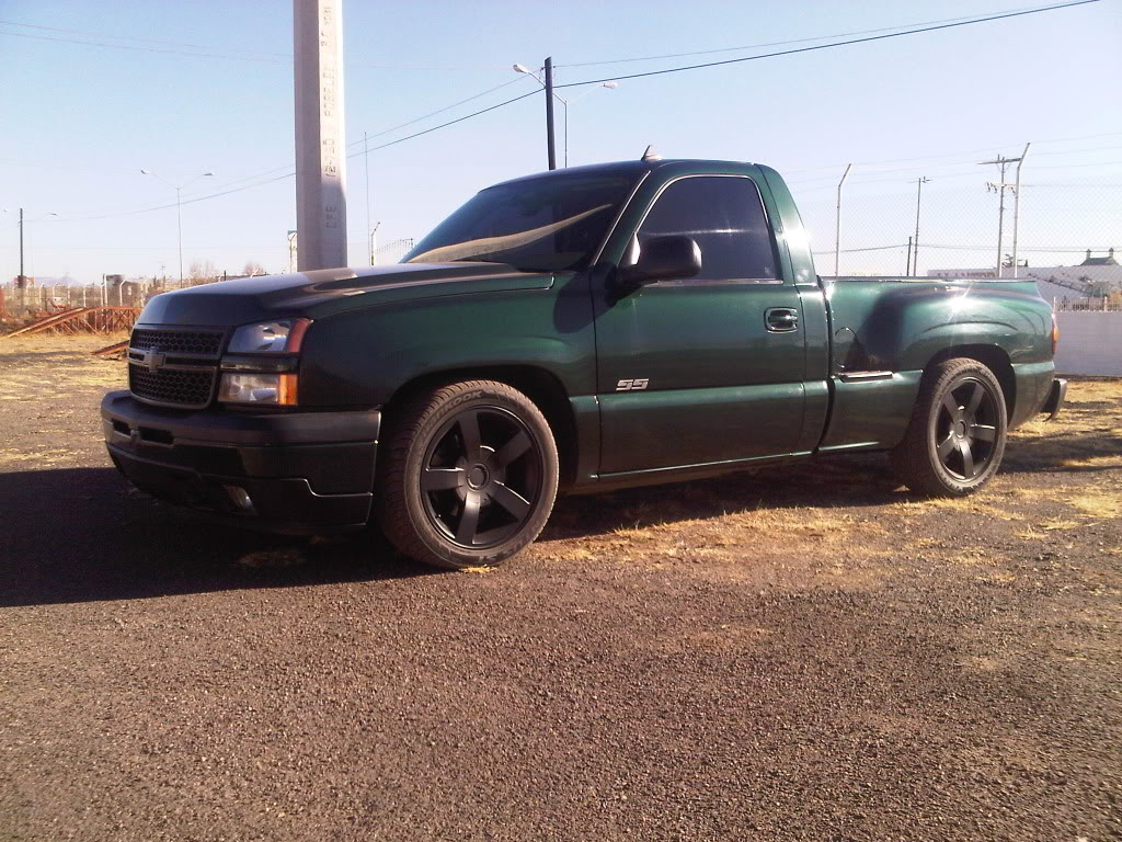

Since i change the converter for a 4c my truck is pretty much useless with my hankook tires, i bought another truck so my 2005 single cab is only used on weekends and at the track from time to time, i wana keep my ss wheels so im looking for 20 inch competition tires, as of right now im looking at the nittos 275/40/20 NT555R, i thought mickey Thompson would have something for me with the ET Street Radial but seems like the only 20´s they have are P305/35R20
does anyone else have any other experiences or ideas with some good street and track setup?

There is no "street/strip" setup for a 4000 stall.
Anything that helps on the street but still can be driven in rain will not be enought for the track. The BFG drag Radial T/A is going to help and would your best bet, but when you get to the track they are very hit or miss. I have talked to 10-15 guys at the track and most of them said they wouldn't buy them again, atleast not for track use.

I'm pretty fond of my Pirelli Pzeros on my 2010 Camaro SS. Good hookup, great handling.

i bought 275/40/20 nittos 555r, i´ll update in a couple of days how they work on the street
