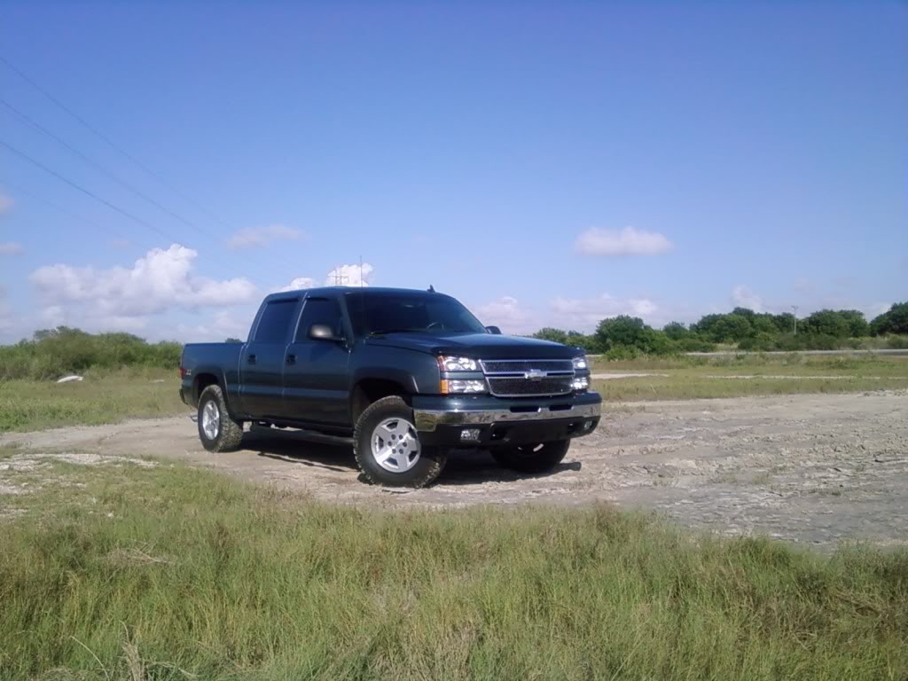

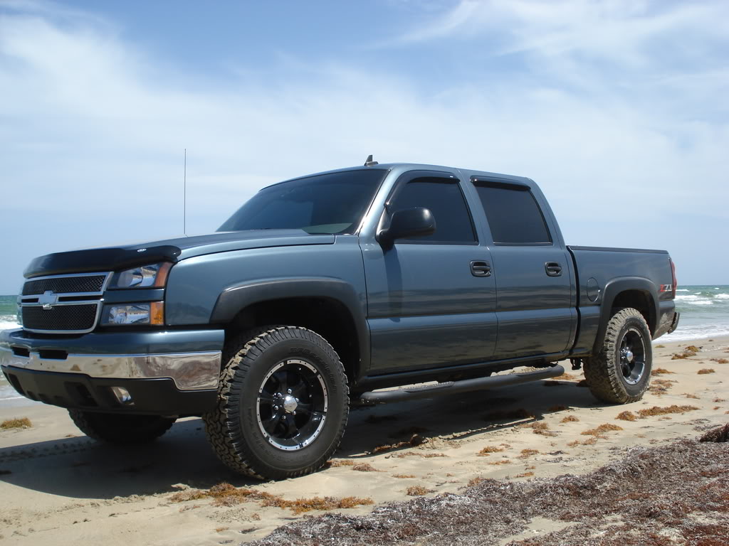

There is no "spacer" to put up front..If your only going to run a 33 then just do the keys in the front and an add a leaf in the back..A long leaf will ride better but a short will have more load capacity and will ride rougher..
Putting a 4-6" lift kit on and only running 33's would kind of be a waste since you'll be lowering the front suspension ...
Here is a pic of my truck when i had a 33's on it.Ive only got keys up front ..
