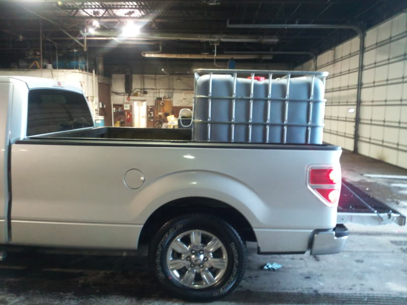

I have my Tahoe bagged with firstone 2500 bags and it rides great and hauls anything you can possibly put on the hitch. I have pulled 5-6 ton on a two axle trailer. I have posted the pics a few times.
Here is a brand new 2012 eco boost wih air lift helper bag systems.
That is a 2500 lbs. tote in the bed. We haul tires all the time and the guy who drives the truck doesn't have a complaint about them.
If you tow or haul anything more then a few hundred pounds in your truck you are a fool to not install air bags. It keeps your alignment correct and safe.

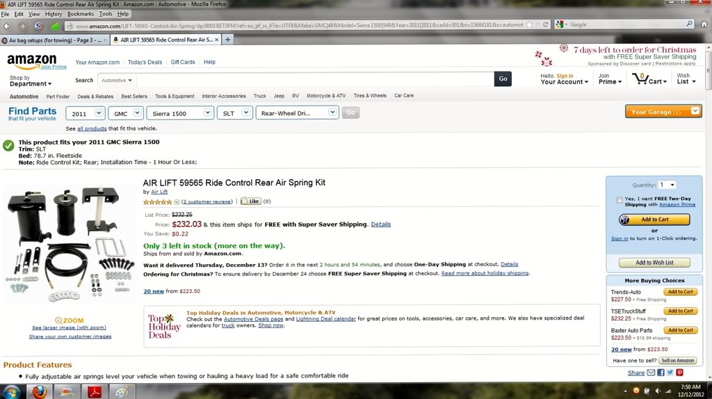

Got them installed tonight...
Thanks for your valuable tech in this thread. Mine are on their way…and I just saved $0.22!
