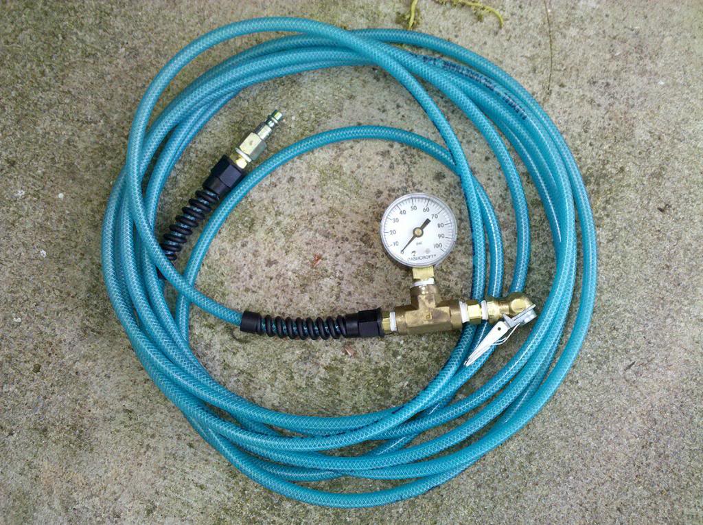

I wanted to show the tire fill hose I keep under the back seat. I have a quick connect by the reviver and as said a 3-way valve to isolate the flow for the task I want to do. The tire chuck will clip on and when not on the tire schrader valve it is open. I had a choice there for open or closed and I guess the compressor would cut off @ 10 psi but.....
I can stand by the tire and watch the gauge or sit in the truck and monitor the PSI there. Weather and/or Hot Female in distress mandated.
When filling the dash gauge needle will show and vibrate much higher. When you stop the compressor it shows the actual.
Position 1. Normal regulated minimum PSI and dash control to he bags. No flow to the 2 or 3 positions.
Position 2. Lock the air in the bags. (Never use it but its available if say there is a slow leak between the bags valve and the pump). No flow to the 1 & 3 positions.
Position 3. From the compressor to the rear hose quick connect and operated by the dash control. No flow to the 1 & 2 positions.
Edit: Since this picture was taken I have added a check valve before the gauge so when I stop the flow I get the tire's PIS only.
