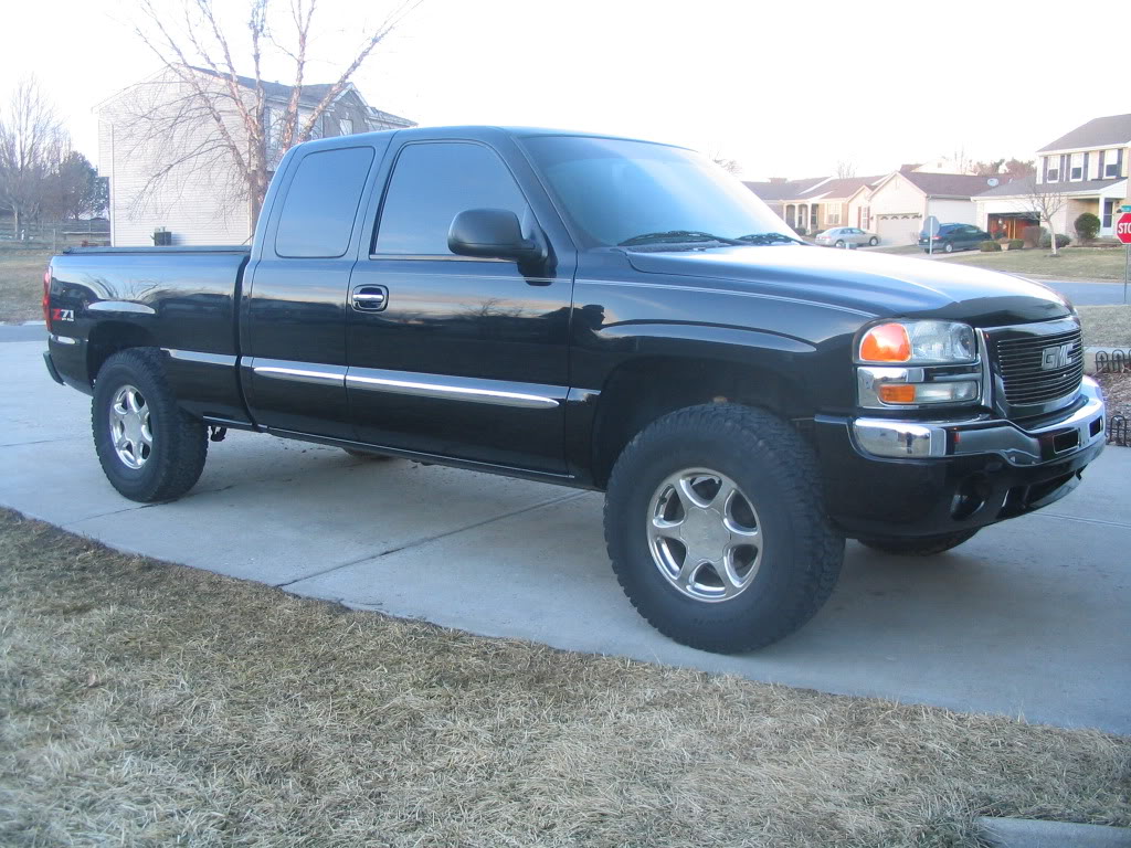

Here's my NBS Z71. I have new keys in front, with edelbrock shocks that are made as a stock replacement as well as for "leveled" in front trucks. Tires are a 315/70/17 (OEM Hummer takeoffs) BFG's which arent a true 35, they are about a 34.5 overall diameter. No rubbing, no trimming. I'm cranked just a smidge more then level. Truck rides awesome. My friend utilized his HP Tuners software and took care of the tire size etc and some other things to aide against the size of the tires btw as well.

Thanks for the info. Truck looks good. I'll look for those shocks. I will need some here soon.
