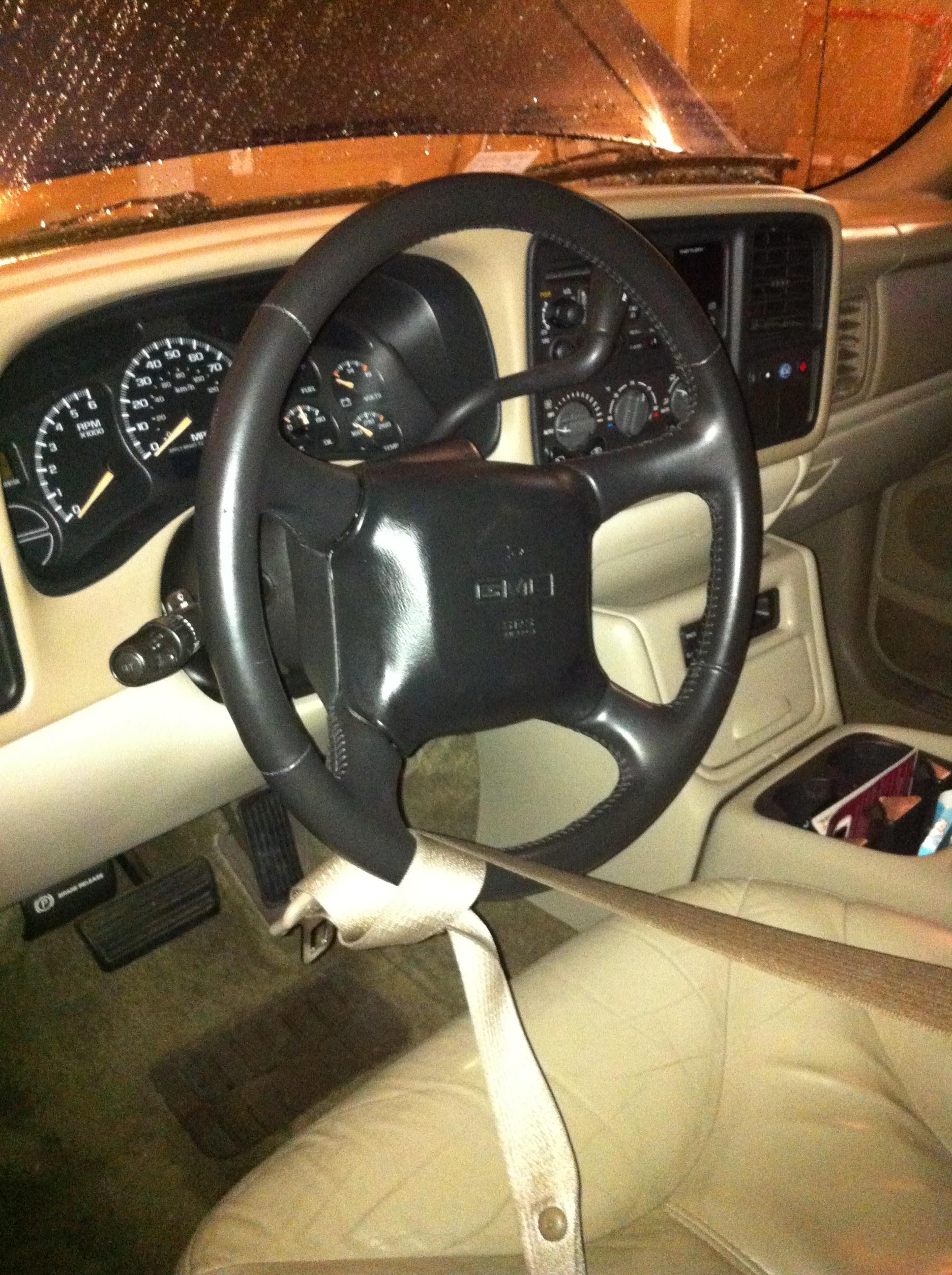

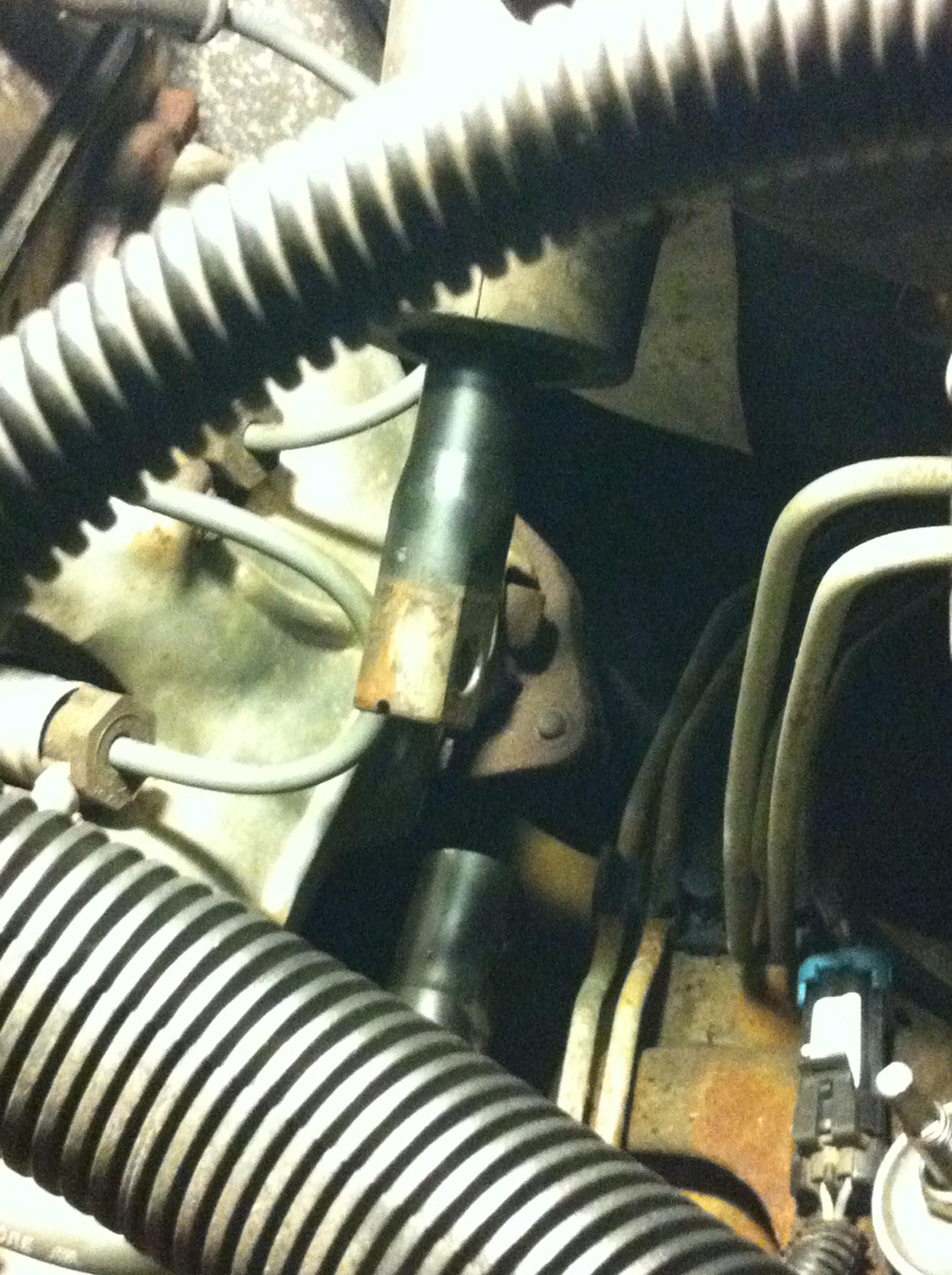

I think hes talking about the common steering shaft clunk/rattle in our models. I fixed mine with some thick royal purple lube.
I'm not sure you have the same issue?
Tied down wheel.
Squirted up a ton of lube in the steering shaft here.

Yeah that's it, but the problem was on the other end. If you reach up under the dash and grab the intermediate steering shaft right as it comes out of the green or white plastic bearing and shake it, you'll be able to hear the rattle if that's what's causing it. I just swapped out the shaft and bearing for new ones. Although after taking it apart and seeing where the rattle comes from, I would have saved my money on the shaft and just replaced the bearing.
