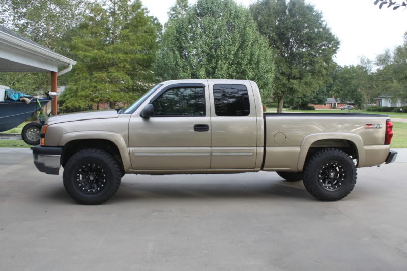

You will have to crank a bit. It depends on what wheels and backspacing/offset etc. Are they oem wheels? When I ran oem's(17" Z71 8 lugs) I only had to crank and trim a little, but when I got my aftermarket wheels which are a 4.5 BS/ -12mm offset I rubbed pretty good and had to crank more. I will attach a pic of 295/70/17's on my truck for you to see. They look GREAT but the truck rides kinda rough when you crank em unless you get Cognito upper control arms which will give you 2 more inches of travel. Then you can clear em easy. I also have Keys as well, which are VERY cheap.

here ya go ..I only could find one pic on the oem wheels when I had em. They fit very nicely, minimal trimming and cranking.

another with new wheels etc

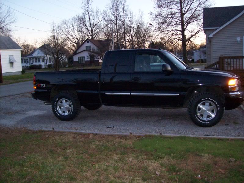

You should be fine. Here's mine on 285/70's with the stock keys cranked up a little.

Old Feb 26, 2011 | 02:03 PM
