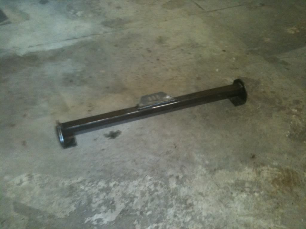

the simplest possible way to do it imo

Need to make some tubular ones for the 80e swap.. You could make a killing
Old Dec 4, 2012 | 09:20 PM
RedRover's Avatar
Joined: Sep 2012
Posts: 91
From: Longview, TX
hmmm, thats a good idea, how much would you pay for such a crossmember? i would need to know bolt patterns, frame widths, and mounting height of the tranny in realation to the cross member. i have the means to make em, just need the specs.
