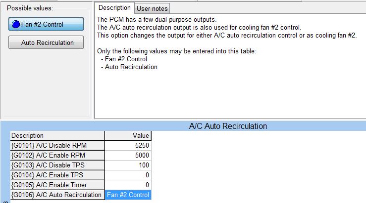

Pin 42 - empty - Fan 1 Control - This will be empty on 99-2002 harnesses. A pin can be added for electric fan control. Programming will enable the fan control. PCM supplies a GROUND to turn on a relay. If you have two fans, keep reading, pin for fan 2 will be on the RED connector C2. You must wire your fans through a relay.
Pin 33 - Dk Green - Fan 2 Control - some 99-02 harnesses will have a pin here, this was used for the HVAC Recirculation Door control. The PCM would control the A/C recirculation to help cool the a/c system if it got too hot. In an engine swap, programming can be changed to let this control a second cooling fan. Again, PCM supplies a GROUND to run on a relay. You must wire your fans through a relay.

I have a 2001 suburban. Wired everything up using pin 33 and pin 42 and had fans enabled.
Has anyone had issues where their fans come on as soon as the truck starts? The fans come on low speed and never trigger over to high with A/C on. But using tech2, I can trigger the relays without issues and get low speed, single high speed and both on high speed depending on what combination of the 3 relays I trigger.
i also have the A/C compressor that has the high pressure switch on the back and below are the settings from my tuner.

It may be on due to ac pressure.
And it seems odd that he has the fan enable setting at 30 mph. Wouldn't that keep the fan from coming on until 30 mph?
If you want it to hit the high speed fan rev to about 2500 while parked with the ac on, it should build the pressure up closer to 300 if your freon is full and then kick the high speed on.
