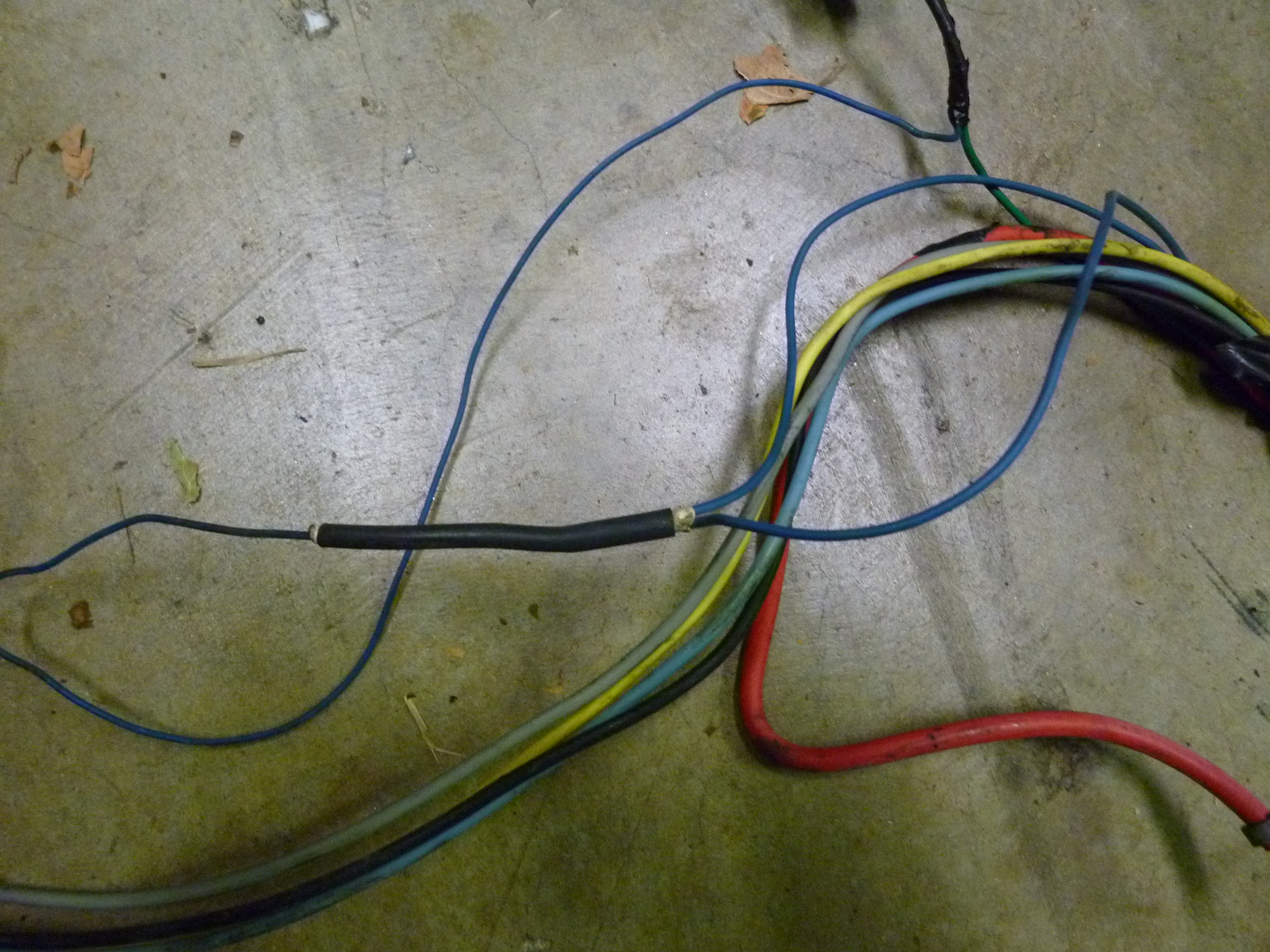

I know this is an old thread, but I am doing this conversion. I have the fans in, and I have the factory relay block, with about 10" of the harness, and I have the fan side of the harness with the plugs. I need to build the rest, which is not a problem.
The question I have, is about the above pic. What are the two twin small blue wires for? where do they go?

They connect up the loom to become one of your signal wires (blue) that goes into the PCM.

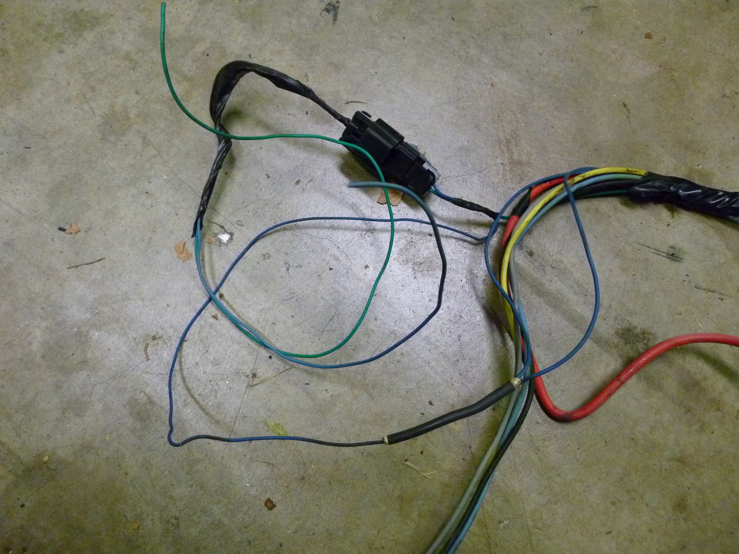

I do have another question I think not asked here.. On 99-02 if you run a relay from the compressor signal wire like the OP did will the fans ever turn off while the compressor is engaged?
Seems the factory 05-06 settings have the fans turn off at 45mph.

I have a problem when I connect the green cable. Electric Fun going on when I turn on the compressor the fan go off when I turn it off la compressor the fans go on
Old Dec 20, 2016 | 01:37 AM
  #97
Pelon1978's Avatar
Registered User
Joined: Dec 2016
Posts: 4
IDE connector exactly how is he in the picture but when I do connect the another green cable they work
