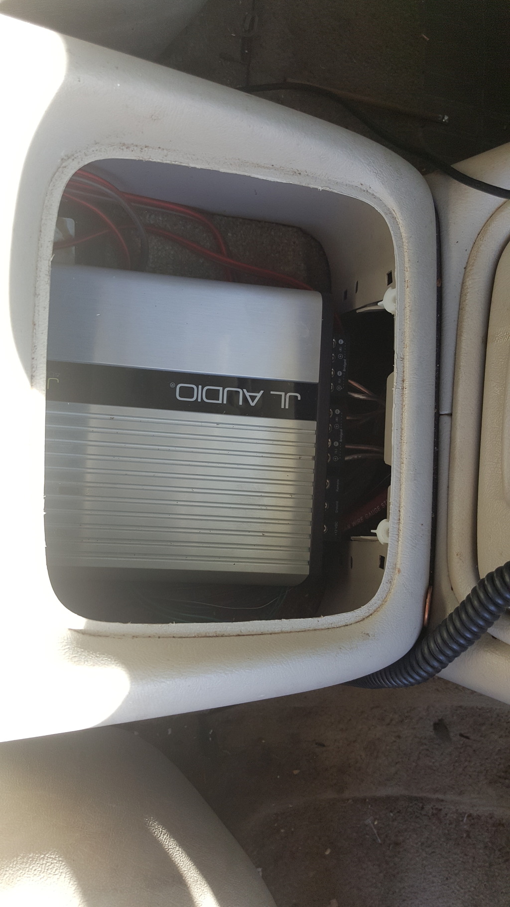

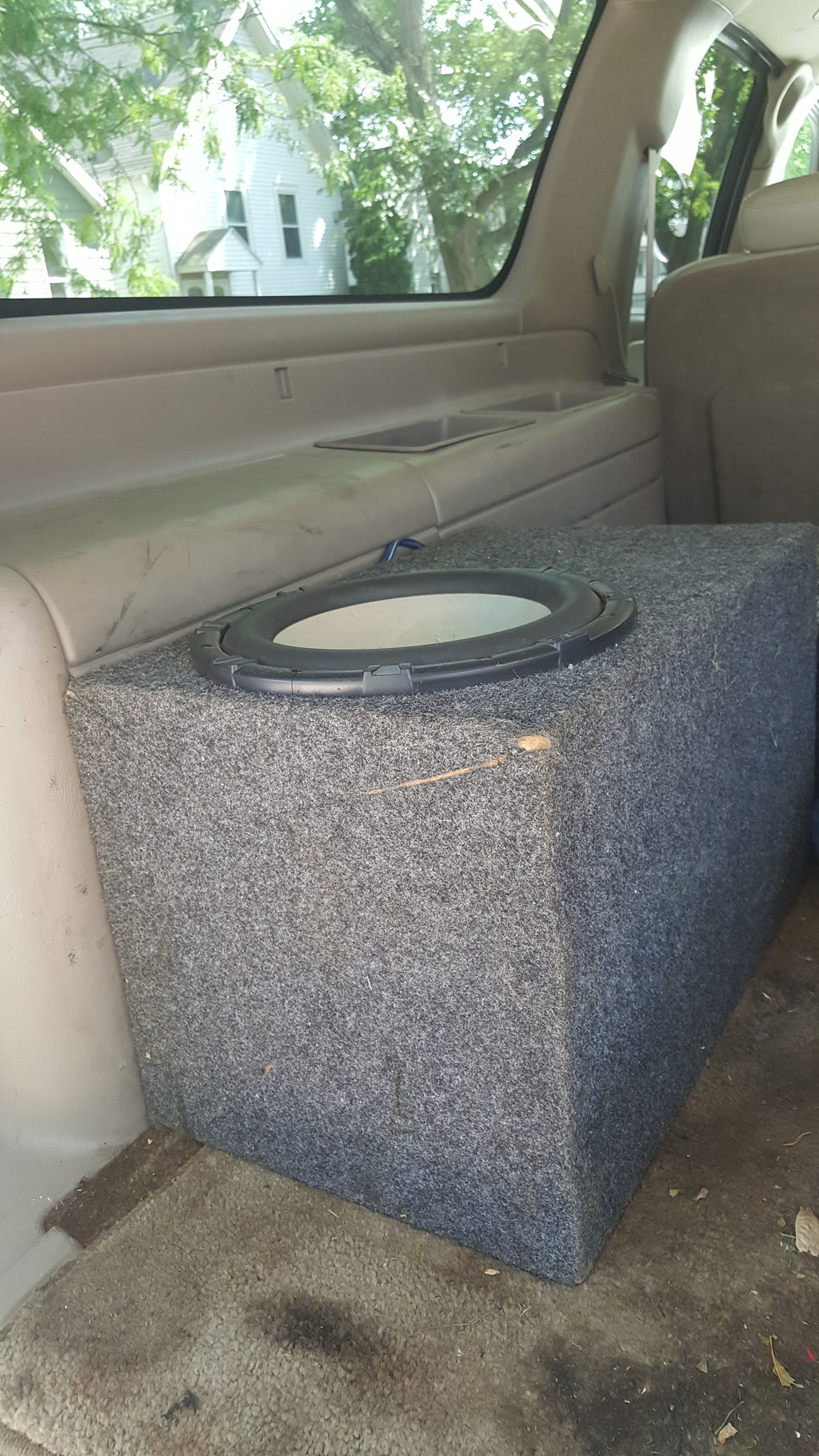

I had the 10" Directed that pounds hard for a little guy so i bought a JL JX1000/1D their mid grade amp and put it under in the area that the factory sub went. I also bough their JX400/4D to help out with the highs that were replaced with a decent set of 6 1/2s. I was told by a few people that Alpine pre-out as good as it gets so I went with a unit that doesn't play CDs.
The next step is going to be upgrade the bass. I really wanted to go with a slash amp but kinda dumb to have a 600/1 running a little 10" and not have the budget to upgrade the highs. I will probably end up with a 600/1 and either an alpine type R 15" or may spring for a W-7 13.5". I prefer my system to be louder in your car sitting next to me, then your own system but again being an adult budget sometimes has to compromise ultimate goals.
