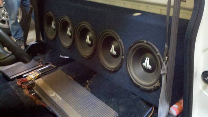

Silverick's Avatar
Joined: Sep 2011
Posts: 66
From: San Francisco/Bay Area
Originally Posted by 454navyss
im planning on stepping up to a 145amp charging system as well so that shouldnt be a problem. any recommendation on wires, terminals, etc? (gold plated at a minimum im sure because of its conductivity)
I am running this system with the standard alternator.
Attached Thumbnails considering sub install-lola-subs-system-complete-before-.jpg   considering sub install-lola-subs-lanzar-amp-jvc-amp-pioneer-amp-before-.jpg   considering sub install-lola-polk-audio-amp-capacitor-fuse-block-lanzar-amp.jpg
Thats not saying much! Its based on the peak capable amp draw of the amplifiers that madates going high output for the alternator. Grated, the factory alternator output is rated and the demands in stock form, so in theory, any added electroics would mandate an aftermarket alt. But on a low demand stereo, voltage drop would be minimal making it not quite a nessecity to upgrade. But again, any aftermarket external amplification will benifit in an HO alt. in the form of decreased voltage drop, which is the number 1 killer of amps.
