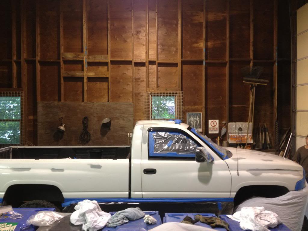

Kept it on there about 8 months, through a winter too, so it encountered all weather conditions.
I used the kit from dipyourcar. com with the electric spray gun. Took 3 gallons of dip, woulda been easier to peel if I had used 4 gallons. Spraying was pretty easy., peeling was a bitch although it did come off in large sheets.
One thing I learned was the spray in the same direction the whole time, don't switch from horizontal to vertical strokes. Also learned that you want to take the tape off immediately after painting. If you try to remove it after drying it will peel the dip away with it. The stuff is surprisingly strong too, I regularly used a pressure washer on it.
Here's it taped off

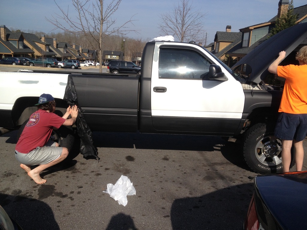

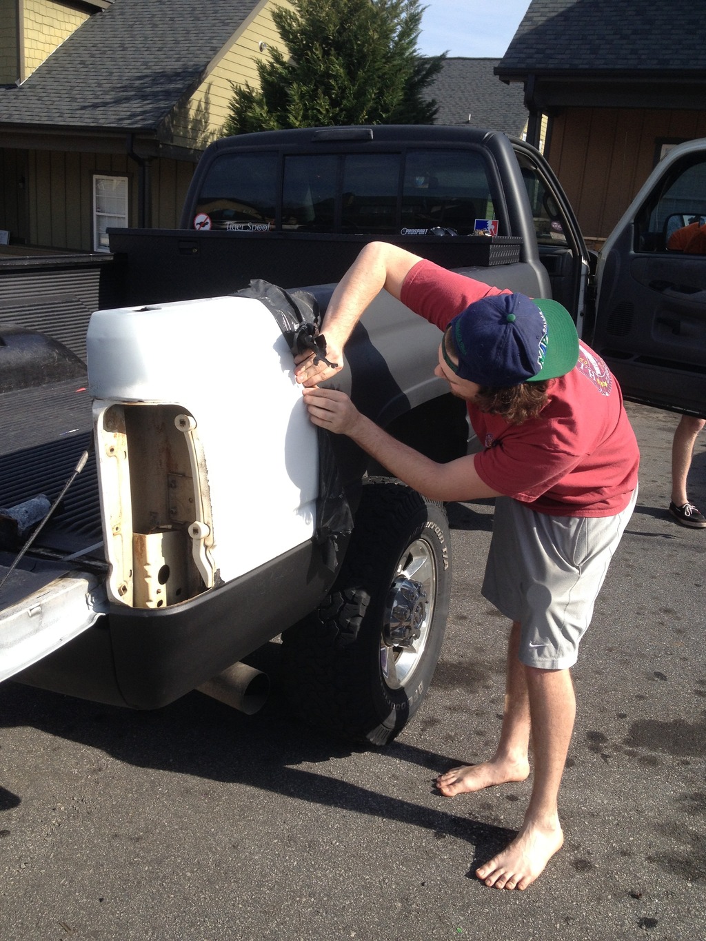

and here are my roommates doing the bitch work while I take pics.
