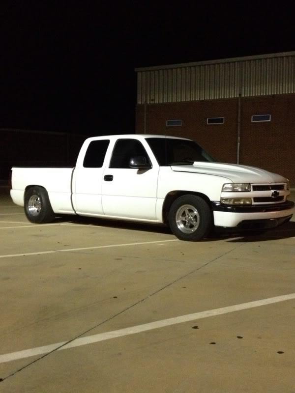

5 lug summit warriors up from and 5 lug summit stars on the back
How did you convert from 6 lugs to 5? Wheel specs please and backspace
