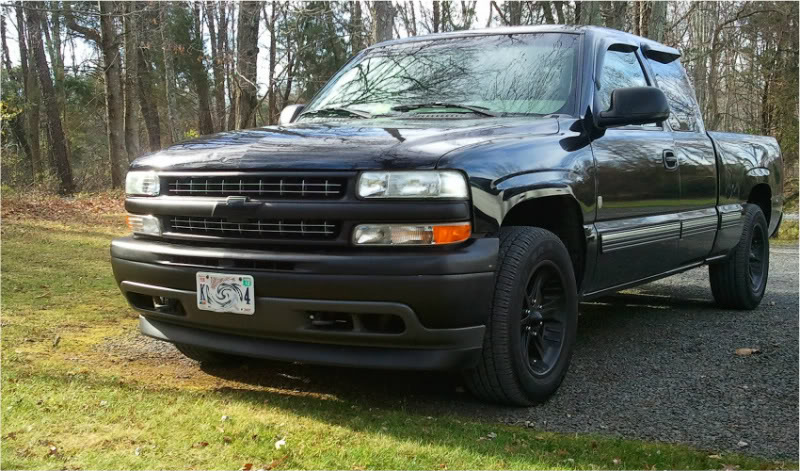

Here's my track/winter wheels tires
Just some junk 18" American Racing wheels that came with the truck and 265/60 Goodyear SR-As. These have proved to be almost .1-.2 quicker in the 1/8 over my 20s.

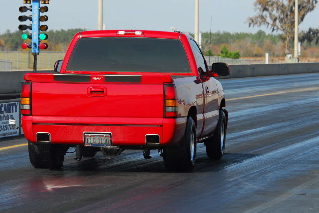

Front is Bolted Bogart D10's, 15x5 with Moroso 28x4.5's
Rear is 15x11, with Hoosier QTP 29x11.5's

truck looks absolutly glorious man!
what brake set up are u running in the rear to get those 15" bogarts to fit? whats the backspace on the wheels? what gear ratio?

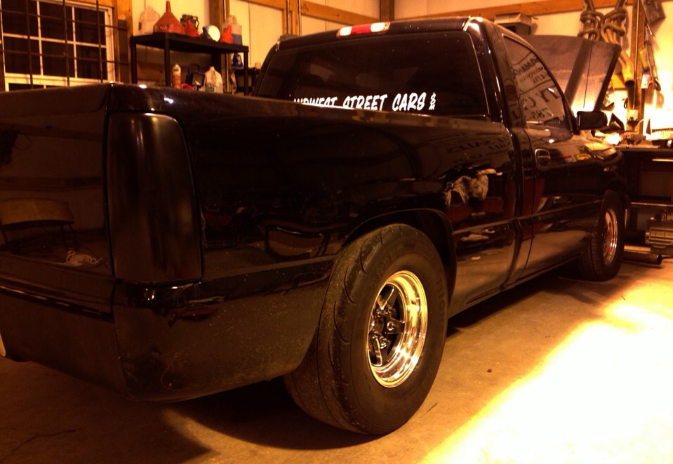

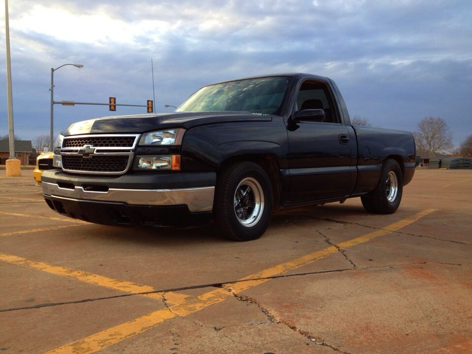

New setup. Welded and redrilled factory hubs and rotors and axels and drums for 5x4.75 bolt pattern.
Weld RT-S 15x4 with 205/75-15 and 15x10 with 315/60-15 drag radials
