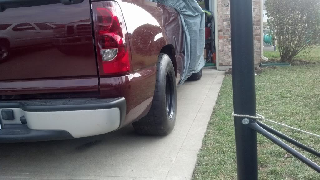

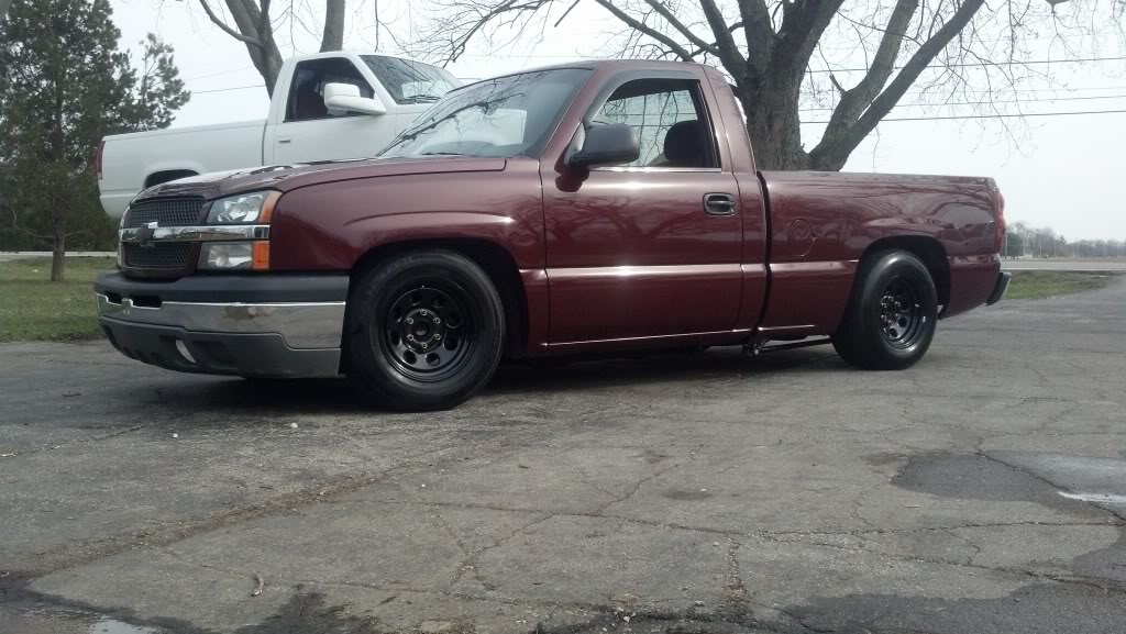

Wheels are cragar soft 8's 15x10 in back 16x7 up front. Tire is a 275/60/15 out back.

Also, these wheels will be up for sale soon. Have Bogarts coming, about 3 weeks out.

Back space specs please and did you grind the calipers? You got lowering spindles ?i read that if you put spindles a 17" and larger wheels will fit only

Backspace is right around 7in. I have drums in rear. And you are correct about the spindles. I went with a 4inch lower control arm just due to that reason. I can still run a 16 up front

Looks great. Black wheels look nice with that color.
