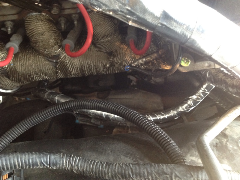

Anyways, it's alive! But, I have some kind of erratic tapping noise from the passenger head area that definitely was not there prior to the install. The interesting thing is the noise goes completely away when I rev the engine. Could it be the downpipe hitting against the crossover pipe near the log? I don't know. If it was something internal I'd expect it to still be noisy or even worse with increased rpms. I'll sleep on it and think further. I'll probably have to pull the passenger valve cover to inspect. Oil pressure is perfect, no SES light.
http://www.youtube.com/watch?v=nII6SMrlg8E
Also, Oil drain was replaced per silver-mod-o's recommendation and was also completely wrapped in Cool Tape. I feel much better having done that.
