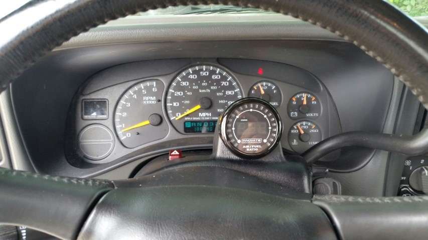

No huge developments.. I got my AF gauge mounted but no reason to wire it up yet. This surround is actually kind of nice.

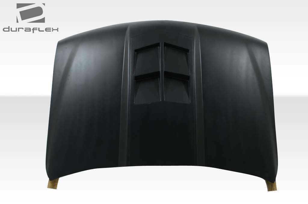

I also decided to splurge on a hood.

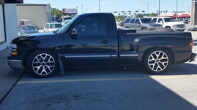

Got the wheels and tires on today. No more rub! Thats a relief.

Ok so the hood was a bust. They sent me the wrong hood. Looked like it was for a ford super duty. I did get my money back after I sent them proof the hood was destroyed. The quality was horrible. I would not recommend a duraflex hood. Yesterday I did manage to get the front diff swapped out to the 4:10 unit. So at least I am 4wd again. Also replaced the fog lamps that the kid broke when I let her drive it.

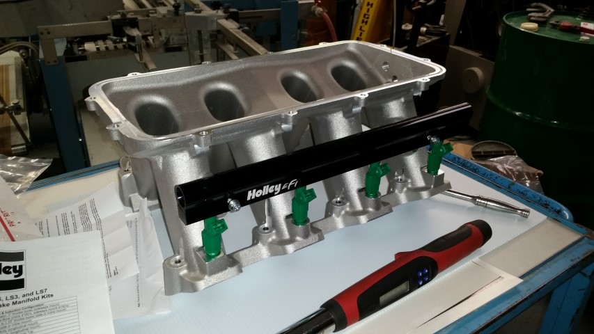

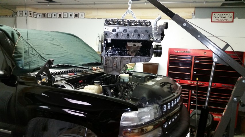

UPDATE...
I am heavily medicated typing this so try to keep up.
Been busy trying to buy the family business. Doing a crap ton of work on the building and trying to get it all official by the first. Progress has been slow but at least there is progress!
Keep in mind I am working alone and with only one good arm.
The new motor is in!
Working on getting the headers installed...Almost forgot to weld in the bung for the wideband.
Bought a ORY to get me thru break in. Plan on a full 3in duals with spintechs and a cross over. Might wait till winter is over.
Bought a 240 amp alternator but not sure I will get it fit with the connector on the fuel rail. Any advice here would be great!
I think I have all the fittings to mount the FPR but havent decided on if I want to bracket it off the intake or firewall mount it.
Went with an LS6 valley pan and have a catch can on the way. My parts list is getting shorter and shorter.
More pics to come!
