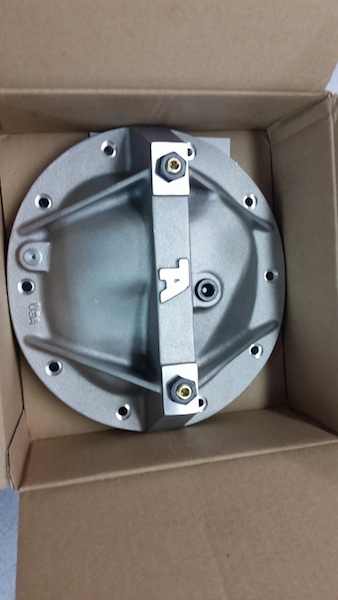

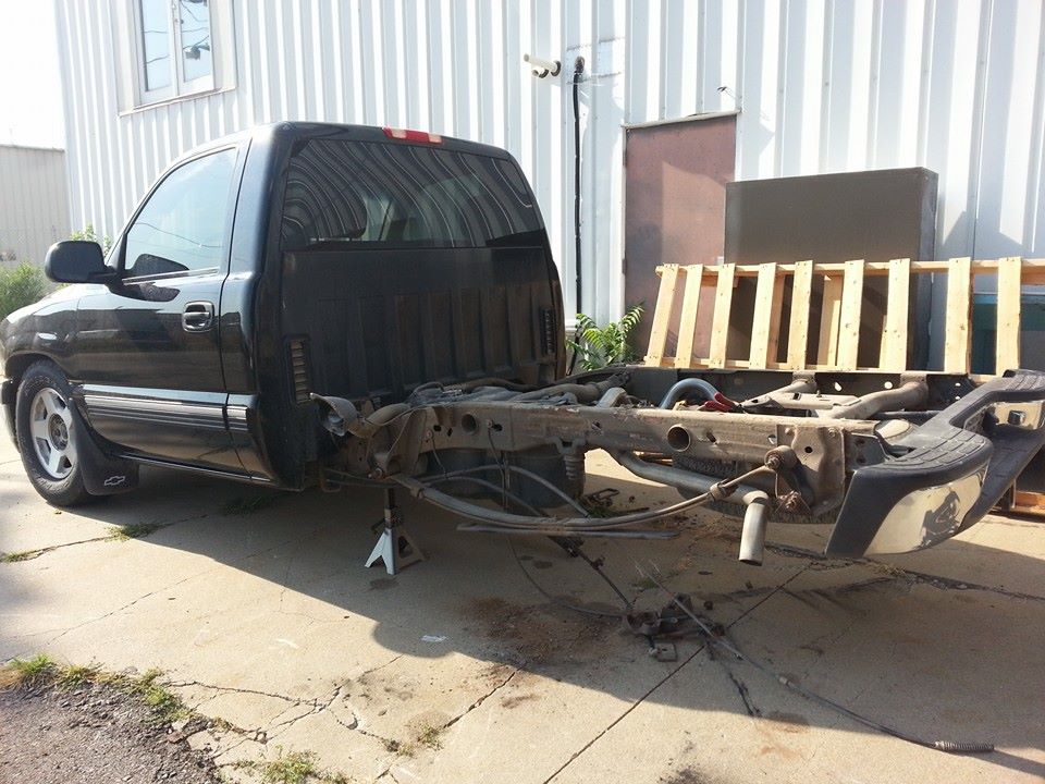

Today's project was removing the rear axle. It's getting dropped off for some 4:11 gears and a new posi unit. In the mean while I'm waiting for the belltech C-notch that they make for this dimpled frame to show up. Also noticed the parking brakes were hosed and the backing plates are rotten. So those are on the list as well.
Debating if I should get an aluminum cover with the bearing supports. Not making big power yet but you never know!

Beef it up while your there.

The rear end. Make it as strong as you can while you're working on it. No reason not to buy a cover with bearing supports.

Will order it with the stud kit tomorrow. Thanks for the advice.

Yea, I was talking about the rear. Get it done while its apart. Best thing really.

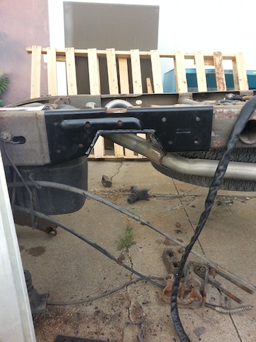

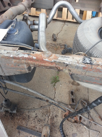

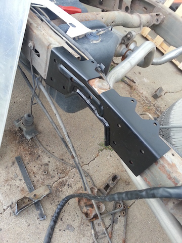

After that the wife was still working in her office so I tore open the Belltech C Notch instructions and took a look. For the price you pay for this stuff they could at least send a decent template. A thin piece of paper is kind of a pain. I took it and copied it onto card stock and cut it out. Much better to work with.

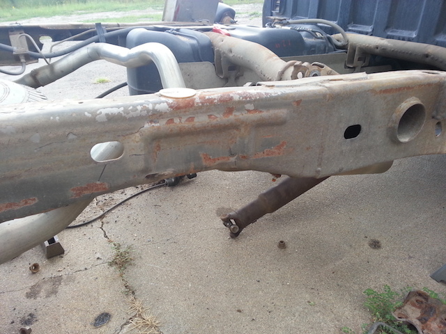

Grabbed a passenger side pic of the "dimpled" frame. I guess it's a one year thing. The Belltech spindles fit awesome. I guess they should for $300.
The plan was to just mark it out and pick up grinder wheels to cut it tomorrow. But I couldn't resist cutting it with the plasma cutter. With a straight piece of bar stock and a clamp it was really easy to cut. Took a fraction of the time a cutoff wheel or Sawzall would have taken.
