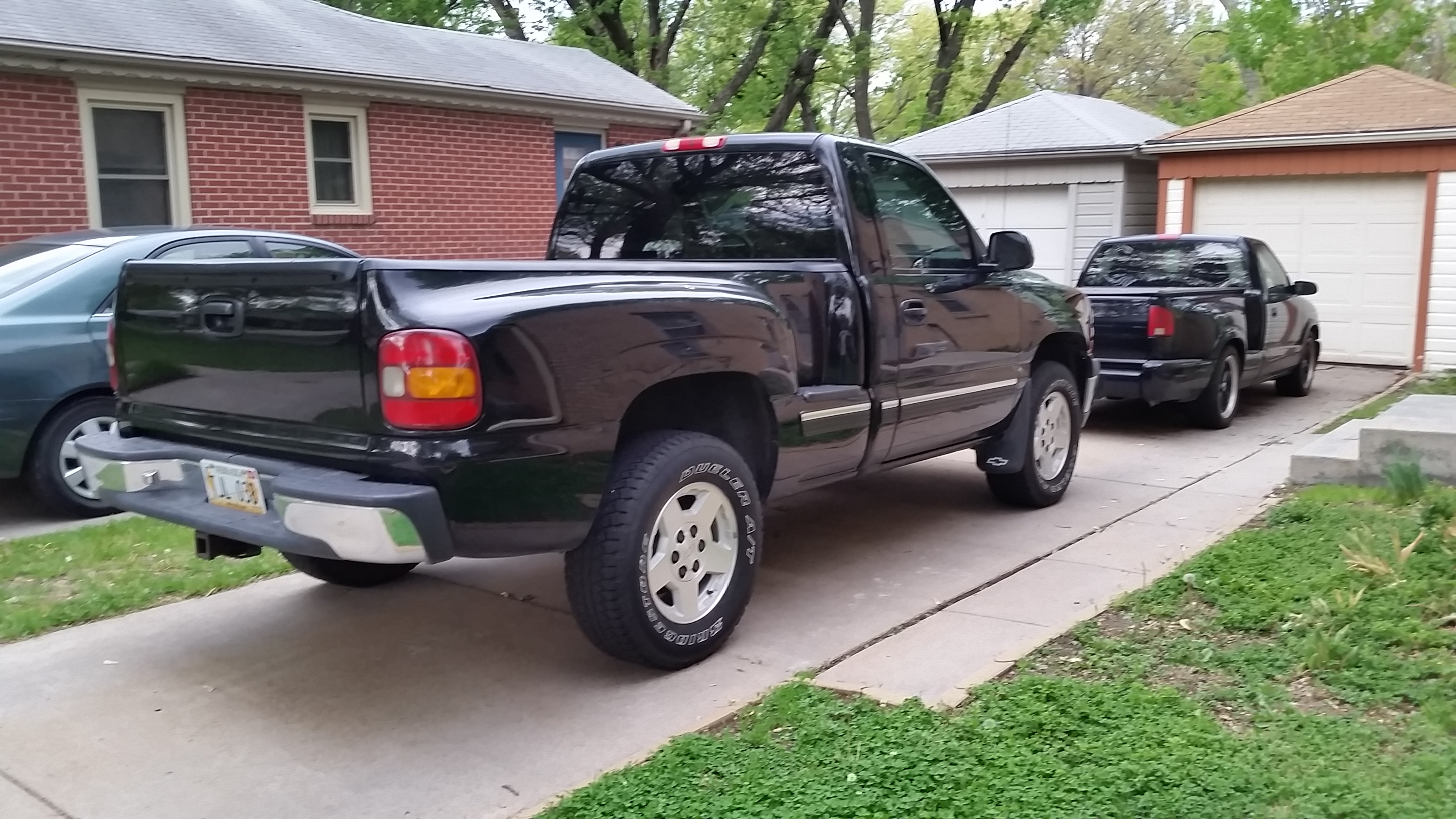

So the project is a 2000 rcsb stepside Silverado Z71. Wasn't looking for a 4x4 but a friend had it and it was cleaner than anything else I could find local.
Goal is a fun daily that I can drive anywhere. Has to be damn reliable. Bed has to useful. Needs to be comfy for long road trips. Low is better for me to get stuff in and out of the back.
I really like the performance of the S10 and the look and stance are just about perfect. I'm not a toothpick and my neck doesn't bend too well so the Silverado is a better choice.
I know....Lets make the big truck look like the little truck!

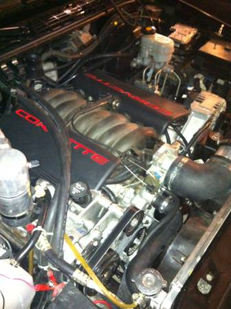

The plan calls for a 6.0 to drop in. Haven't purchased that yet. Debating on a crate motor. Leaning ATK or Blueprint engine. Not sure if I want to run the stock intake or invest in something fancy. The 17yo troublemaker in the S10 pic starts college next month and she is driving the wife's wheels. So this project can't start for real until then.
I would love to have 500 rwhp when done. But that just isn't going to happen in round one of this build. So later after the wife see's that it's not fast enough for her we will do some changing.

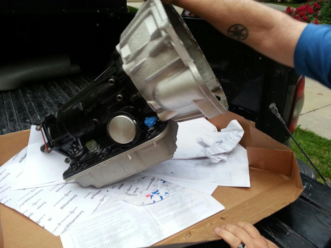

This truck is currently my daily. Last week I noticed some odd slow speed shifting. Decided maybe it was better to get the trans swapped out before it breaks. The trans that I pull out is going straight in to be rebuilt for a spare.
I have HP tuners. Hopefully I can muddle thru enough info to get the programming done for the 3200 stall.
If anyone has a good thread or insight/experience here I could use some advice.

Transmission is done... Pecked my way thru hptuners trying to adjust for trans. Need to find an email tune but trying to hold off til the motor is done.
If anyone has a recommendation let me know. HPtuners friendly please since that's what I own.

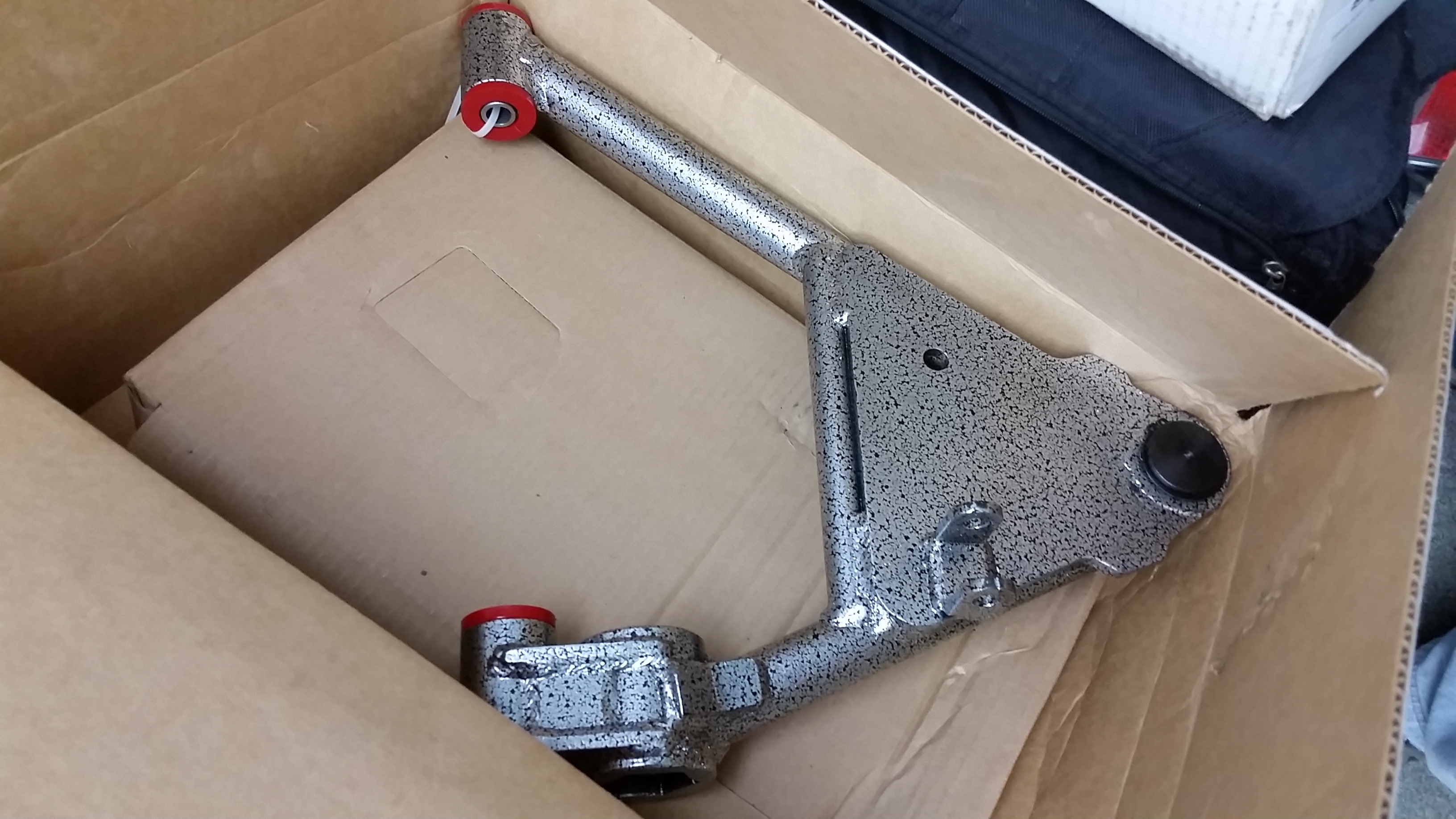

Was in the doctors office on Friday talking about doing a left shoulder joint replacement...so Saturday seemed like a good day to tear into doing this DJM lowering stuff. I got the passenger side all done although I'm not sure I will need the upper arms when its said and done. Was feeling really brave and decided to tackle the drivers side. Got the new arm ready to put on and damn if they didn't send me two passenger side arms. CRAP.
So I will get to test their customer service on Monday.
I ended up doing the lower control arms and drop keys. Hoping to end up at about 4 inches or so up front but will go lower if I have to. These replacement arms seem pretty beefy but disappointing that the uppers don't have provisions for the brake line tab and abs wires. Hate using zip ties for this.
So right now the truck is sitting 3.5 inches lower on the passenger side with new wheel bearing and latter model bigger brakes. I had to put the drivers side back together so I can move it in and out.
If I can move my left arm tomorrow I will go ahead and do the rear flip kit.

Well the guy at DJM was nice enough. Called on Monday and had a control arm on Friday. So the front is done more or less. Need to go back over all the bolts and just double check things. So I ended up doing the bearing assemblies, bigger brake rotors and calipers from an 05 truck, upper and lower DJM arms and a set of drop keys. I didn't think it was that low till I drove it 20 feet. No since in doing any adjustment till I get the rear done.

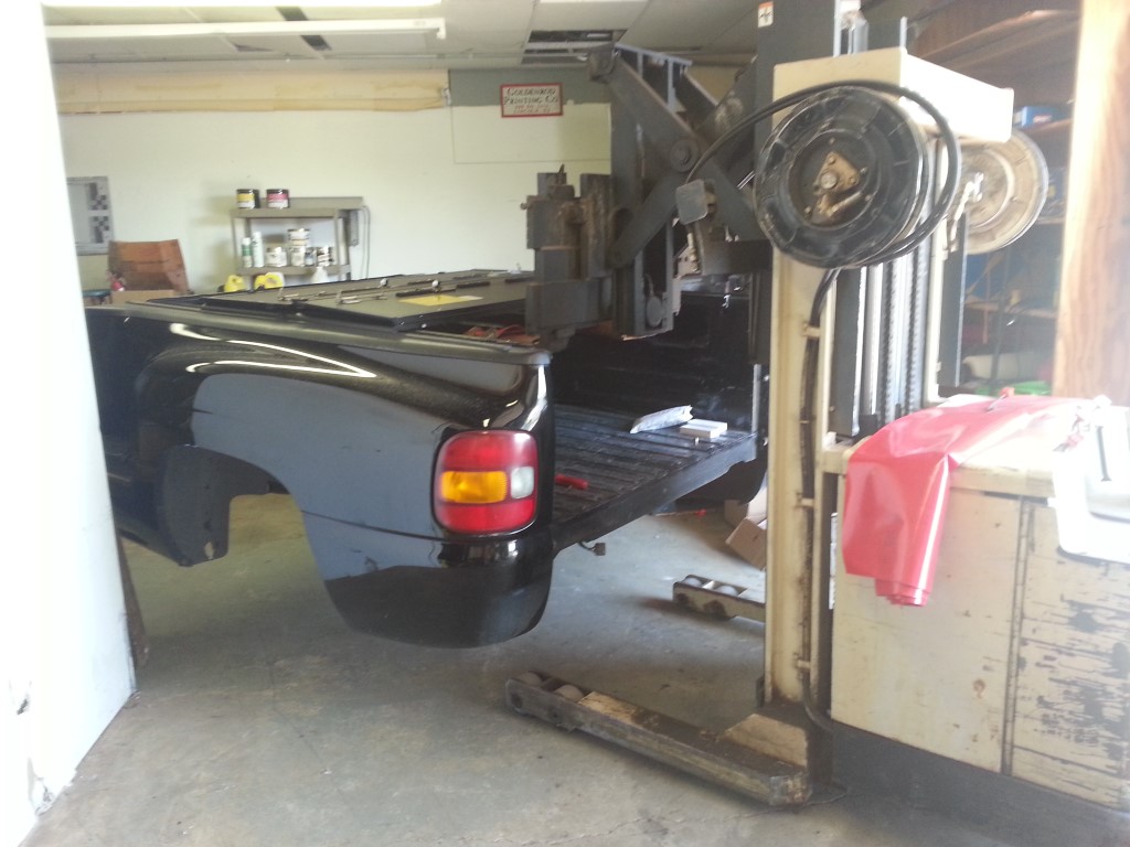

I'm doing a new fuel pump and hotwire harness from racetronics and no way was I trying to do the flip and notch with the bed on. So I decided to yank it off. Got to the lat bed bolt and the captured nut spun. Plasma cutter made short work of that bolt.
So off comes the bed!
Started looking at the frame and the notch kit and it just didn't look right. The frame has ridges stamped in it. The c notch isn't going to sit flush on the frame. Started digging around and found out the 99-00 frame was different and the only one who makes a c notch for it seems to be belltech. $379 for just the notch kit! Not like I have any real choice at this point. Found it for $280 online and ordered it.
