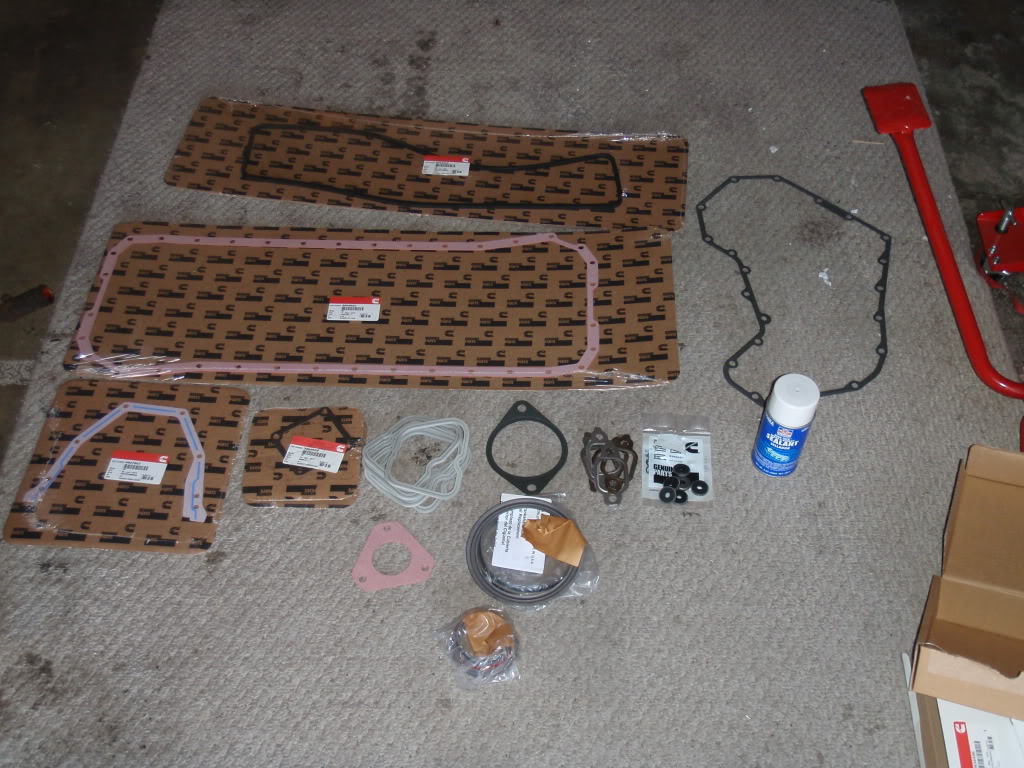

Literally this little bit plus 6 cans of Cummins beige paint cost me $402Name:  P1010003-2.jpg
And i thought LS series gaskets were expensive...

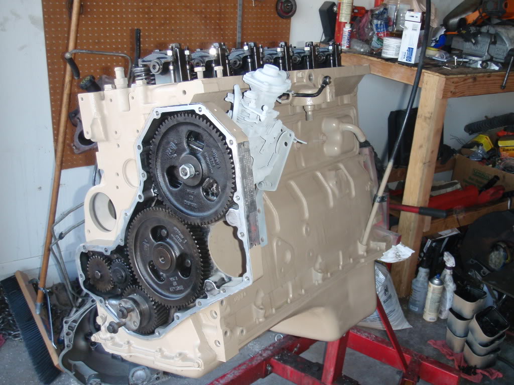

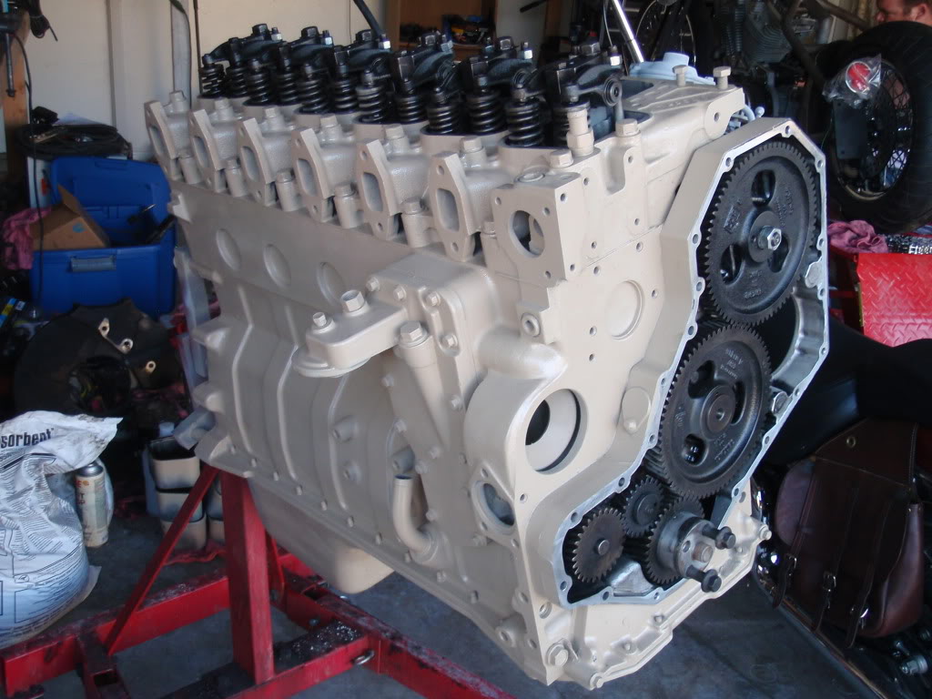

small update, Took me a good week to get the block stripped down good enough to paint, then i re torqued the heads to allow for a little more boost, replaced tappet cover gasket, made a tab for the KDP issue and went through 2 cans of Cummins beige. Note this doesn't need a rebuild I'm just cleaning and resealing the thing while it's out of the truck, should get me by at least 2 years before i do a full rebuild.
Size:  127.3 KB Name:  P1010009-8.jpg
Next is re setting valves, getting the covers back on and new front and rear seals..

Did you manage to free up the factory TDC pin? The one on my 93 had been jammed up with the factory dodge black engine paint.

Not sure what you mean, mine goes in and out but doesn't seem to affect anything so i just find tdc with my finger in the injector hole

Most of the Cummins motors that went to dodge were repainted black before installation into the Rams. The black paint was sprayed over everything and tended to jam up the TDC pin, or at least that's what happened on my 93 W350

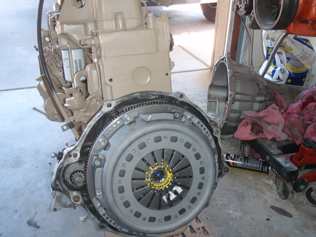

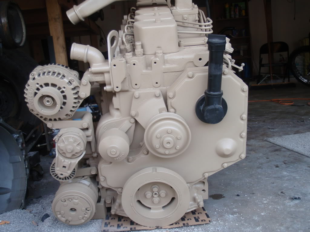

Small update, engines been ready for a good week just prepping frame and axle for the final put together...
Yep that's the factory alternator for my truck bolted to that cummins Name:  P1010004_zpsc343f3c9.jpg
SouthBend clutch
