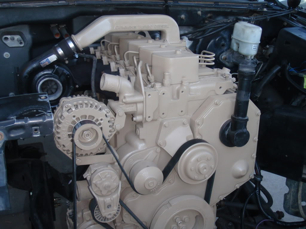

This pig is all wired up finally but ran into an issue with the starter relay, apparently when i lopped off the transmission harness i also got the start wiring too because of the neutral safety dumb dumb switch , so it is now wired directly to the big yellow start wire on the key switch and works great no matter what gear I'm in haha.
still working on all the little stuff ie throttle linkage, narrowing the steering shaft, radiator mounting, tach sensor the list goes on and on

staying stock and non intercooled until i get all the bugs worked out, just trying to get it on the road again before i start hotrodding it...

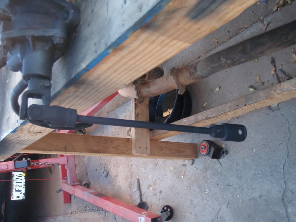

How much you plan on narrowing the steering shaft? Sounds a bit dangerous.

Not at all ill get some pictures if you want when it's finished.
the stock crush shaft was rubbing the engine cradle a little bit
Size:  102.4 KB machined ends and tig welded to a solid shaft

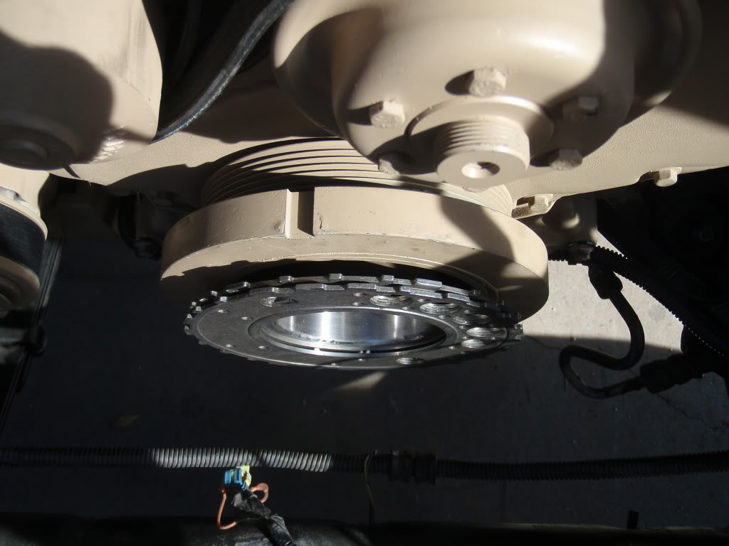

got this beast painted up since this picture, getting it mounted and shimmed under the rig as of now Name:  P1010014.jpg

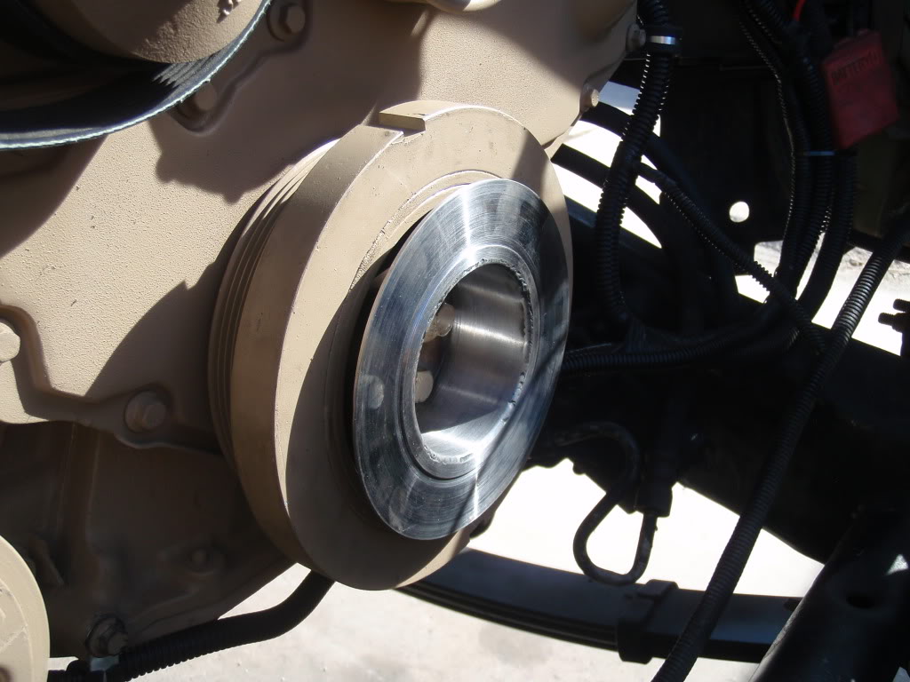

this was machined just for the crank reluctor ring

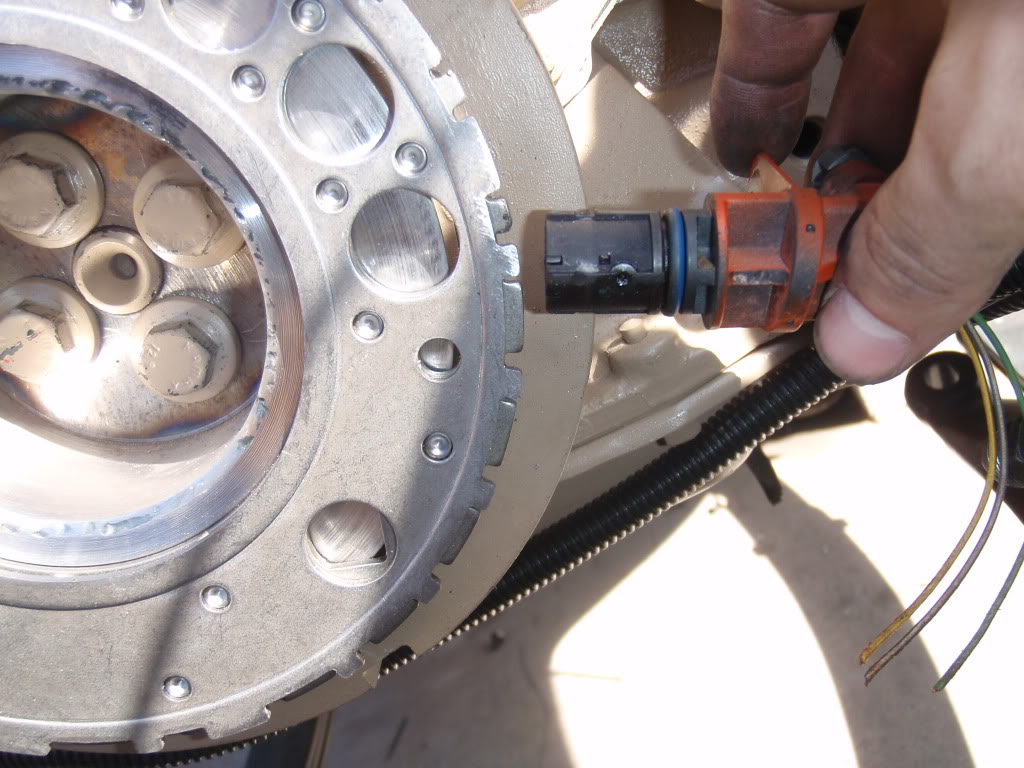

Got to make mount for the sensor... Name:  P1010022.jpg

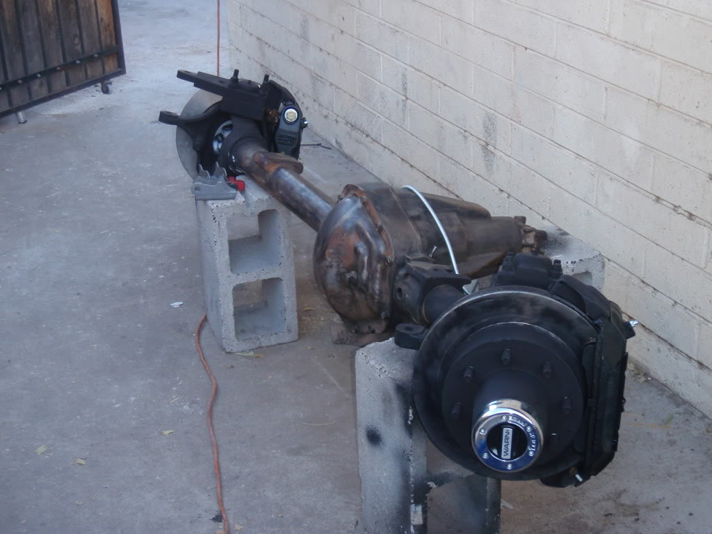

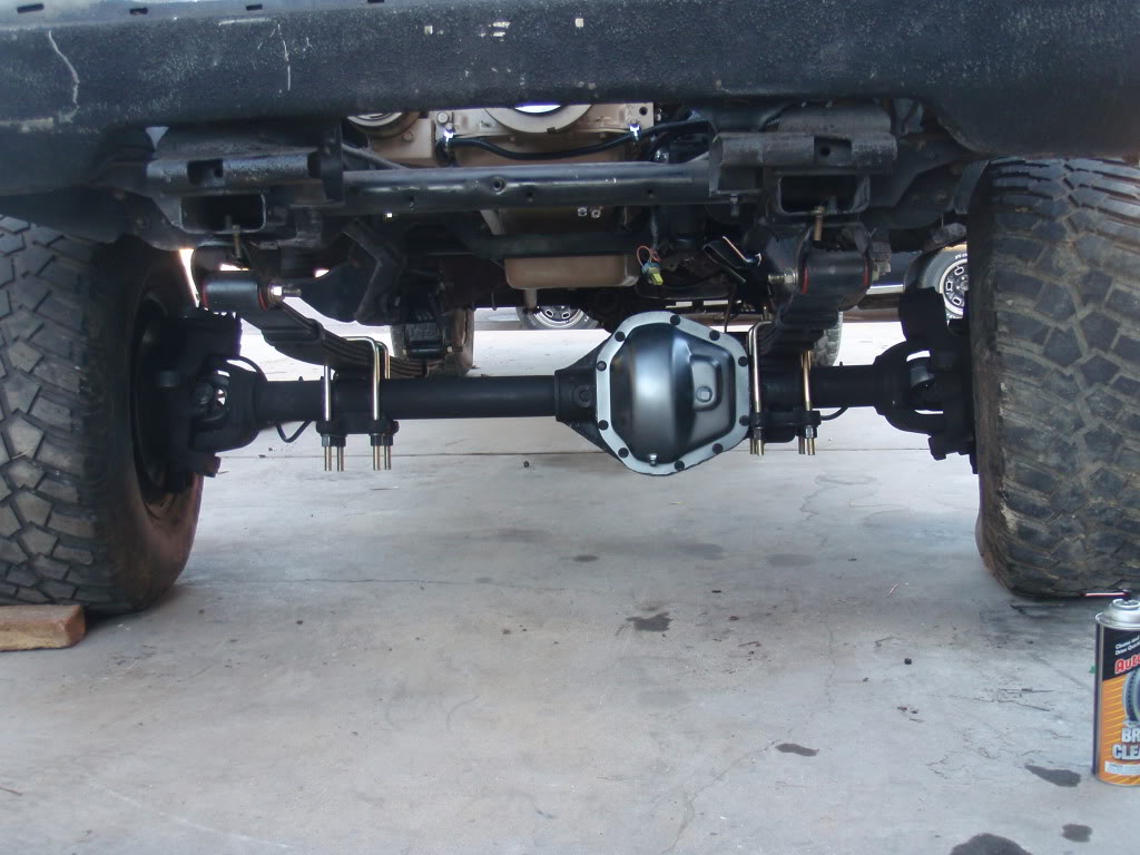

need my cross over steering tubing yet
