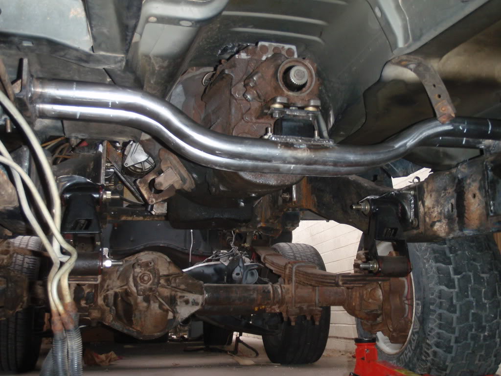

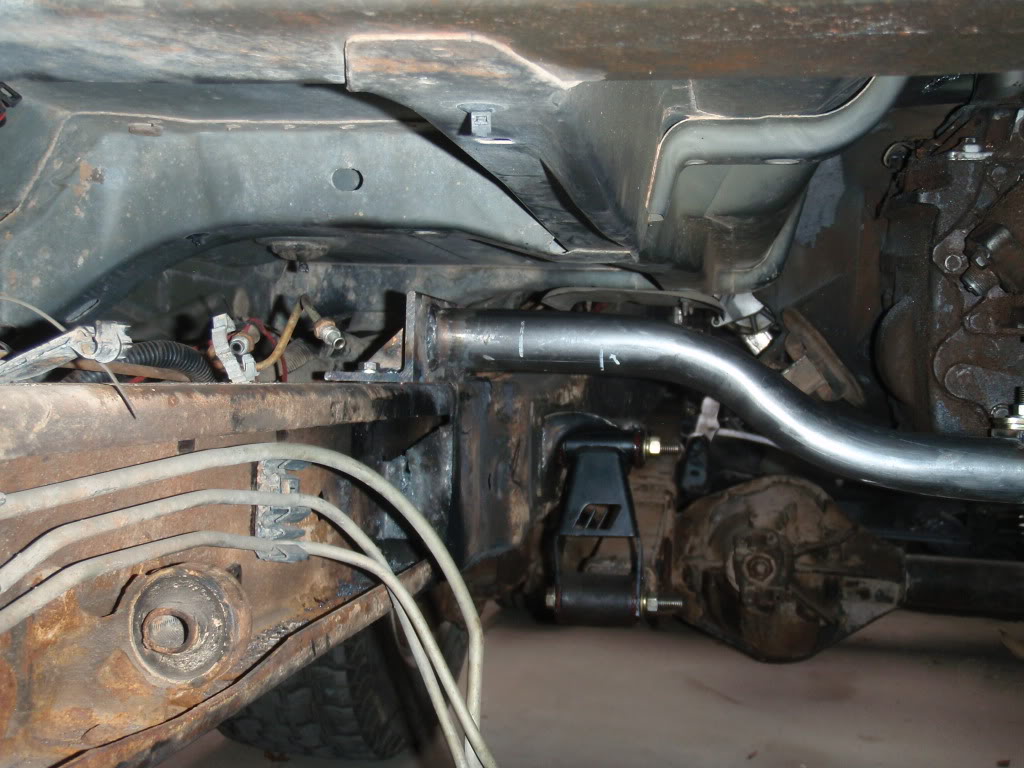

Trans mount done. next up transfer case.

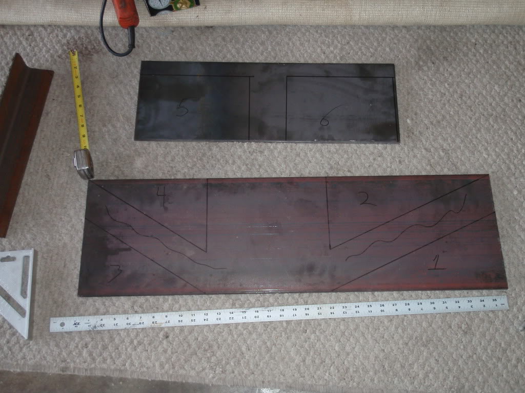

kind of slacking on this thread but definitely not on the project, basically there is no room for any type of one piece cross member for my divorced 205 above it and I'm not compromising ground clearance by going under it or lowering it...

So the mounts will have to be independent of each other (bolt on) so i picked up some thicker metal 3/8th to be exact, this case will be the most stressed part on the rig being a high mount divorced type that likes to flex behind little gasser engines so I'm not concerned with weight at this point as long as it holds the torque who cares.

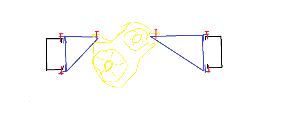

OK so check out my half assed paint drawing of how these things will kinda work
Black is the frame rails, blue is the triangular mounts and well the rest is easy
Oh and yes i know this kind of set up will want to have forward and back movement with just these pieces, so to counter that i am building two lateral braces, one on the passenger side welded directly to the mount and the other mounted to the most bottom portion part of the case on the drivers side with and inline bushing, both connected to the frame.... this thing has nowhere to go then
