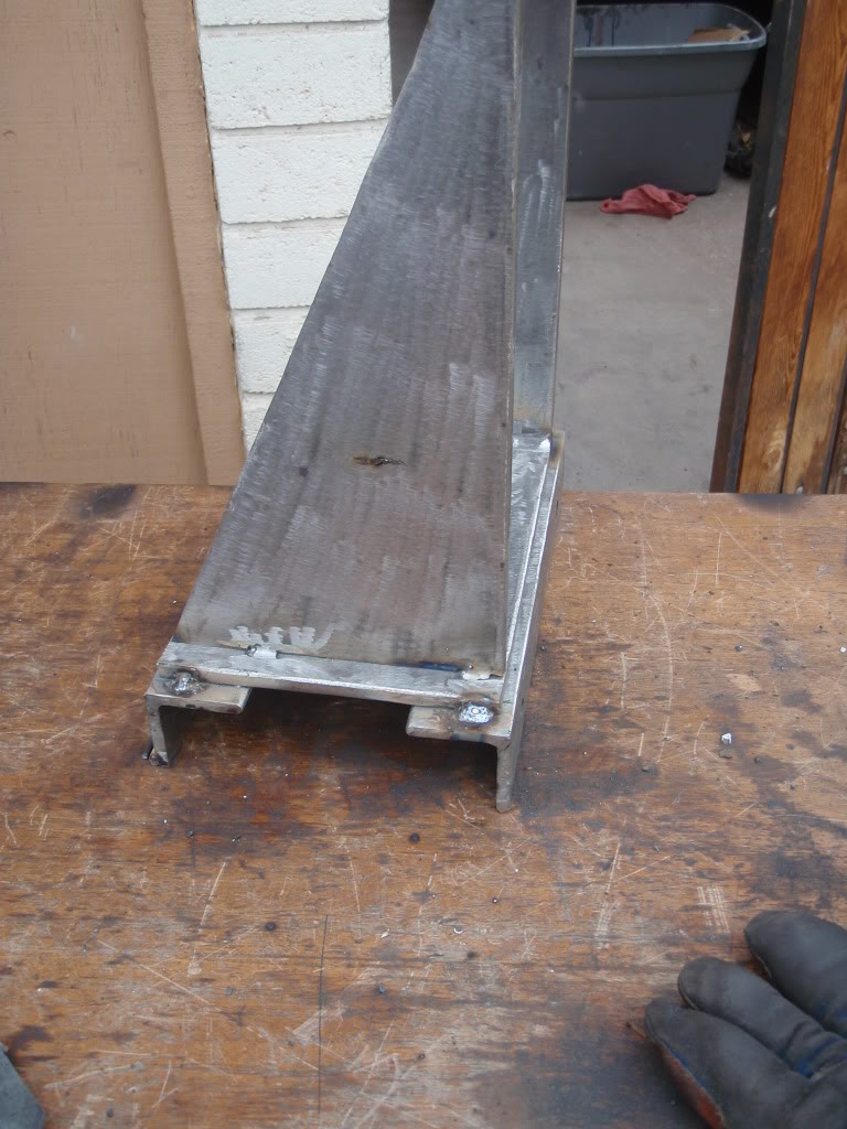

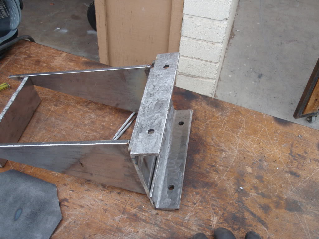

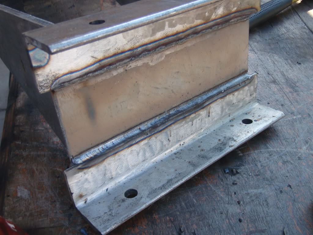

Size:  124.0 KB Never mind that rectangle piece on the end it just keeps it from warping.

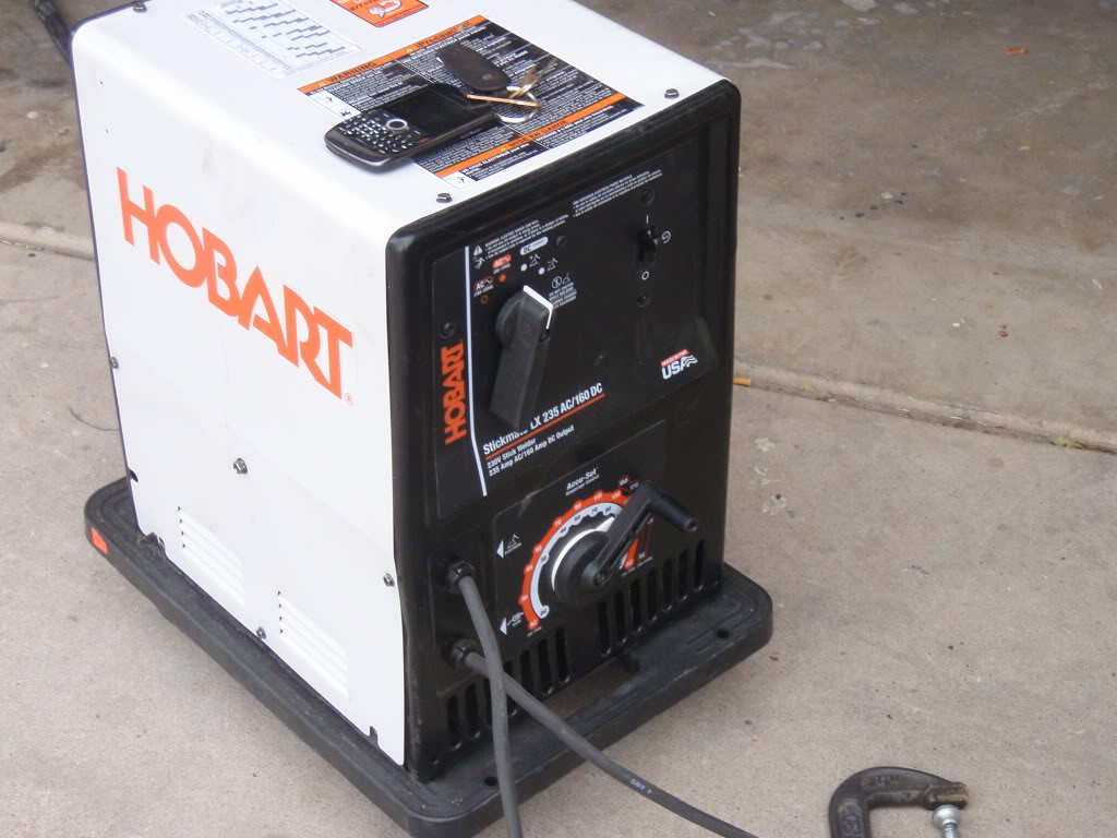

Size:  107.5 KB This little guy is pretty much the workhorse of this project, i use it everyday...

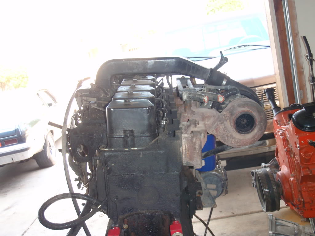

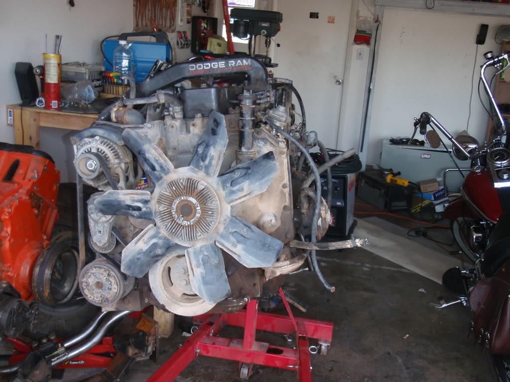

this guy is dirty, but with 300k miles and not a lick of blow by.
I have a list of things to do inside of here like fixing the KDP changing seals, stripping any extra junk i don't need and making it immaculate clean and painted.
later on i plan on doing a HX35/HT3B compound turbo setup, cranking up the pump, aftermarket lift pump and injectors. I want to get close to 400HP/800ft lbs of torque at the wheels but we will see.
