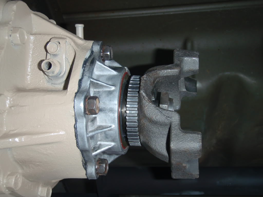

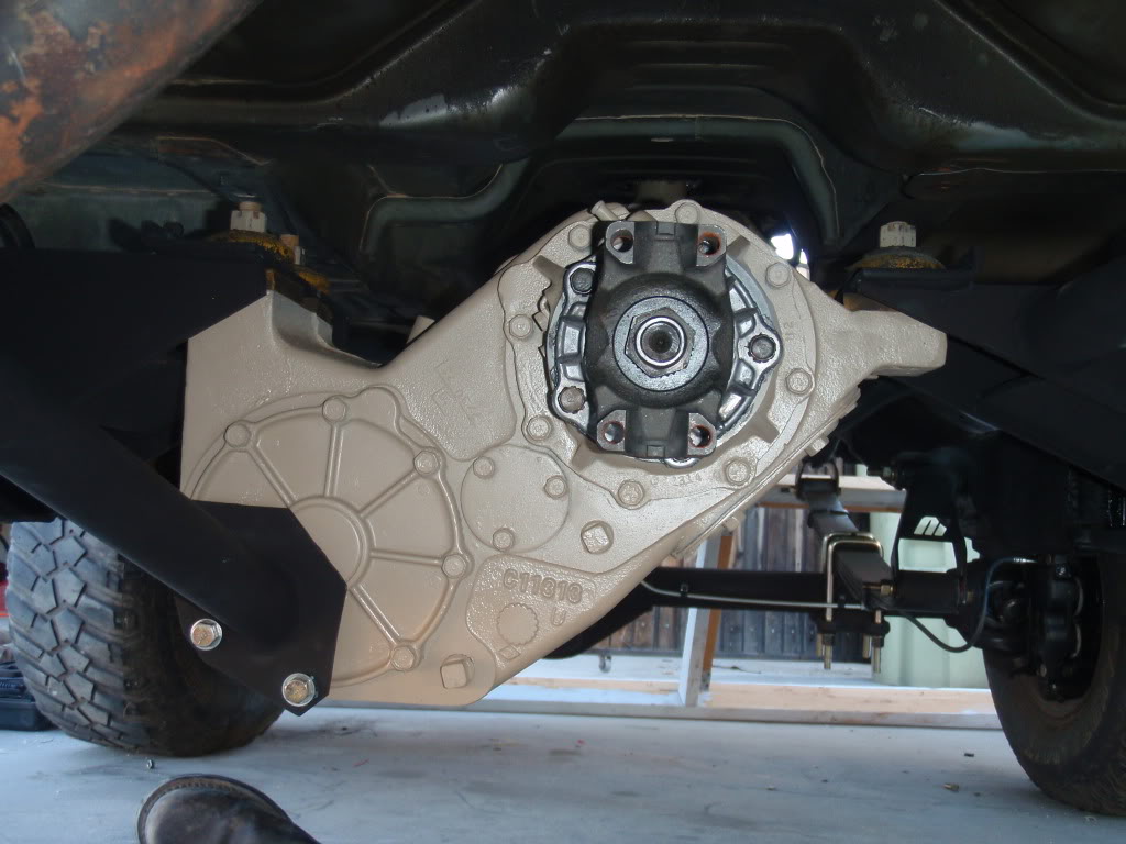

case mounted for final time missing an output seal for some reason

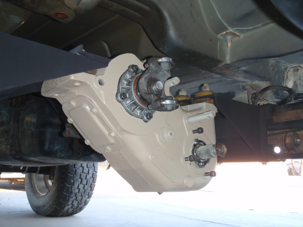

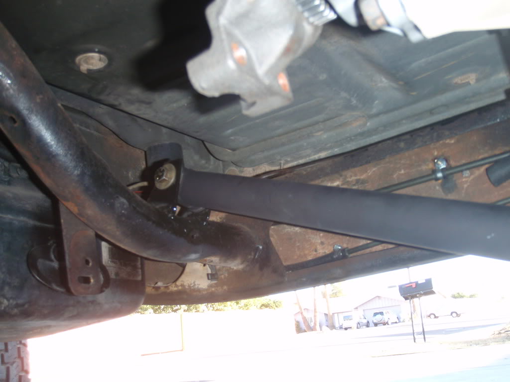

showing off torque mount
and this is the 243 internal reluctor ring machined and pressed onto the 205 output yoke for my factory speedo
