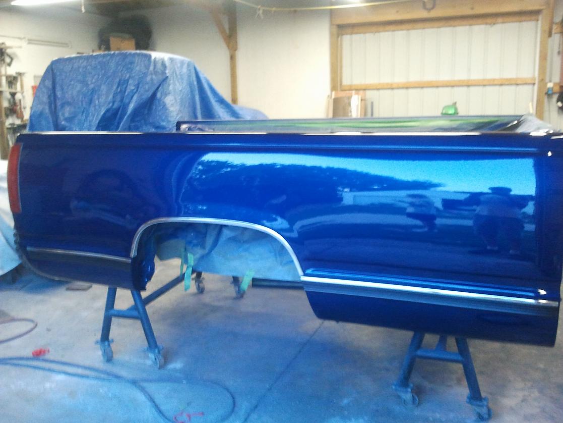

this would be my project that started off as a little rust repair turned in to a huge project.
started off as a 88 1/2 4x4 with rust and more rust. we put big patch panels in the box way to big. put cab corners rockers bought new fenders, stole doors off a buddies truck that was wrecked took seats out of it.

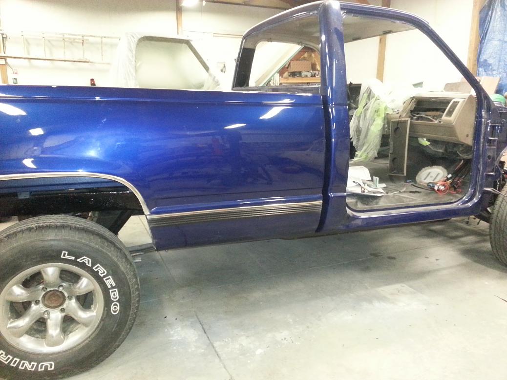

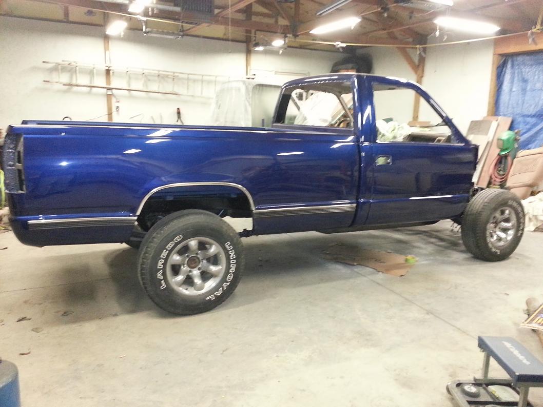

so far the cab is on frame beds on and about it. I have motor that needs put togeather but im in the process of movie for the first time so lots of stuff to do till I get to start working on it again.

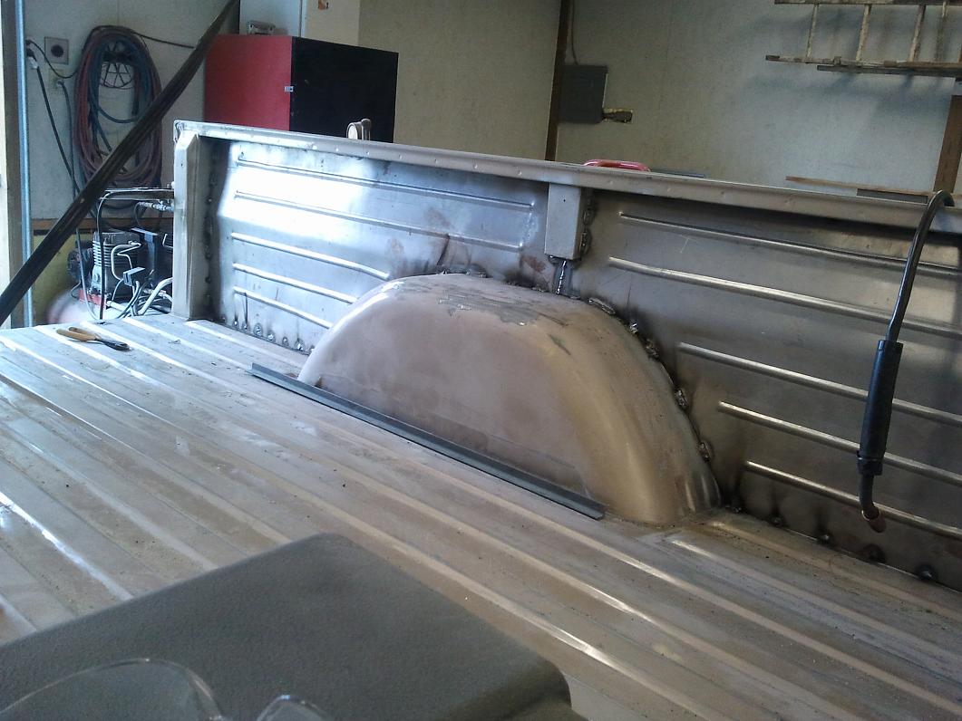

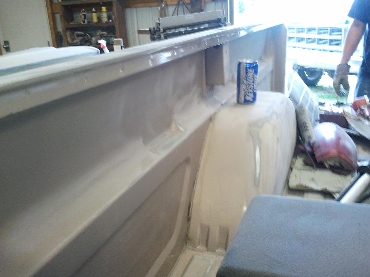

this was after we cut the in box sides out had little rusting problem. used 20 gauge sheet metal rolled beads in it bent it up.
the box has more bed liner in it this anything we have ever seen its go it in the box on the bottom. while it was all cut apart we cleaned up the inside of the outer box eypoxed it and bed lined it also lots of work in to the box for it to just seat have people lean on it. the right hand side now has dent it from where everyone thought they could lay up agaist it which really made us mad but where playing on putting a short box on it and shorting the frame plus boxing the rear half of it shes pretty flexible way to flexible
