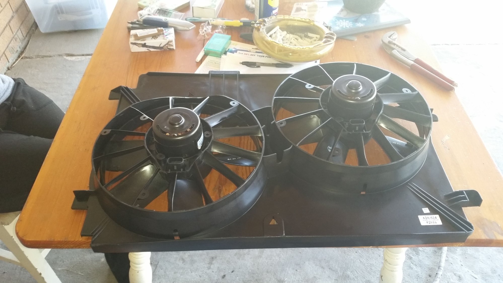

Summit fans, think is should have bought a better brand but I'll make it work

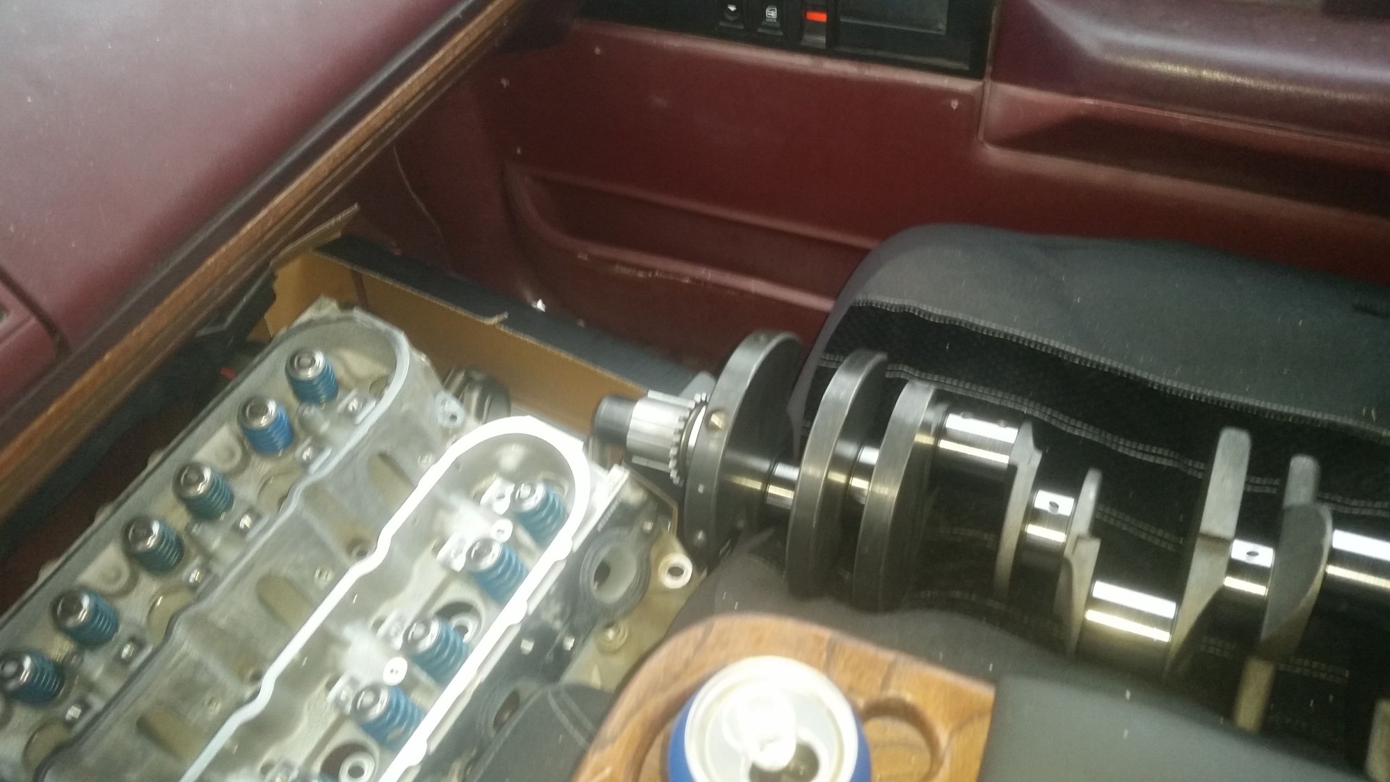

Rod and main bearings showed up also, head locator dowels. I think I'm just waiting on a transmission cooler, and the machine shop to polish the crank and press the pistons on the rods

Heads, rods, pistons, crank back from the machine shop. <br/><br/>Transmission cooler showed up no pictures of that. So I have everything i need to put it together, just need to verify torque specs, go buy some plastigage and we will get this party started

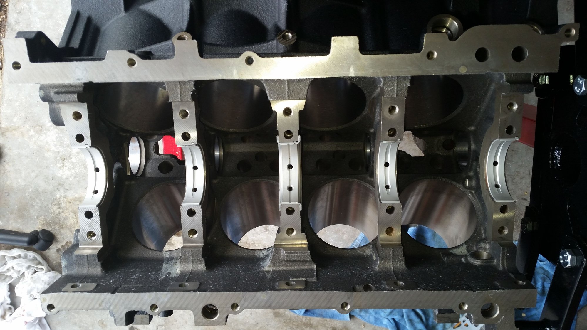

Cleaning cosmoline off the block
Old Mar 10, 2016 | 07:57 PM
  #66
TwistedBigRig's Avatar
Joined: Feb 2016
Posts: 193
Bearings in

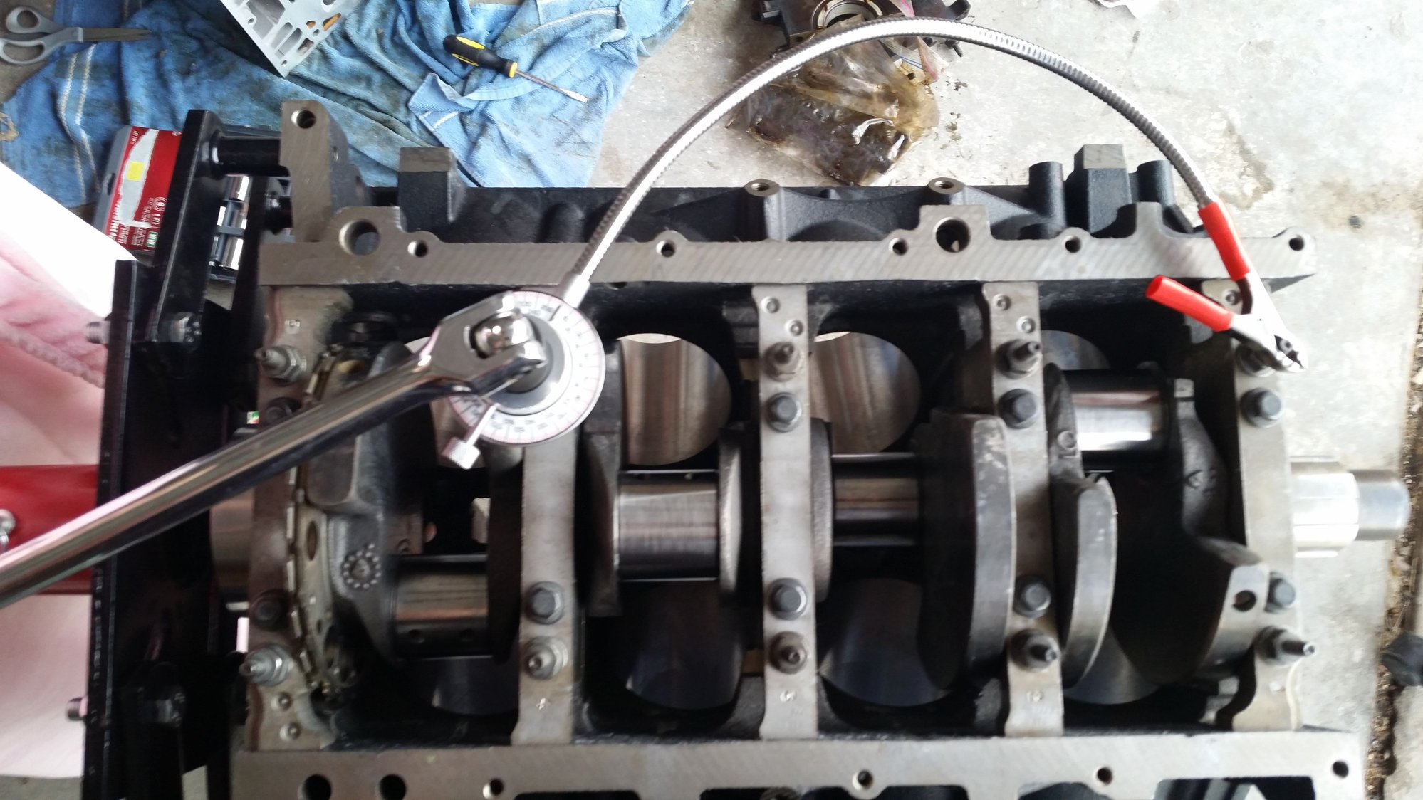

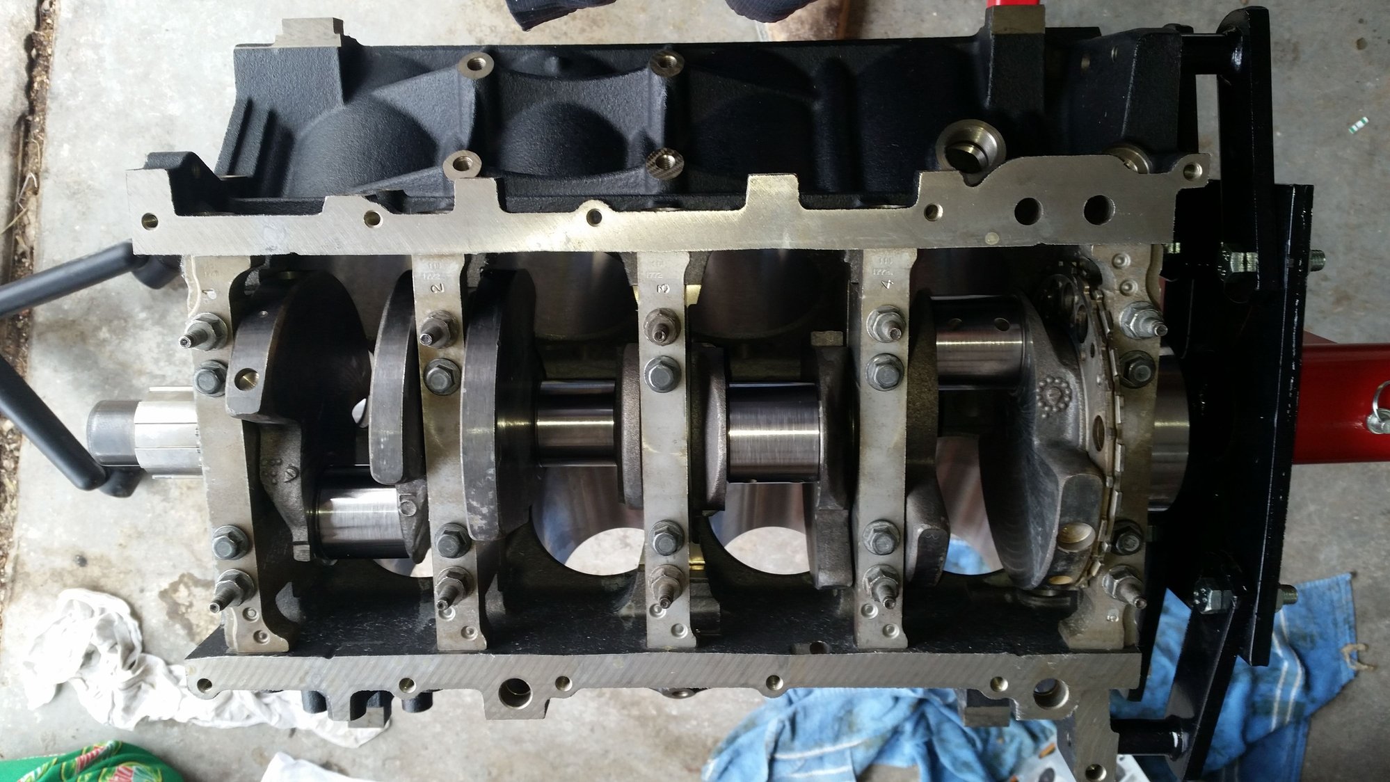

Crank in dry, plastigage in all the caps.
Old Mar 10, 2016 | 07:59 PM
  #68
Joined: Feb 2016
Posts: 193
Main clearances, self explanatory
Old Mar 10, 2016 | 08:00 PM
  #69
Joined: Feb 2016
Posts: 193
No pictures of it all lubed up but heres my handy dandy tourque angle gauge i pucked up for 25 bucks.
