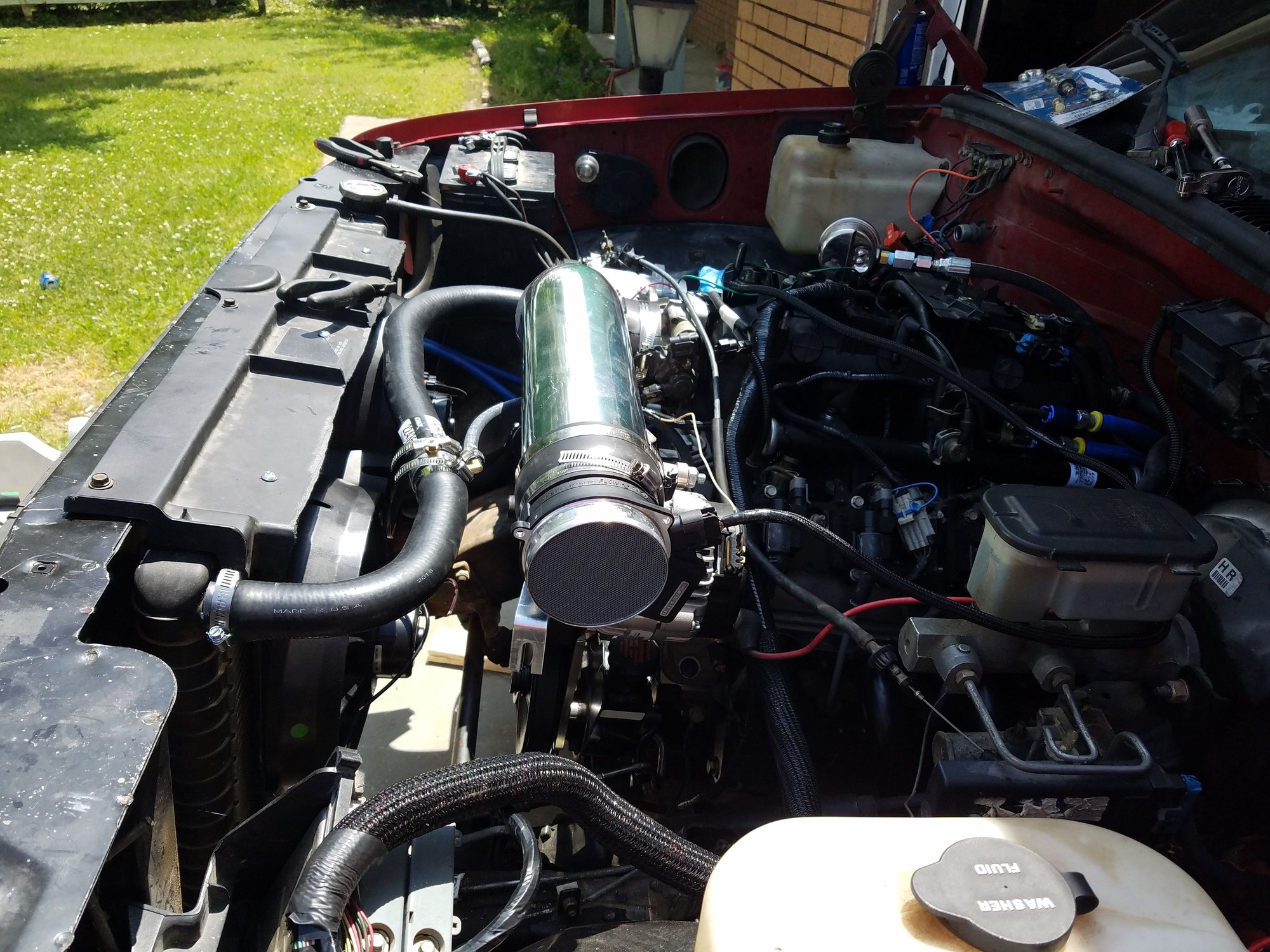

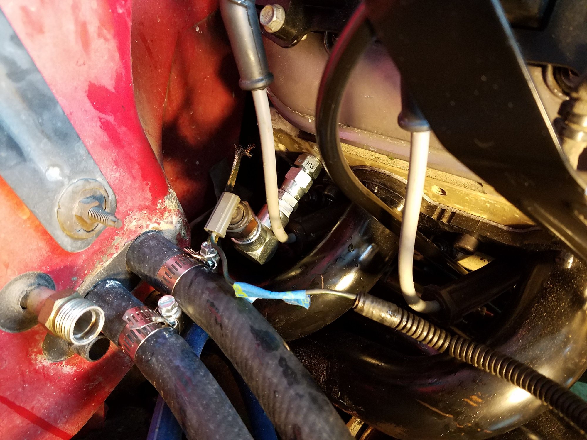

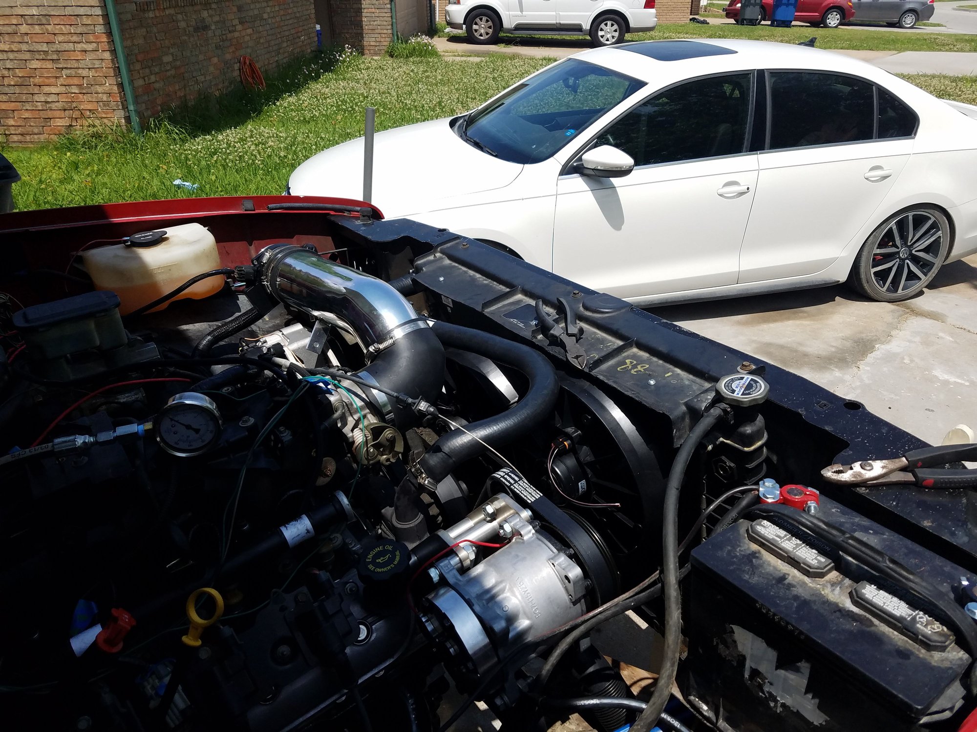

Fans installed, cooling system plumbed, jags that run steam port radiator hose tap with air bleed totally worth the 33 dollars shipped.

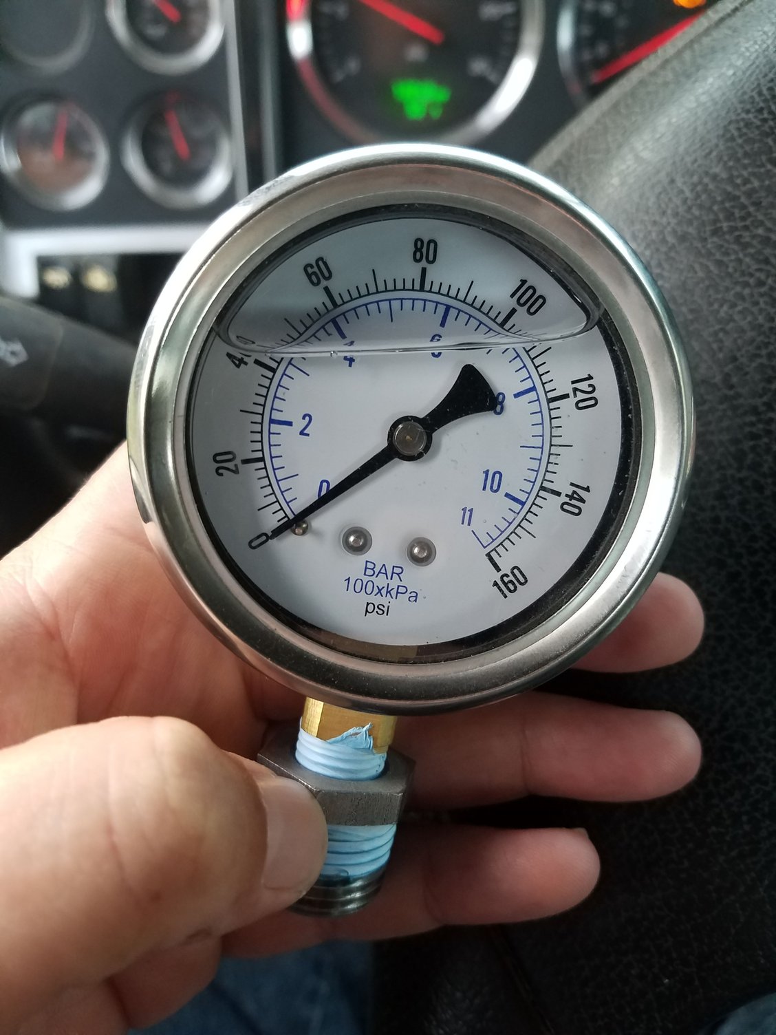

Pieced together a m12x1.5 to 3/8 npt adapter. Not as elegant as a after market piece, cost me 15 dollars in fittings but its stainless, rated for ungodly PSI and with the swivel im able to clock it where ever i like
