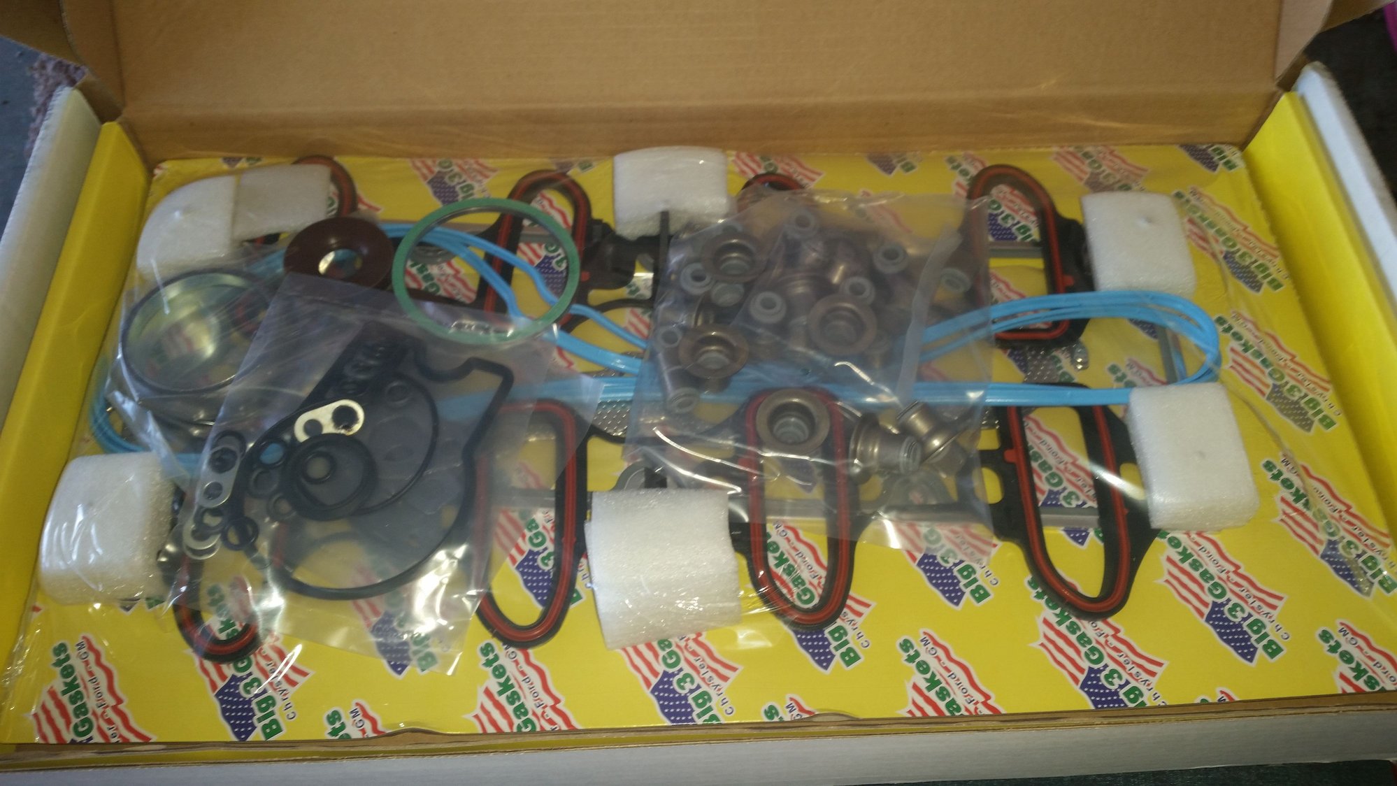

Speak of the devil, showed up a day early, worked out good l, was off today for dentist appointment so was able to get my valve seals over to him. Hopefully ill be putting this mouse together next weekend. Think ive got everything except maybe an aftermarket fuel rail, not sure the truck rail is going to work with my new injectors, and some an braided hose and fittings.

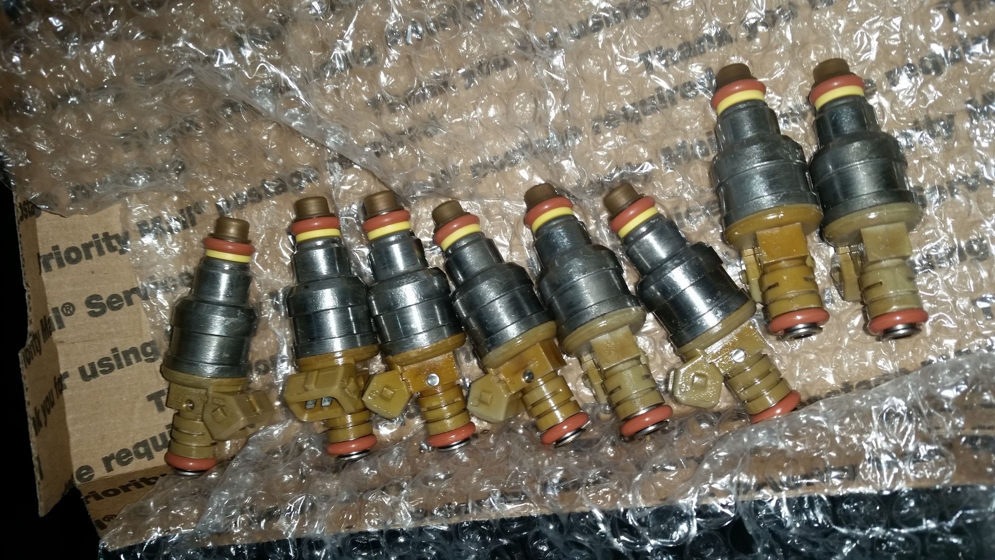

30 pound ev1 4 hole injectors from ford, rebuilt and flow matched to within 1 percent <br/><br/>Will stick them on my intake and see if the fuel rails work this weekend. Not looking promising just from eyeballing it. <br/>
Old Mar 2, 2016 | 06:27 PM
  #60
TwistedBigRig's Avatar
Joined: Feb 2016
Posts: 193
Anyone happen to have the specs on these guys? I didn't get any paperwork with them for the tunner.
Also what electric fan set up for a 89 gmc stock radiator? Open to dual or single fan units as long as they do the work, also, anyone recommend a tranny cooler?
