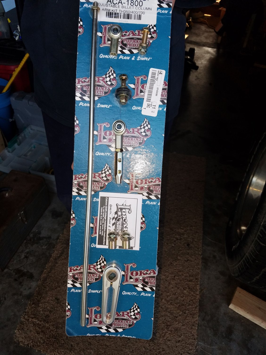

Solution for shifter

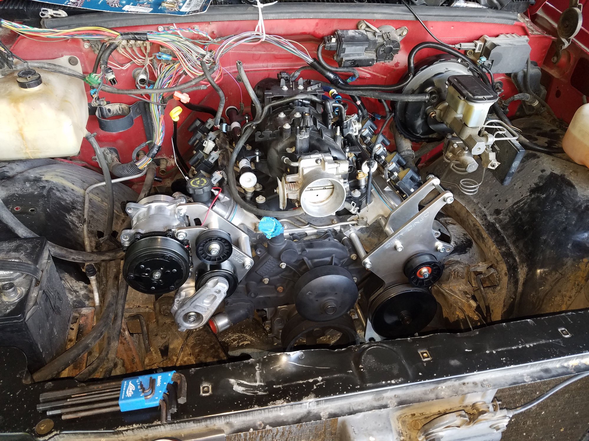

Accessories on except alternator, thought my small case 75 amp alt would fit but it wont without modifying the dirty dingo brackets. So need to buy a large case 105 amp alt.<br/><br/>Also my ac lines appear to be to short despite the sanden 508 conversionplate from dirty dingo. Thats depressing. Bought the plate so i wouldnt have to have new lines made.

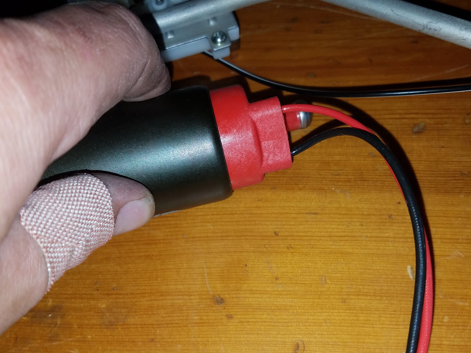

Installed fuel pump

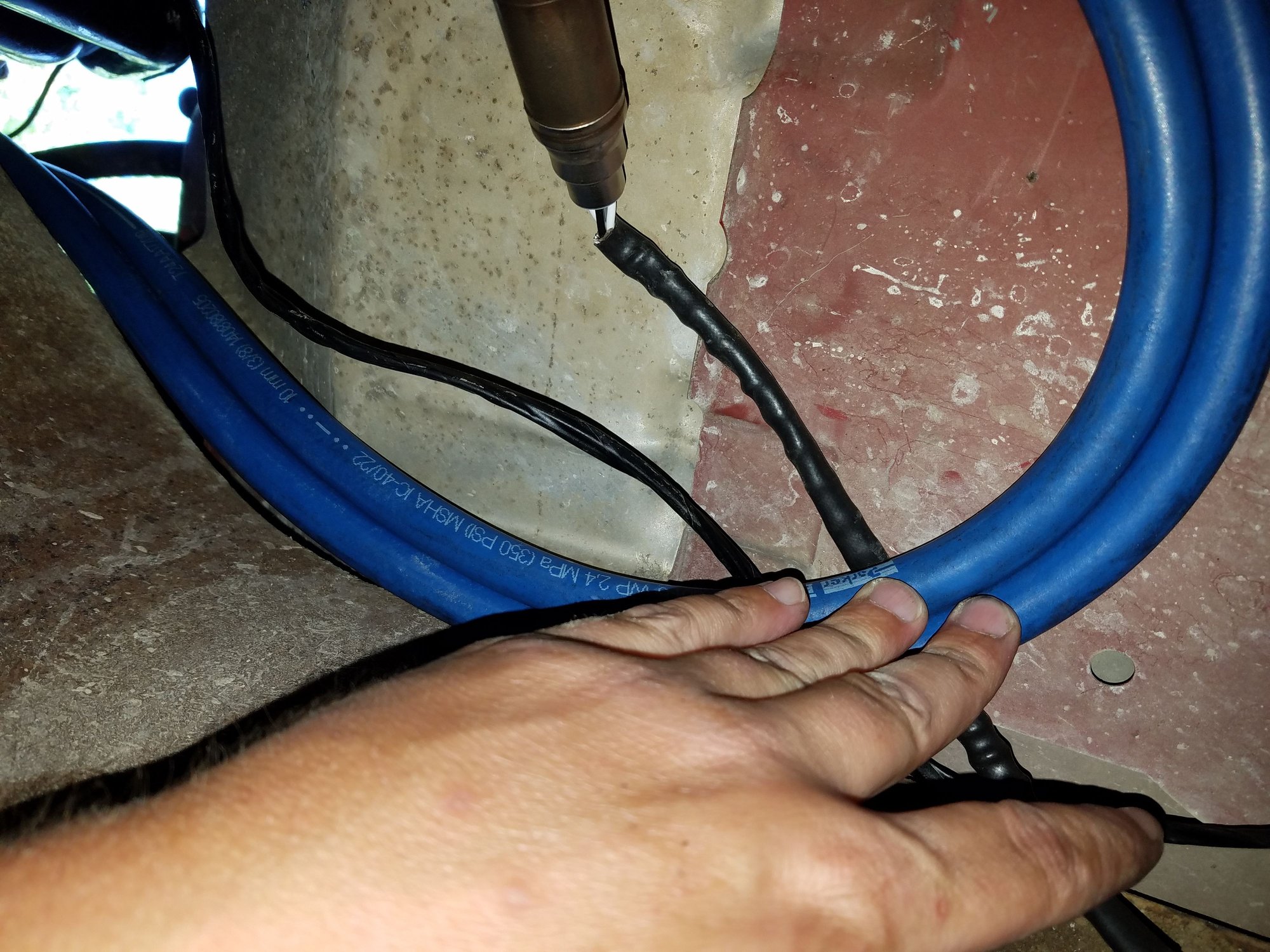

Routing lines for tranny cooler, 2 45 degree jic fittings onto parker 801 hose

Going to buy some rubber line clamps and hopefully mount them like this

I used 2 russell fittings for the transmission,and 2 jic 45 degree fittings for the lines, then 2 jic straight fittings for the cooler
