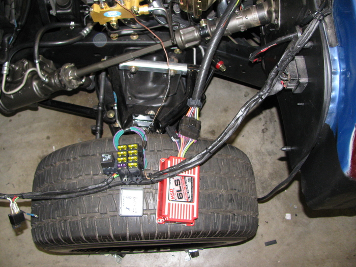

picked up a MSD 6012 ignition controller with map sensor and an air cleaner today. $280 shipped.
not my motor, but the air cleaner.
i traded my ruger LCP for a set of new hedman ls1 swap fox body midlength headers that my dad had laying around. i doubt they will fit the s10 but i'm sure i can sell them for a good profit and put that money towards my headers. i only had $300 into my 380 lcp so i was totally willing to trade my $300 gun for $600 headers the cam, carb and intake should be rolling in today
