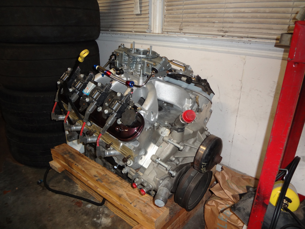

i found an intake and carb today. it's a recently rebuilt holley double pumper with a brand new victor jr intake. comes with the fuel bar, throttle brackets, gaskets and the fuel bar. 450 shipped.
NOTE: NOT MY ENGINE PICTURED, BUT MY INTAKE/CARB
Old May 8, 2012 | 12:52 PM
  #27
Tootall's Avatar
iTrader: (79)
Joined: Jun 2002
Posts: 5,175
From: League City, Tx
Hummer oil pan ?
Headers?
Old May 8, 2012 | 12:58 PM
  #28
TXsilverado's Avatar
iTrader: (19)
Joined: Jan 2005
Posts: 18,364
Likes: 292
From: Humble Texas
yeah i will use the hummer oil pan so i dont have to cut the crossmember. headers will probably be brp 1 3/4 or brp 1 7/8. i havent decided if i want to use the 1 7/8 yet because i dont think the ac compressor will fit with them. i'd like to keep A/C if i can.
Old May 8, 2012 | 01:00 PM
  #29
BlackGMC's Avatar
Resident Retard
iTrader: (31)
Posts: 17,216
Likes: 20
From: Fort Worth - TX
I think you have to relocate the ac compressor to the top to fit an s10
Old May 8, 2012 | 01:18 PM
  #30
iTrader: (19)
Joined: Jan 2005
Posts: 18,364
Likes: 292
From: Humble Texas
nah, a simple frame notch will let the ac compressor slip right in. the only thing i havent quite figured out is the transmission crossmember for an 80e if i go that route. over on tech i see guys with 500 running years on a junkyard 80e with a trans-go shift kit. until i'm ready to drop the big bucks on a built transmission i guess i'll have to skimp out on running a trans-brake. theres an 80e on craigs list from a 2005 service van that was rebuilt 25,000 miles ago for 300 bux. tempting. i've bought enough for it this week though lol.
