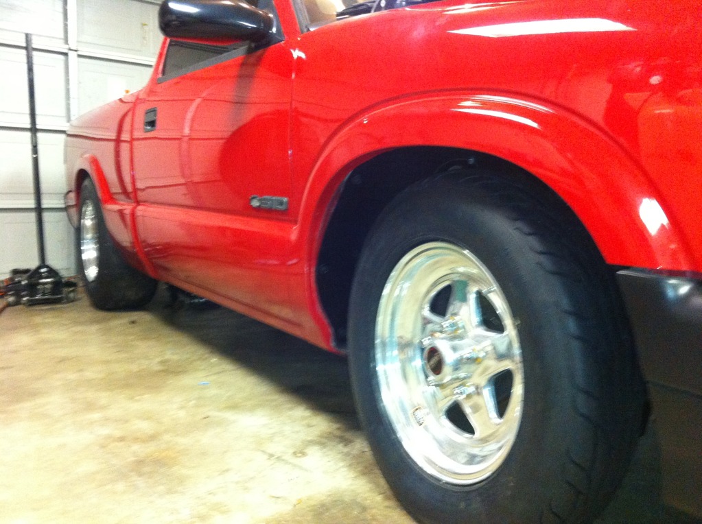

back to the s10
picked up the ford 8.8 rear from the machine shop on friday. had it cut down 3" on the drivers side, arp cap studs, new races, bearings and seals, welded tubes, redrilled to chevy lug pattern, new perches welded up at the correct pinion angle. got it all bolted up over the weekend and had time to run all of the brake lines. all the rear end needs now is a nice dif covor. it dropped the rear another half inch. time to measure for a new driveshaft. here is the final stance of the s10. looks pretty wickid IMO

That's stance is just sexy as hell! Good lookin dime u got stew!
