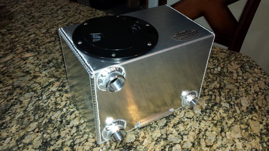

This just in...

New counter tops, much wow.

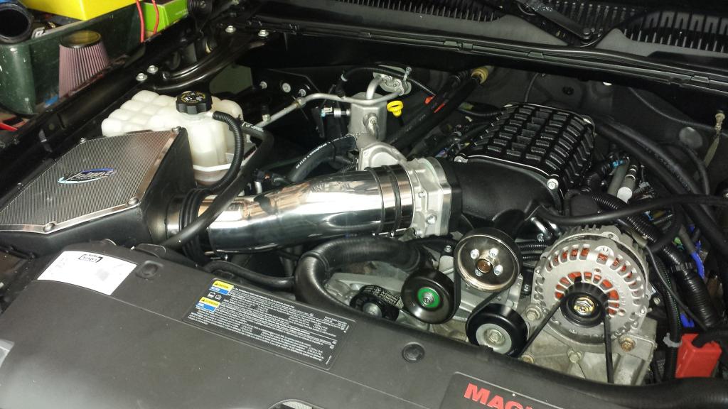

Is that 4" Spectre intake tubing? ...it looks larger than that. I used the 4" Spectre and had a 45 and 22 welded together - can anyone tell if that's the same diameter as mine? I'm also in the market for a rubber coupling to connect my intake to the 102 if anyone knows. Thanks!
Thanks to Rick at Trick Performance for fabbing my twin blower intake.
Yes, it is 4" Spectre tubing. I was messing around with the throttle locations to minimize hood height. So I don't have it welded permanently in any particular configuration. Couplers are all Spectre as well.
