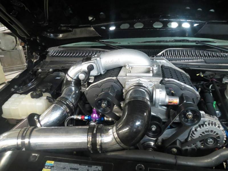

Where would you spray meth on this setup? Pre throttle bodies? Common plenum between the blowers(after the TBs)? Post blowers/pre intercooler? Why?

Not exactly sure what your lower manifold consists of but you get better cooling spraying post compressor.

Back when I was supercharged I always wanted to spray after the intercooler. I think you will get the best reduction in heat that way.

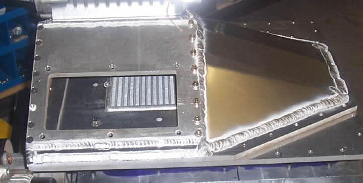

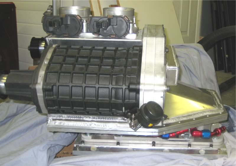

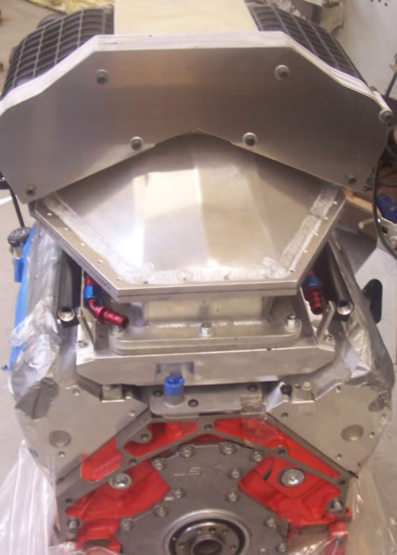

There is a common chamber under the blowers before the IC. I also thought it would be better to spray here rather than through the rotors, if you could get even distribution. Spoke to Julio last year and he suggested sticking with a "proven" pre TB setup. I have sprayed pre TB in the past on a MP112 and saw no change in IATs.
Some old pics:

wow... this is the first time I have really seen the bowels of this monstrosity of a project. WTF
Anyway... if there was a way to confidently get the same amount of meth in each cyl spraying post IC I would do it.
