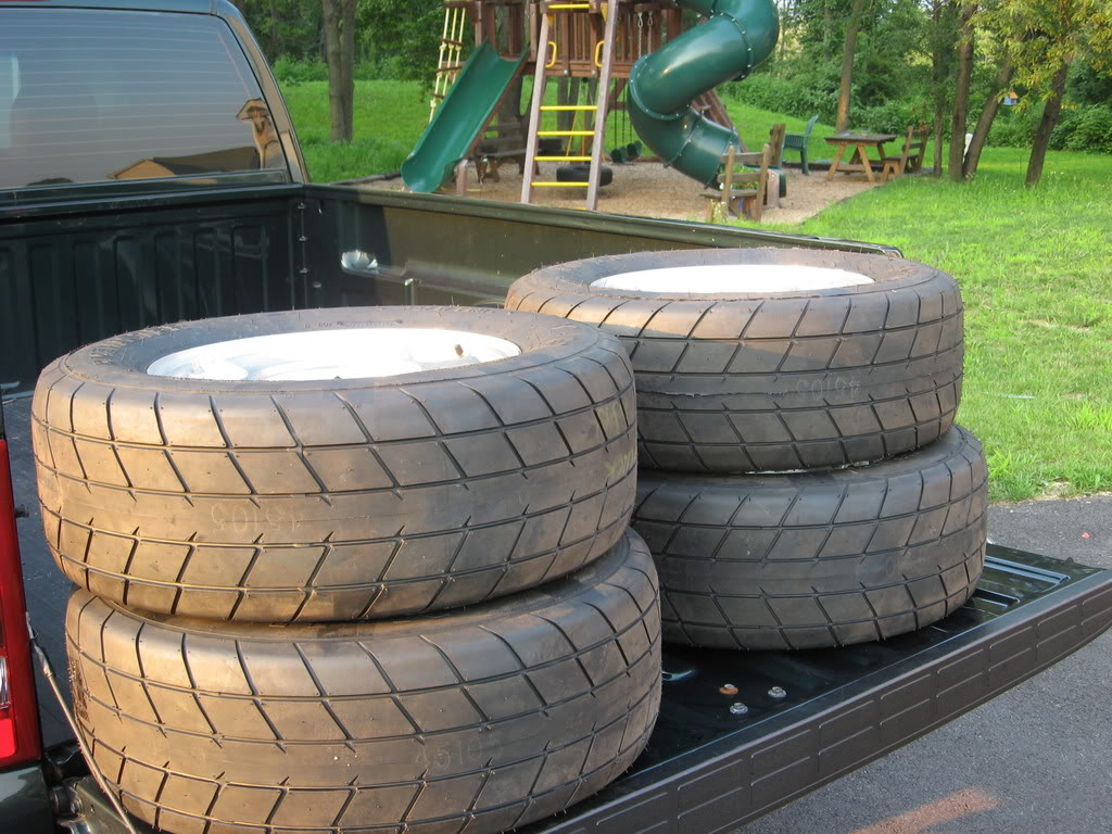

Other SSS guys have run 16's. Those may work for you. Here are a couple pics of 'Krambo'
As far as meth. I use it more for the Octane boost than the cooling effect. I would run e85 if it was available as I think its an even better option than 93+meth. You will be in a better situation than I am running e85 IMO.
Old Jan 29, 2015 | 06:58 AM
  #249
L8ERBRO's Avatar
Joined: Jan 2014
Posts: 341
From: Olathe, KS
Thanks for those pics Rob - I have to say his truck looks a little silly with those tiny rims and tires, although, it also looks like he's running no drop which makes them look even smaller. Hopefully mine won't look as bad if I decide to go this route!
I actually found those same rims on CL from two different dudes - the 16's are just the rims for $300 and the 17's have all terrain tires for $400 ...decisions, decisions!
The main reason I'm doing the gearing change on the 80 is to not only compete with your awesome time of 11.43, but because 99% of the time I'm going to be running the 22" intros with 305/40/22's which are 31.5" tall. Even where I'm at right now with 11psi, I get absolutely no wheel spin and had a horrible 1.83 60' last time I was out and ran the 12.00 @ 115. I think I need the gearing change for a better launch on that setup. NOW, Eddie Mack from the SSS forum is running the jackshaft on 18 psi with the same 16" wheel/tire setup as Krambo and says he gets very little wheel spin during the launch, AND he's running the FLT 65e level 7 with a 3.06 first gear which is even taller than the one I intend to have installed. I think his 60' is 1.53 with an 11.1 quarter mile. If I can get even pretty close to that time, I'll be smiling from ear to ear!
