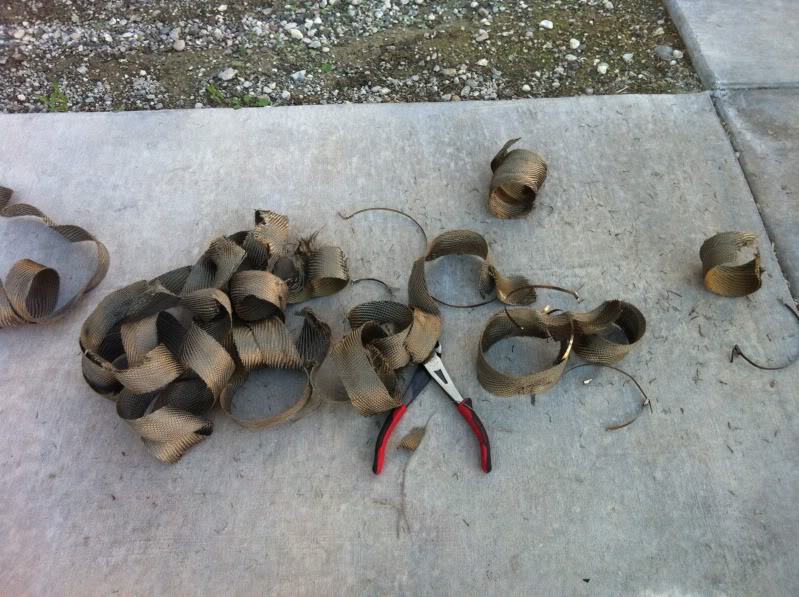

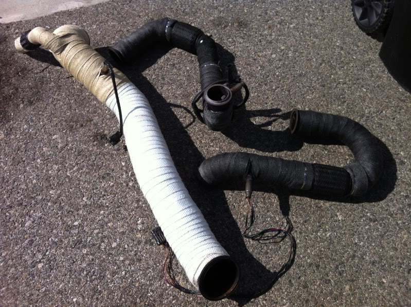

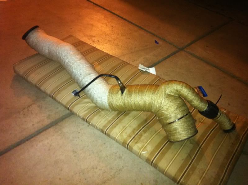

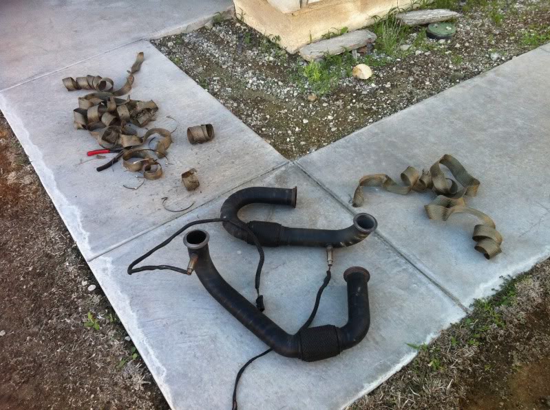

Pulled off some of the Hot parts and Re-wrapped them. Here's what all came off, it basically came off by blowing on the old wrap. I don't know if it was installed incorrectly or just burned to a crisp but Fiberglass would be blown around the engine bay anytime to fans came on or the truck was moving. This was that titanium wrap stuff...

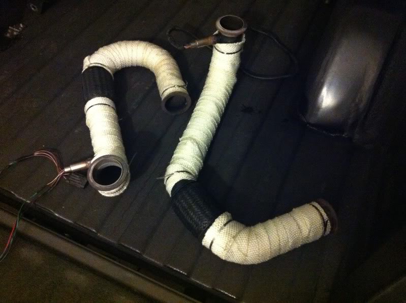

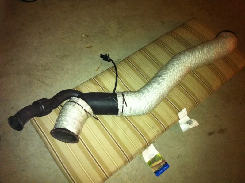

Got some free industrial wrap from member RANDOM USER. This stuff was thick!!!

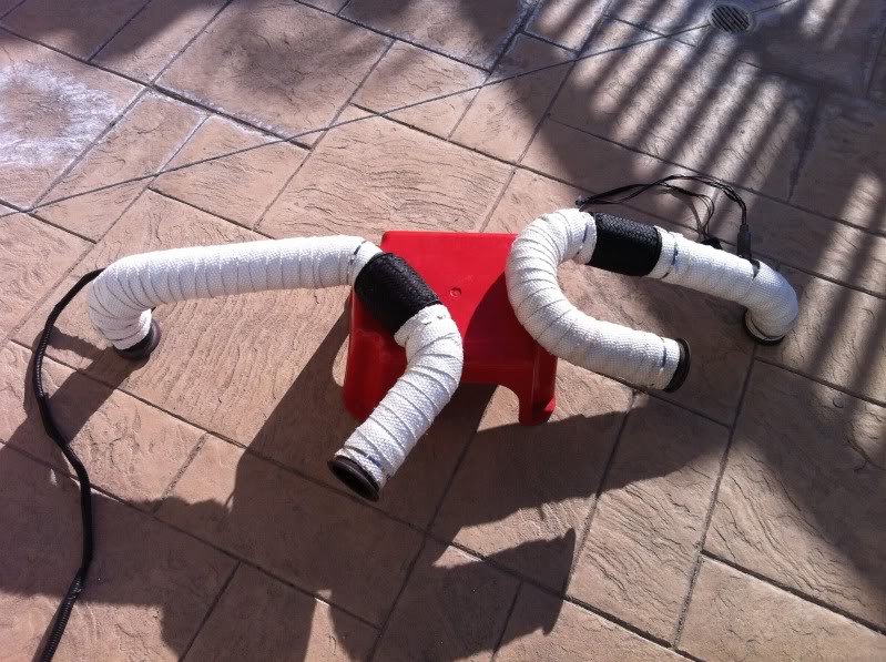

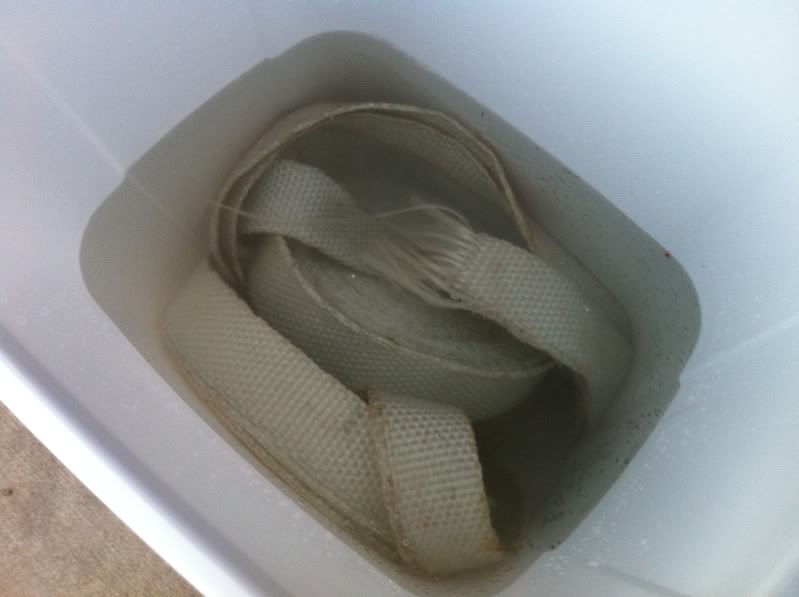

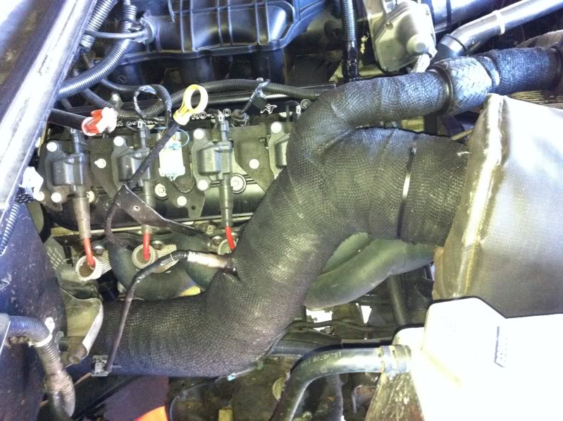

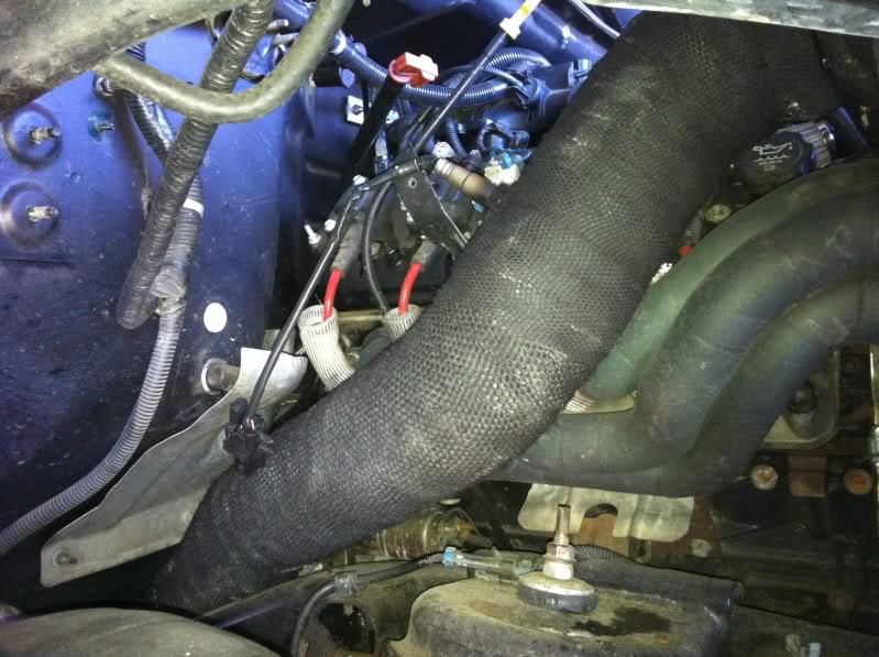

Soaked it and proceeded to wrap my DP and two crossovers that I have up front...
Random User supplied me with I think 200 feet of 2" wrap (which is alot) however Because I was overlapping so much on purpose I soon ran out so I bought another 200 ft of DEI stuff I found at Autozone and double and in some place tripple wrapped it...

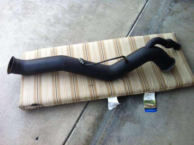

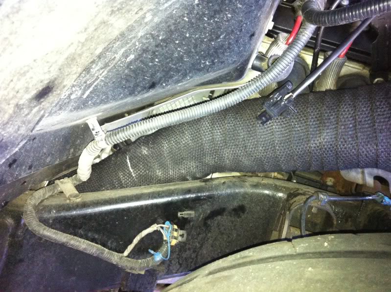

I also bought some of that Hi-temp Silicone spray and started covering all the wraps...
Anyways, I have them back in now, put a few heat cylces through them and alot of the water/spray burned off and seems like it's gonna work. There's a few things I got re-adjust before I can really put a load on the pipes and get them to glow so that I can see how well this new wrap will work. Probably won't be for a while though as I have no motivation and am leaving hopefully soon.
