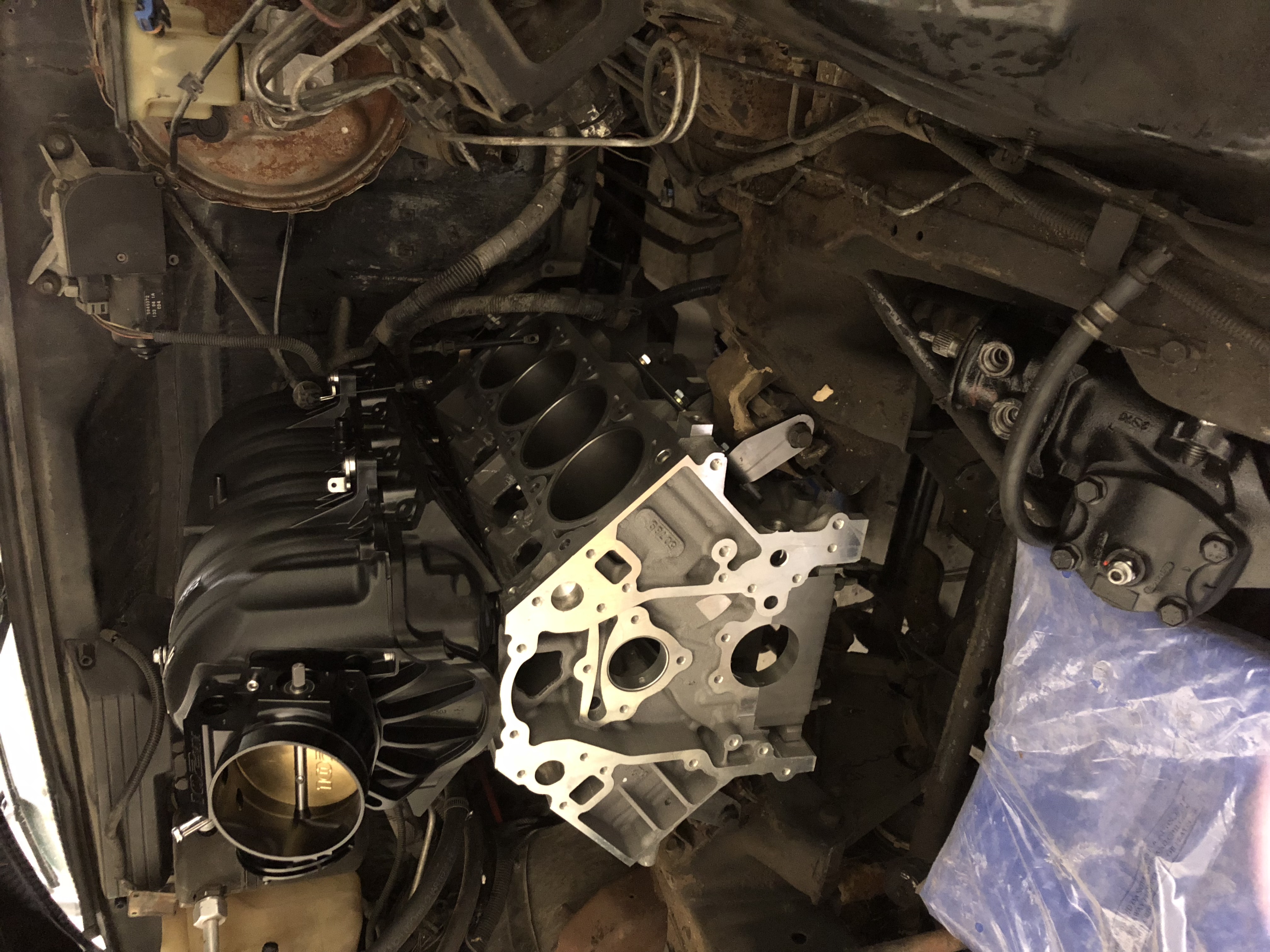

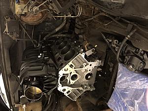

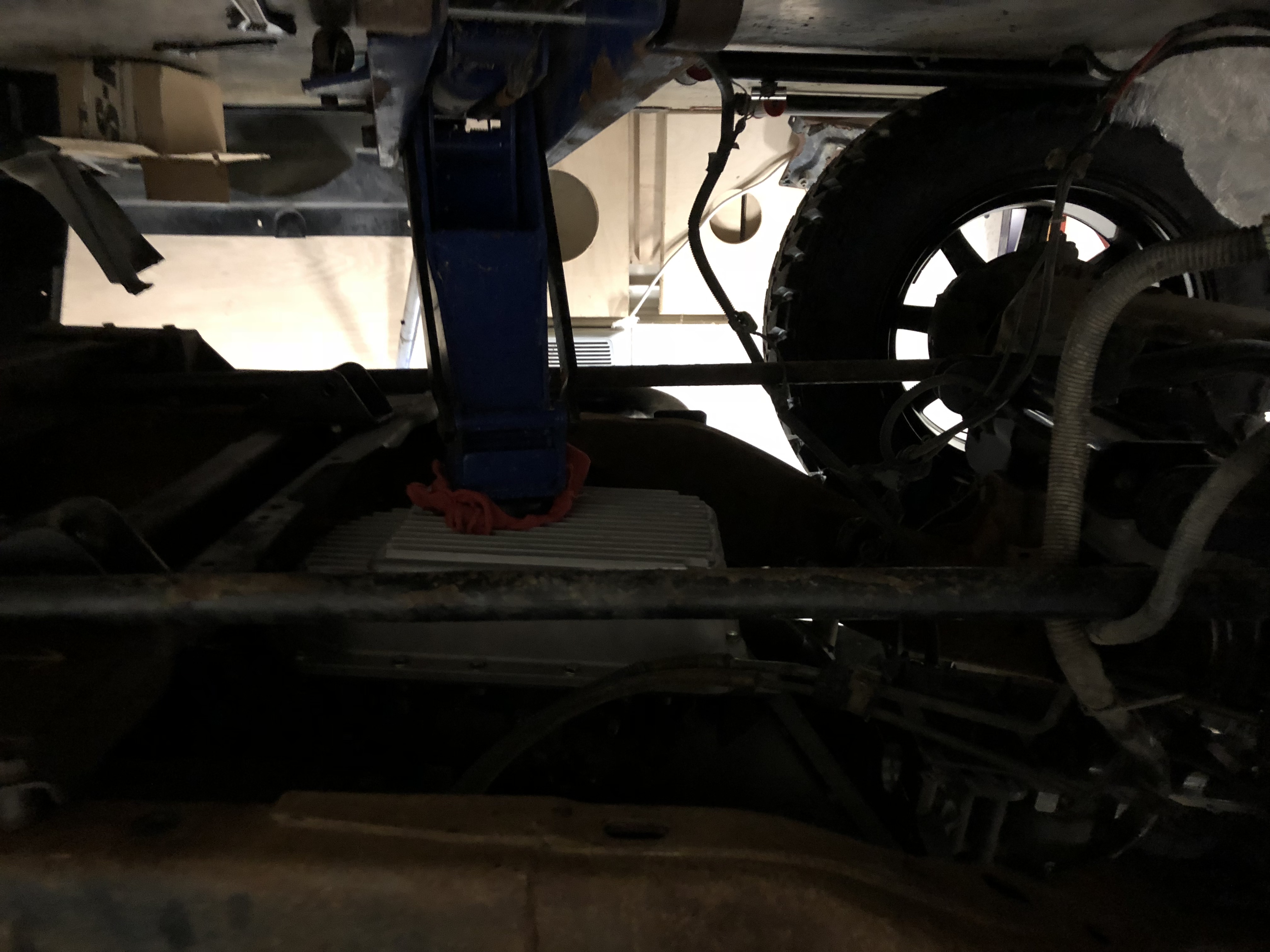

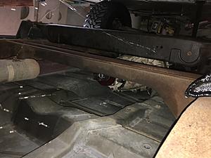

I've found time to pull the old engine and transmission from my truck and install the new LS3 block and 4L80E transmission to test fit them and measure for the rear driveshaft. Everything bolted right up into place with no modifications, even though the 4L80E is longer than the 4L60E. The Dirty Dingo adjustable mounts are the ticket. Never mind the factory rubber mounts. I have new poly one's, just used the factory one's for mockup.
I installed slip yoke eliminator kit on it. Now, there's a factory crossmember interfering with where the driveshaft will go.
I've purchased a new standalone harness from PSI Conversions. Plan was to mock it up in the truck, but it's so nasty right now that I may just wait on that till I can get it cleaned up.

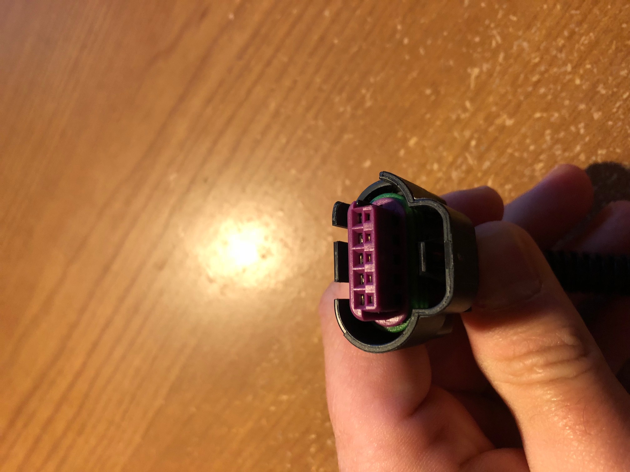

I decided to do the 24x with DBC throttle body, so the computer will be the 0411 variety.
Here's a link to the harness I purchased...
https://www.psiconversion.com/produc...ct-description

I would maybe contact them directly to see what they think is the best MAF to run but that does look like the GEN 4 style MAF plug in.
