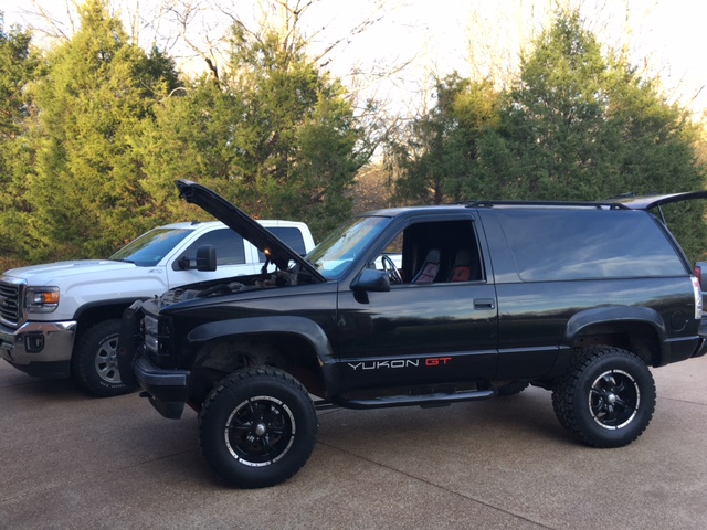

1994 Yukon GT 2dr

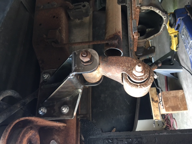

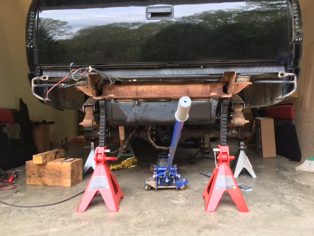

14 bolt semi-float 6 lug rear differential with 4.11 gears and TrueTrac posi. I found this under a 98 express van. Someone had already taken the factory chunk from it, but it still had everything I wanted. It had the axles and pinion still there. Original pinion allowed me to get a base line by using the factory shim stack when setting up the rear. I've had to cut off all the factory brackets and use brackets from RuffStuff Specialties along with new reverse mount u-bolts.
I've installed Offroad Design shackle flip kit.

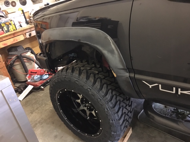

I've installed 35" Toyo MT's with 20x12 wheels

1994 Yukon GT 2dr
