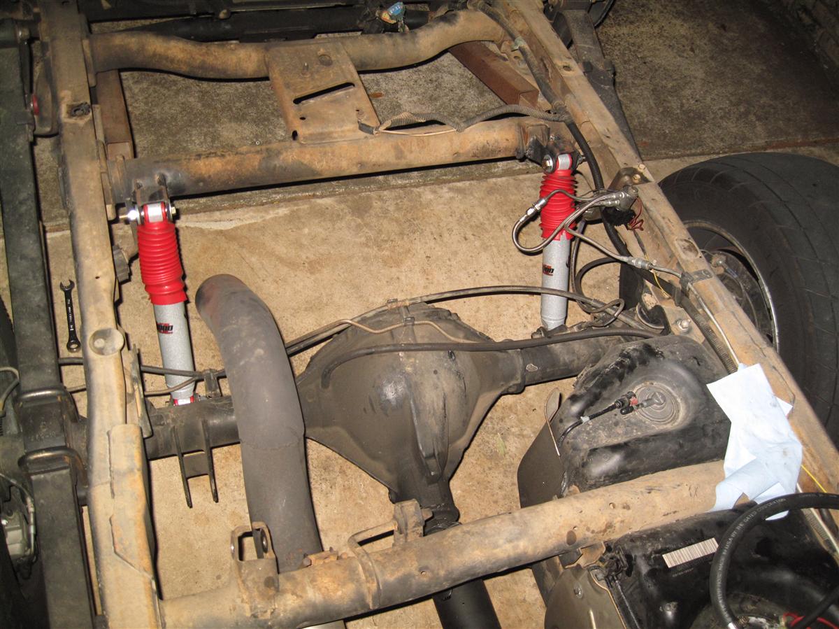

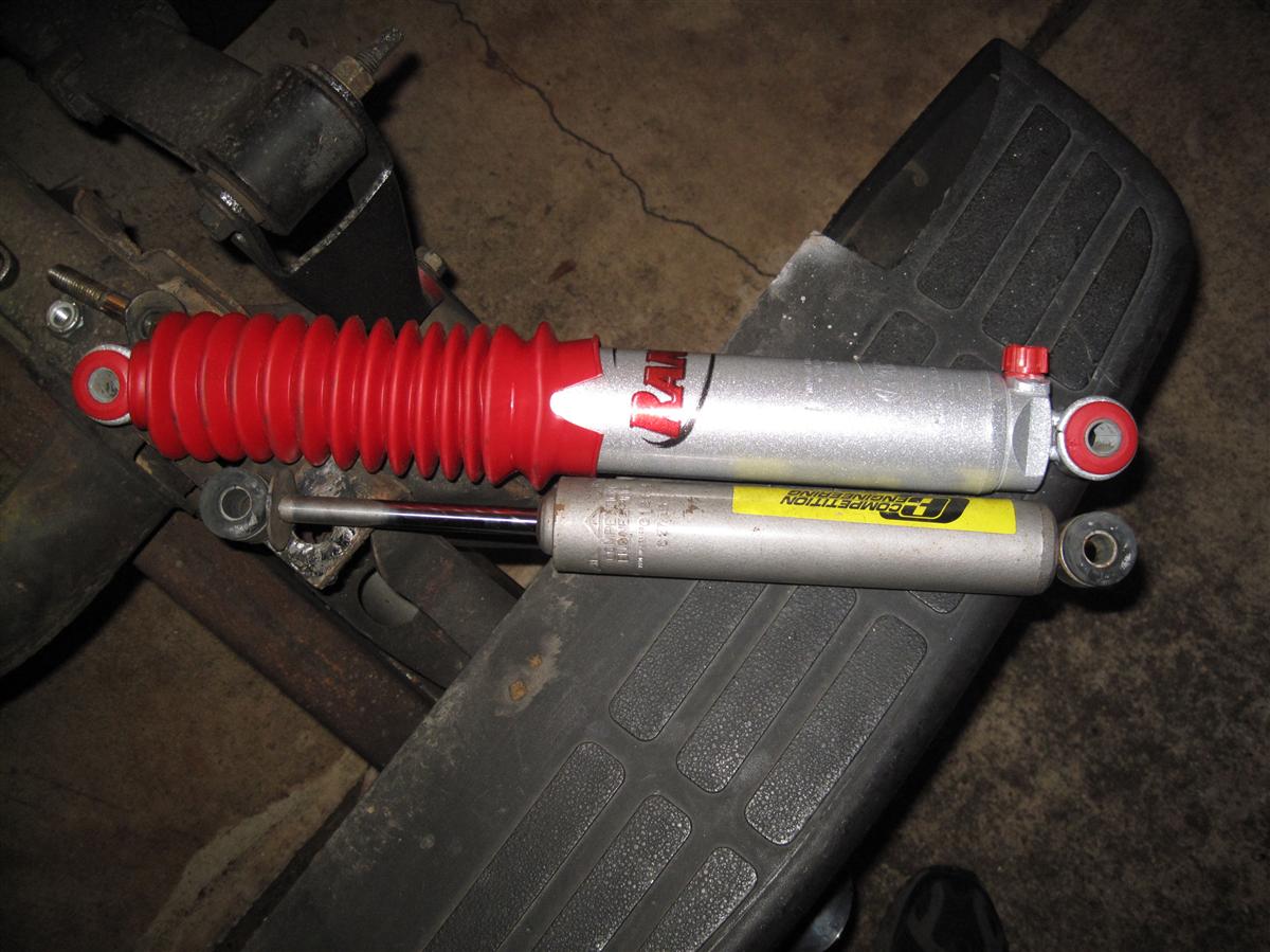

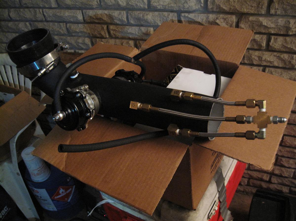

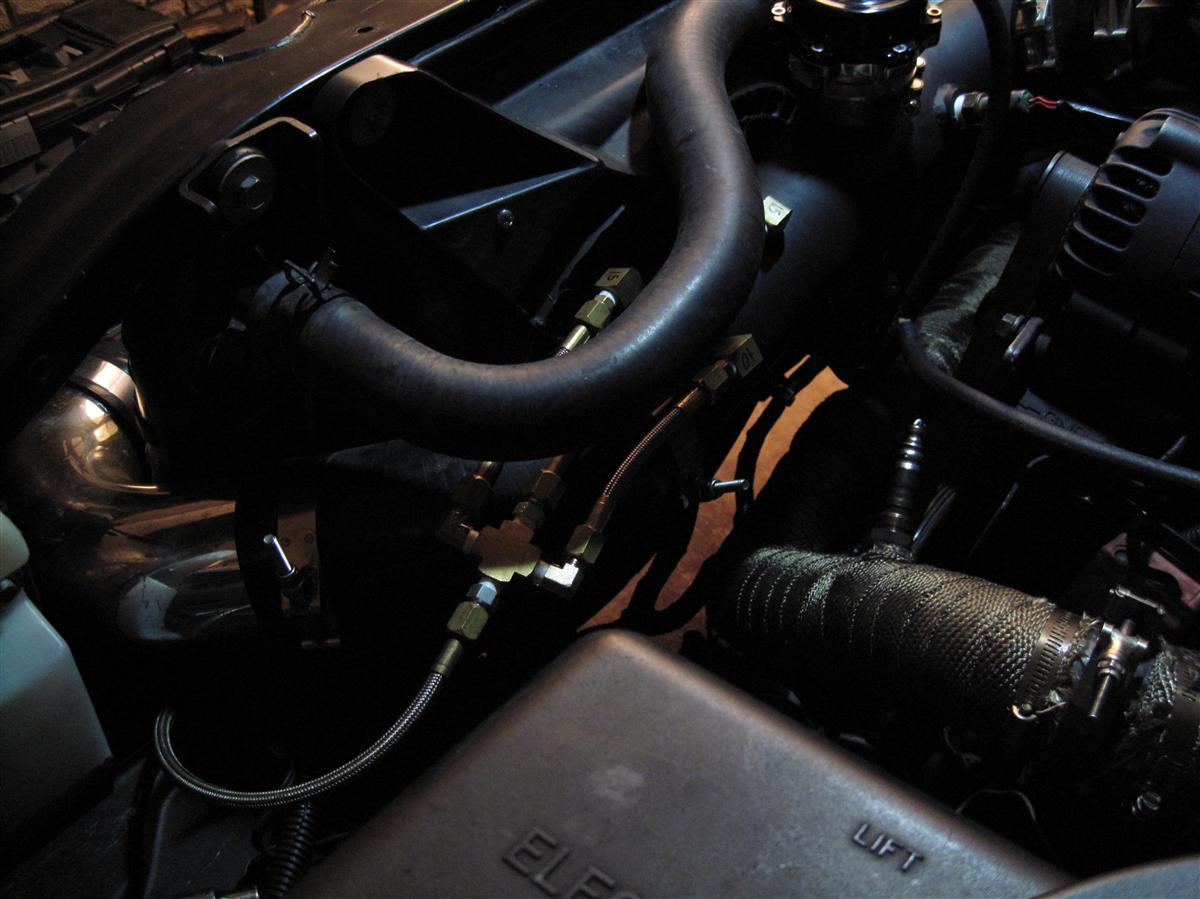

Working on a lot of upgrades lately. Getting the ball rolling on a 5" downpipe and slightly bigger turbo (82) with a bigger turbine. Scored some rancho 9000 shocks for the rear, upgrading the fuel pumps to dual walbro 400s, and added another meth nozzle. Speaking of which, this thing looks like something darth vader would go snorkling with

I actually need to play with the meth settings a bit more....may try a higher activation pressure and lower initial amount, but use a higher ramp rate. In any event, with the bigger pumps I estimate I have enough injector and pump for 1350rwhp without meth, so I wont need to use meth as a bandaid, just as cooling and knock suppressant.

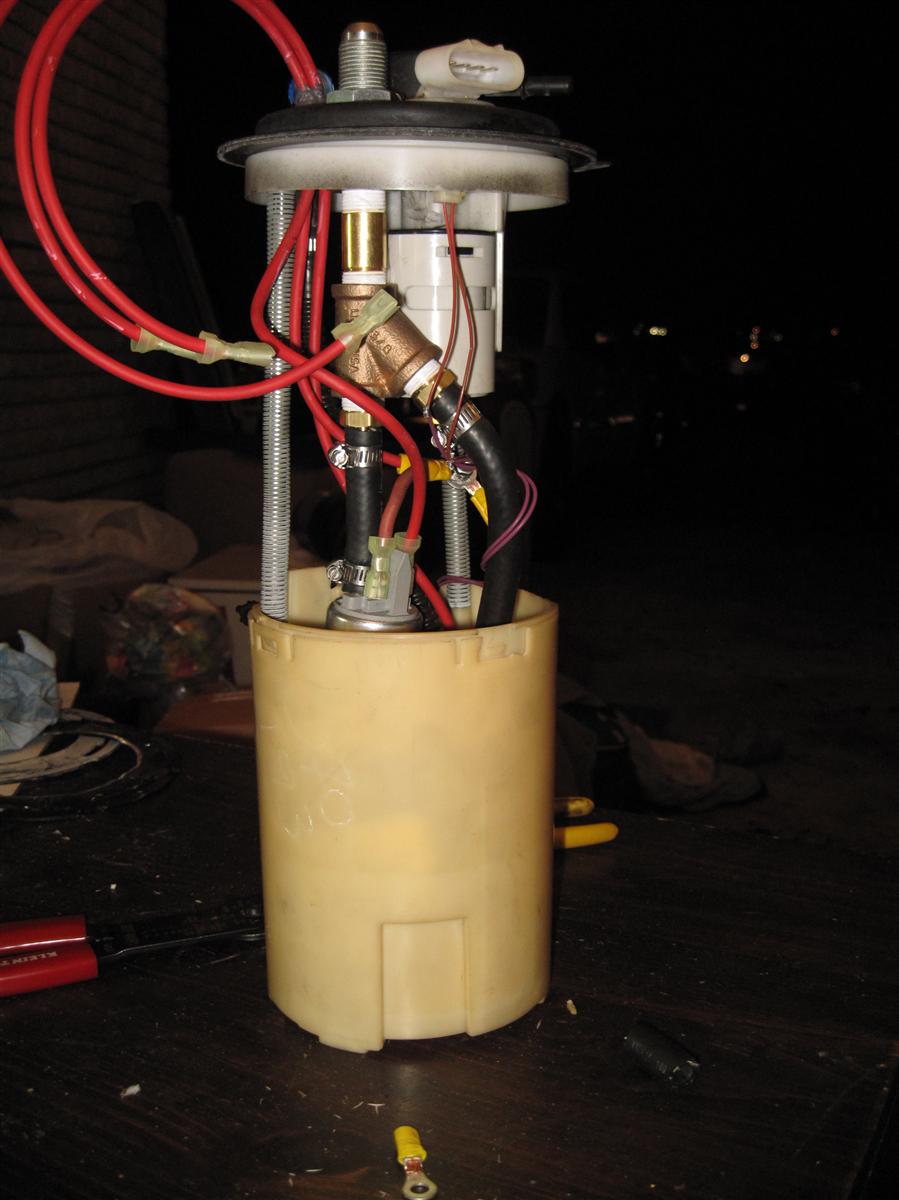

I redid my fuel bucket using an 07 top part, and 04 lower bucket, with a 99 level sensor

Also installed these guys, starting out at 7/9.

Doing the test of jumping on the bumper seems 100 times better

Whats wrong with brass? Especially considering where it is...very corrosion resistant

Ah, well total cost in that setup is like $30 vs close to double that for an fittings that didnt work as well...
