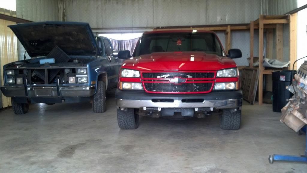

viciousknid's Avatar
Where's the Beef?
Posts: 9,382
From: Dover, Oklahoma

What did you use to spray your trans cooler black?
Old Jan 29, 2013 | 08:51 PM
Where's the Beef?
Posts: 9,382
It's not. The a/c condensor is black and the billet grille is black. Most people just use paint and make a really light coat. Basically just mist over it.
In my case I have a billet insert that I painted black and you can't even tell that the transcooler is there unpainted.
