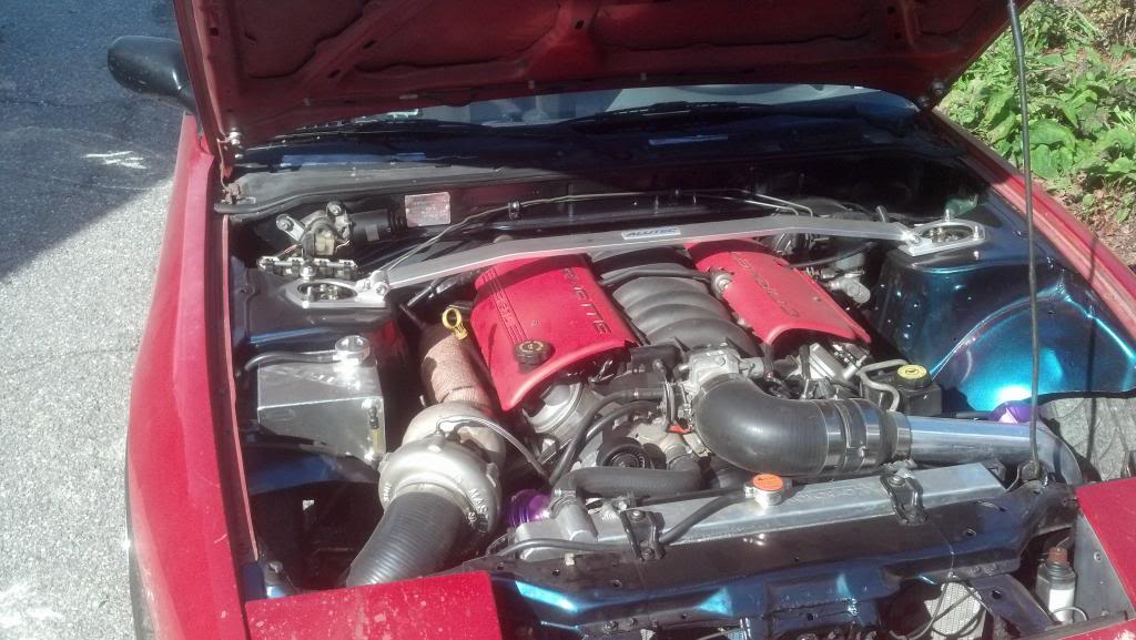

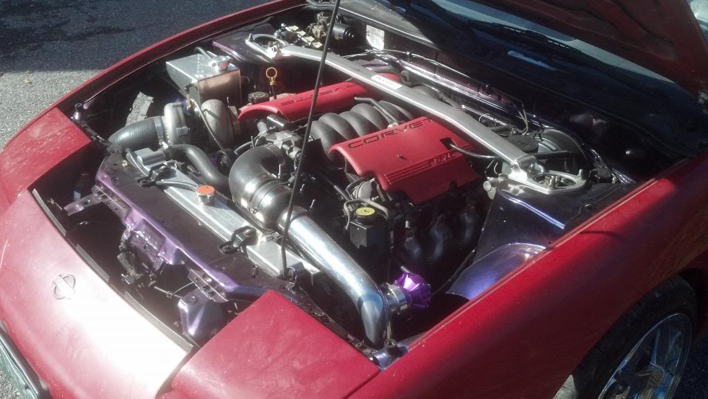

I'd always wanted a turbo LS of some sort, so when I picked up a spare 'vert 240sx I decided it was time to do a turbo build. Originally ran a 4.8l and MPT70, 4.8l was super clapped out so we swapped it out for a 6.0l and daannggg is it rad. The car is insane, no convertible stuff, gutted and a cage I'm estimating it around 2400lbs give or take, with 275/40/17 Falken RT615K's it spins 4th at 75mph just rolling into it! Downside, no roof made storing it a huge pain. It couldn't sit in the shop all the time due to customer work, so it was always in the trailer leaving my main car out in the weather. No dice.
Sold the vert shell/in the process of selling it, killer deal on this rcsb came on Clist so I went and scooped it up! $900 for what's basically a roller in decent shape (for Vermont), and it's the exact same color as my other rcsb! The body is in rough shape with some dents and scratches all over, but the under side isn't horrible rusty and it was so cheap I couldn't pass it up.
I'll be leaving the exterior all beat and clapped out looking aside from some new headlights, painted bumper stuff up front, rollpan and wheels...but it'll still be sneaky/clapped out looking. The engine bay/driveline, and interior will be super nice like my other projects, really going for the sleeper dealio with this one; and a vanity SHOPTRK plate :-)

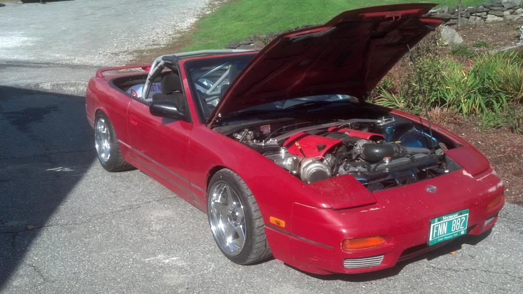

Vert/donor car

Vert/donor car

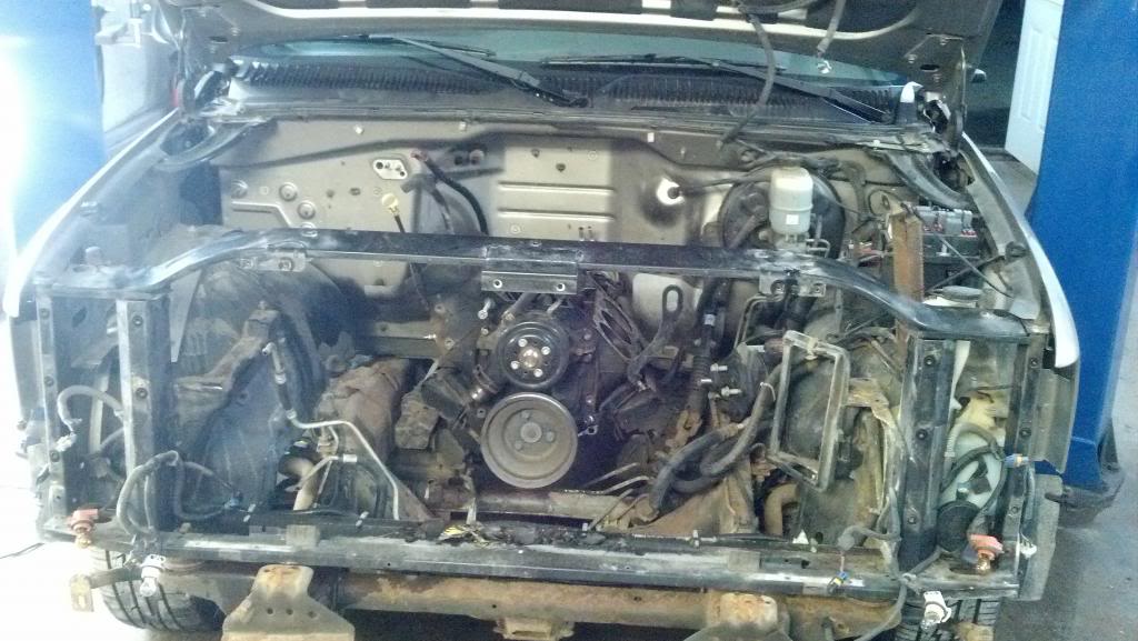

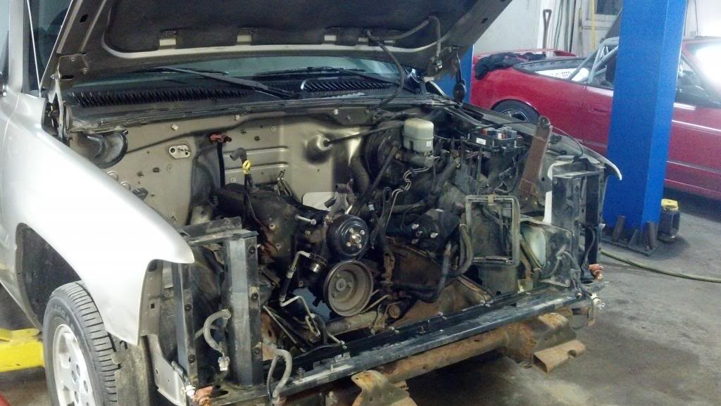

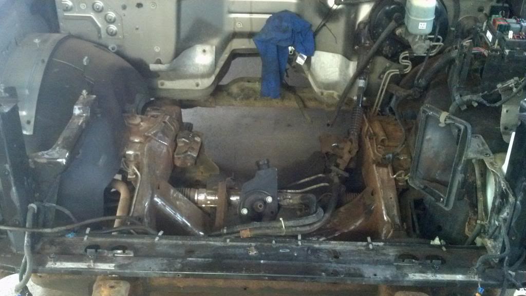

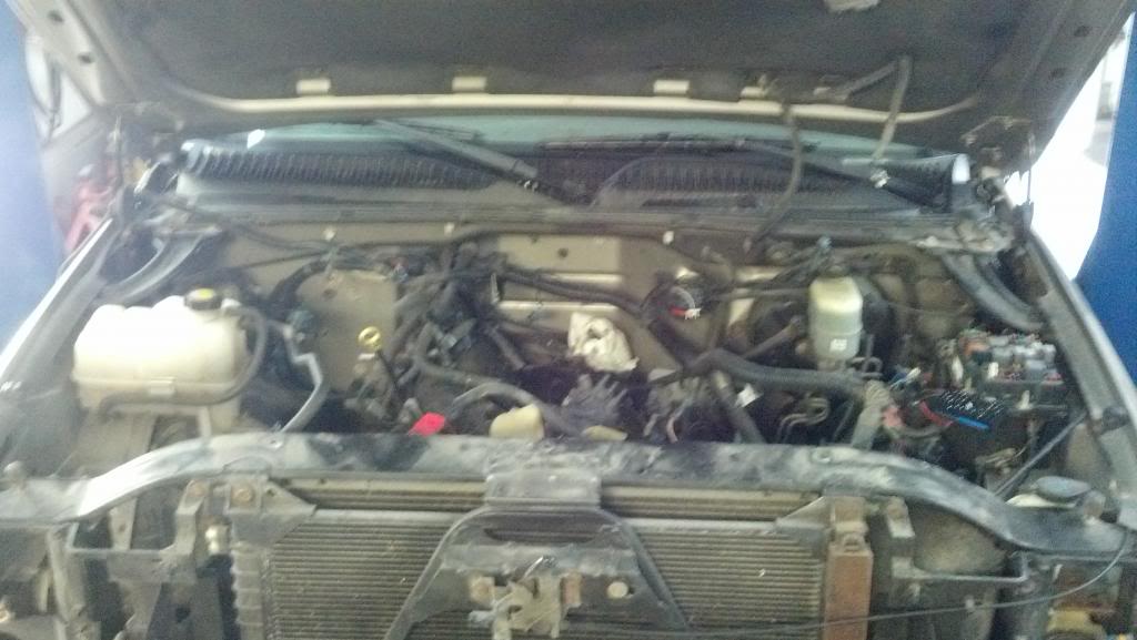

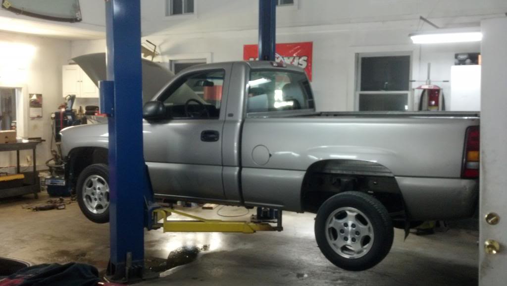

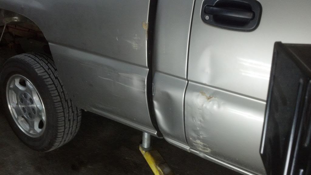

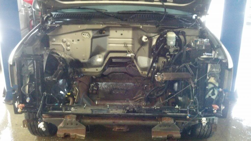

This past weekend I had the shop to myself, so in came the truck and I got to work!

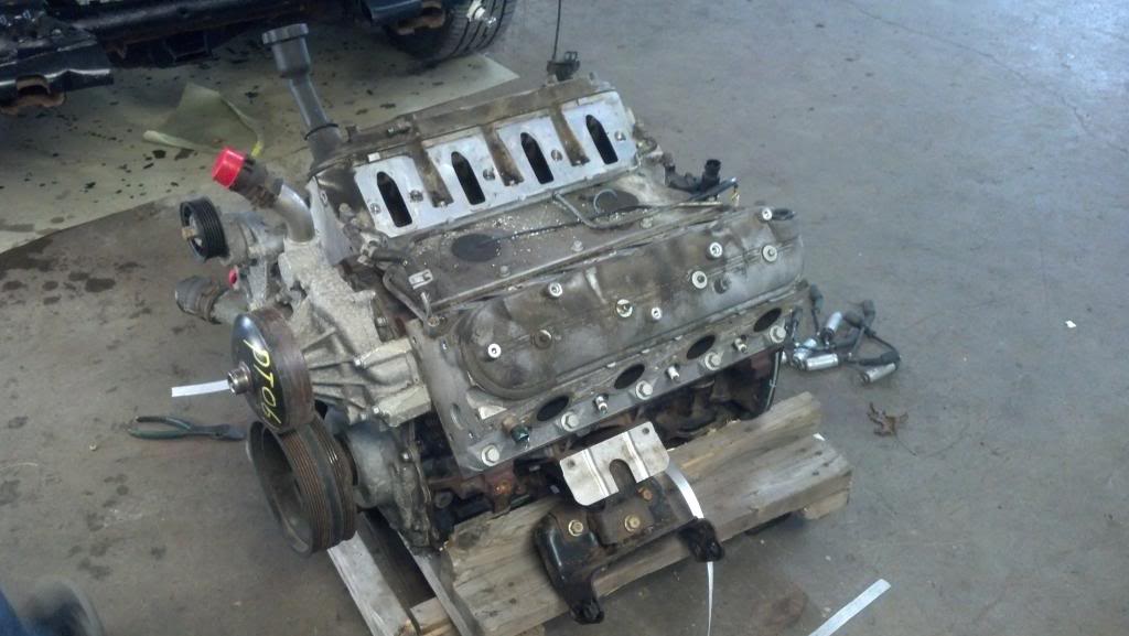

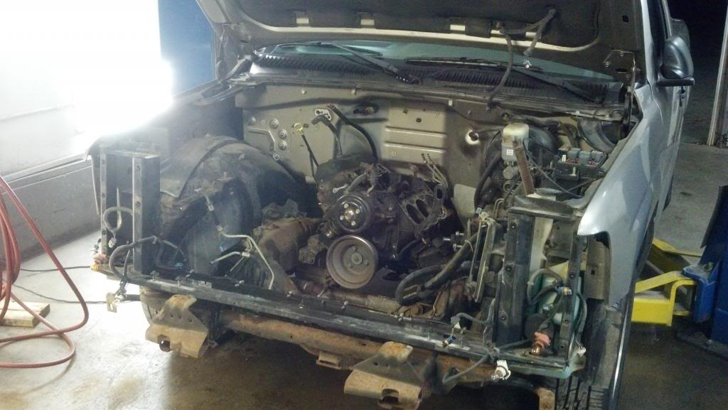

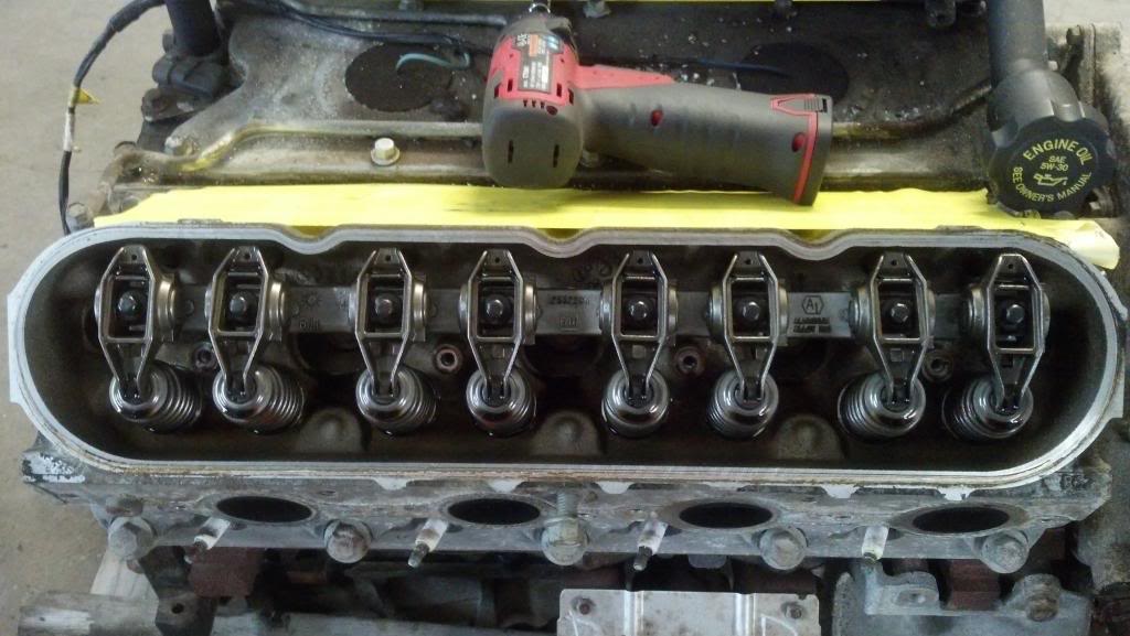

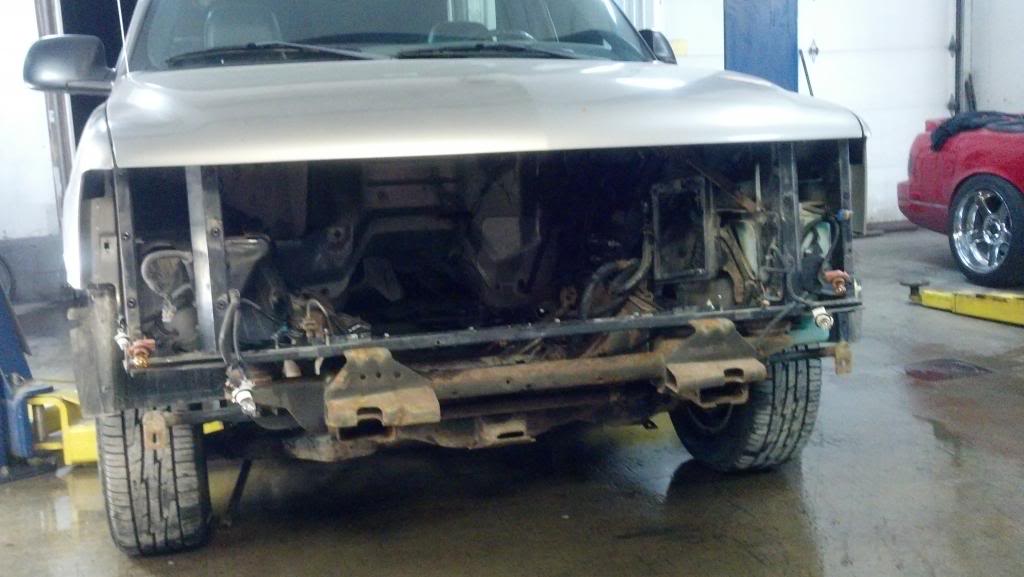

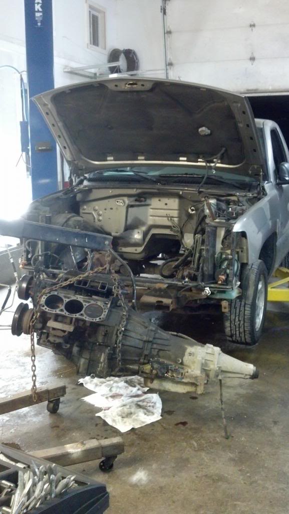

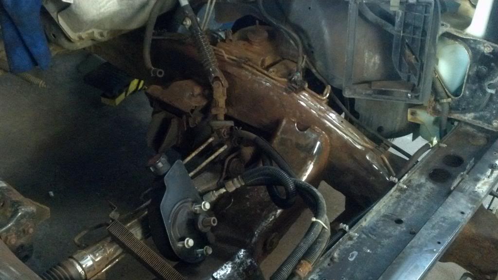

I started Saturday morning around 11am, full front end was still on, but the motor was torn halfway apart by the previous owner. My goal for the day was to get the majority of the front clip off, and the entire drivetrain/exhaust and wiring harness stripped out of the engine bay.
I forgot to take pictures before I started, I had most of the grille and what not off and the harness halfway out when I remembered to start taking pics haha.
Found these guys under the rad...they were still wicked colorful for being cooked.

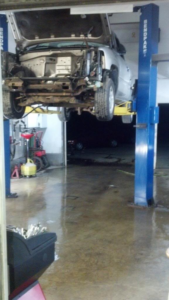

Almost ready to pull
The bright florescent shop lights suck for cell phone pics, sorry guys!

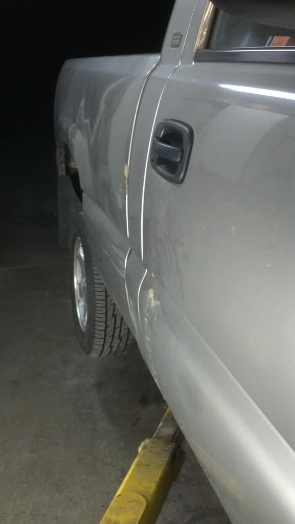

Dents and clapped out-ness
Ta-daaaaa!

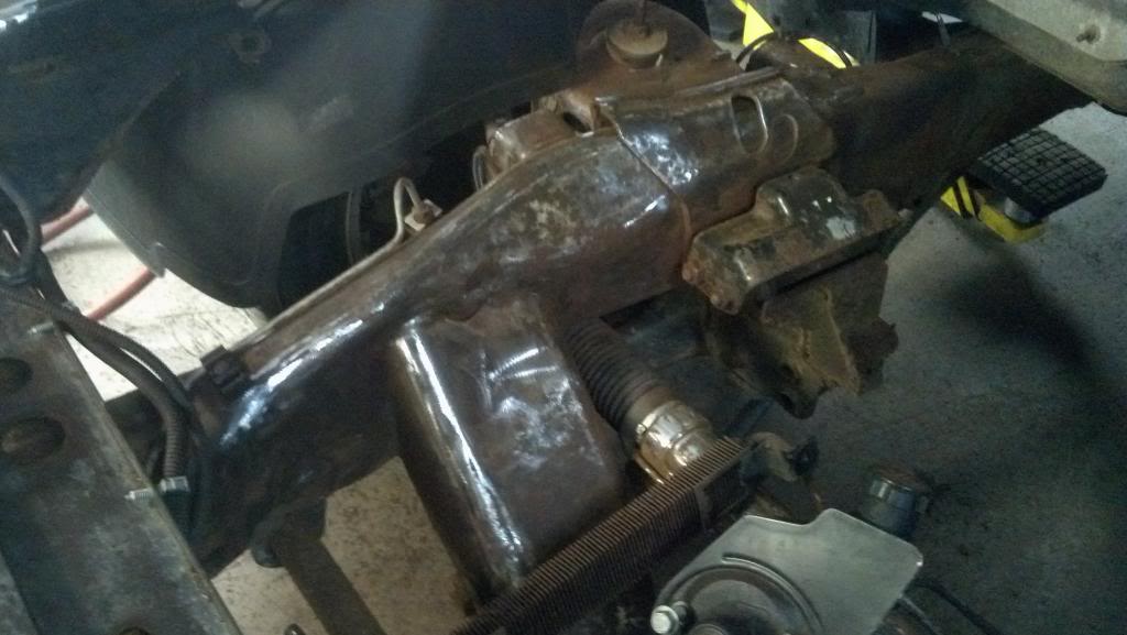

Stripped underside

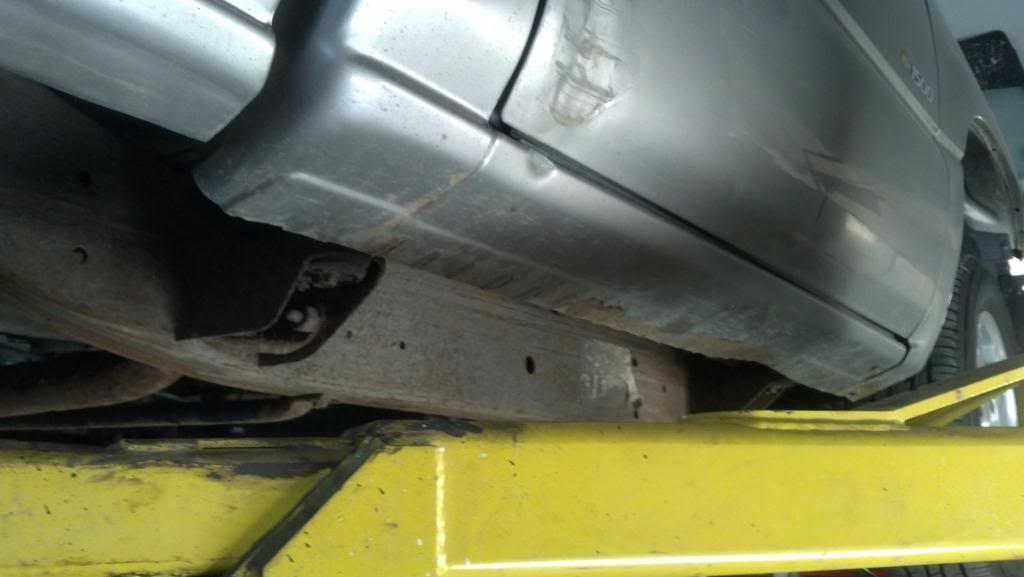

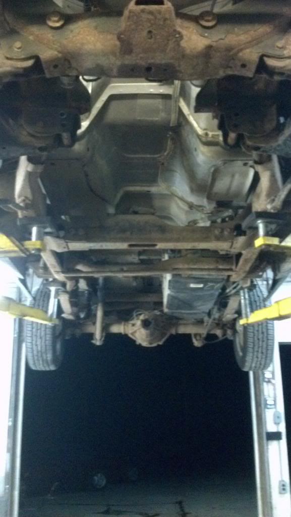

The truck has some scale on it from sitting a decent amount of it's life, but luckily there isn't any real ROT or holes in it like 99% of Vermont vehicles.
VT salts the roads in the winter and has recently switched to that bryne/brine sp?? mixture/liquid stuff and it's really been harsh on cars these past few years...so this is what I deal with in the shop frequently. This is a 2003 Subaru Outback rear subframe.
Come 9 o'clock I had the truck stripped, the floor washed/degreased and I was ready for some beers!
Ta-daaaaa!
Stripped underside

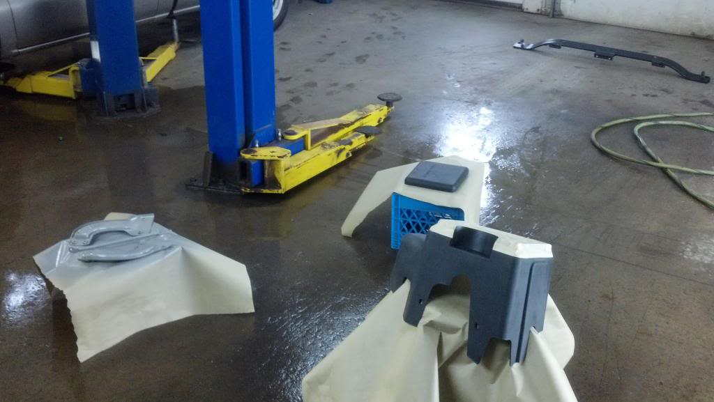

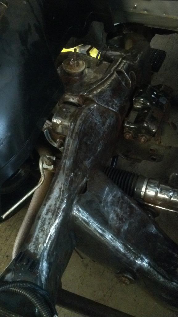

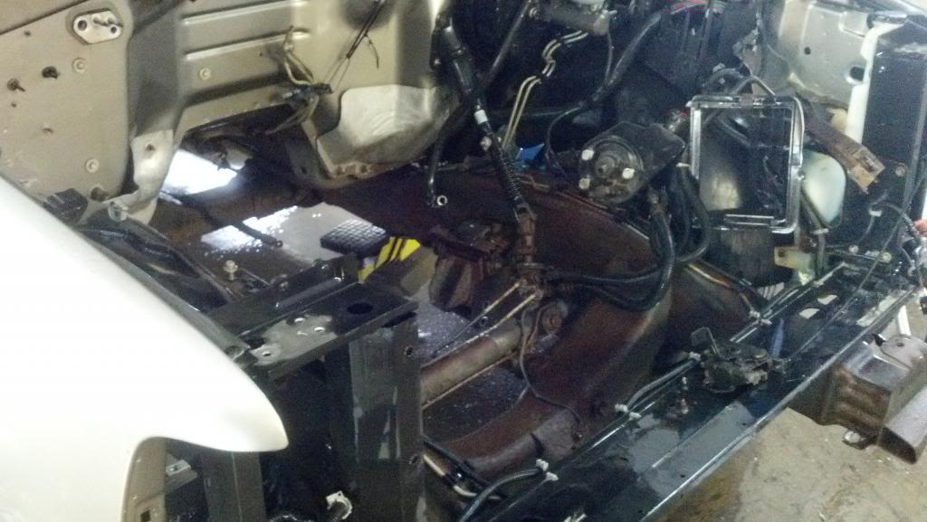

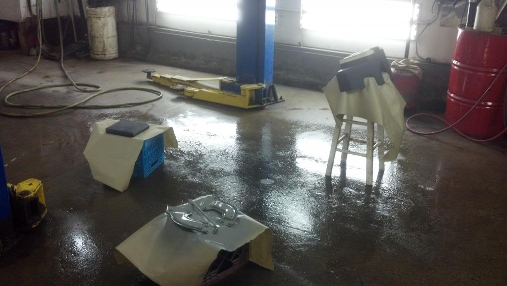

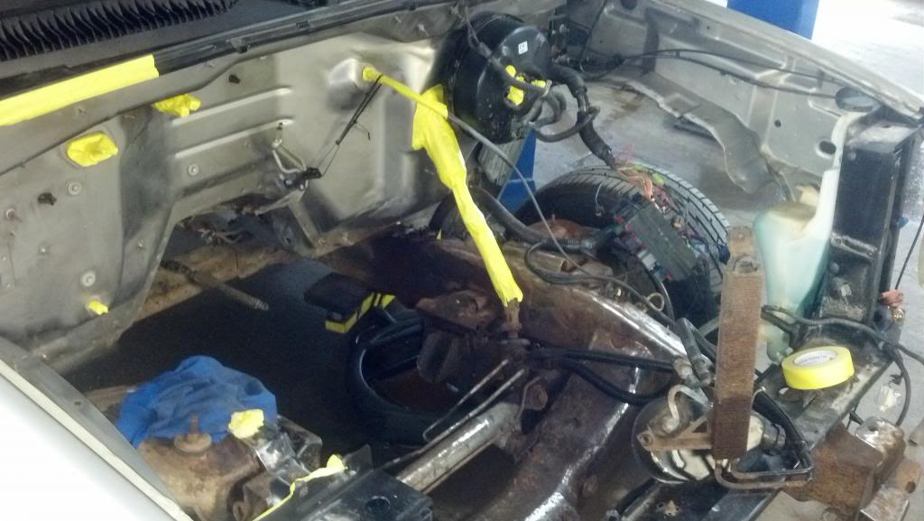

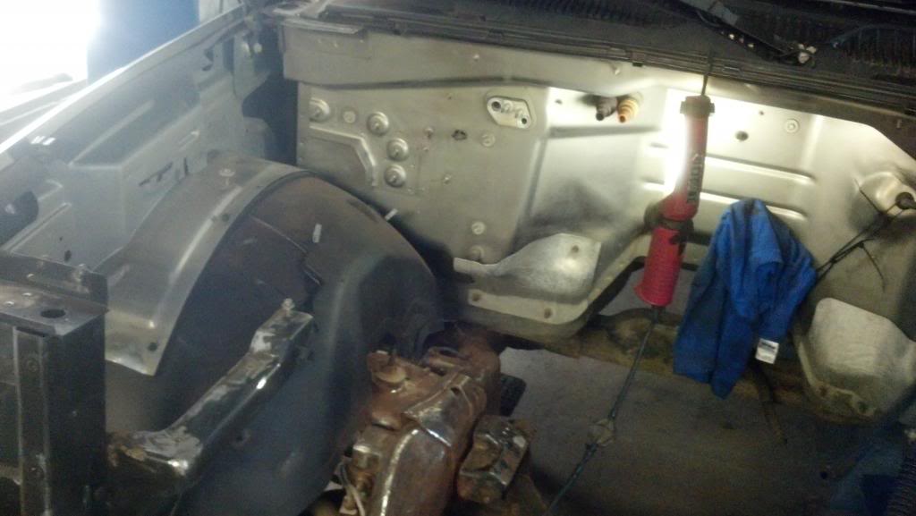

Sunday I decided to just degrease the engine bay and start prepping and painting a few pieces and call it a day.

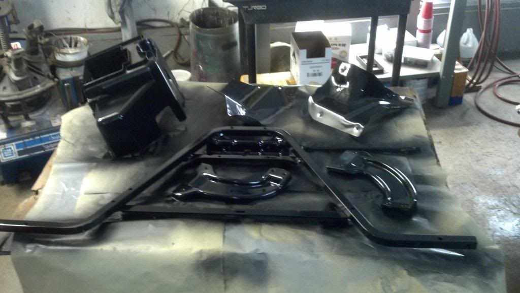

I decided to paint most bracketry/small stuff what the drift world calls "East Coast Grey". It kind of looks like a shiny primer *shrug*. Makes for a clean, simple look and contrasts really well with black and darker colors/areas like engine bays.

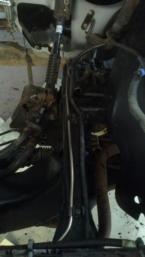

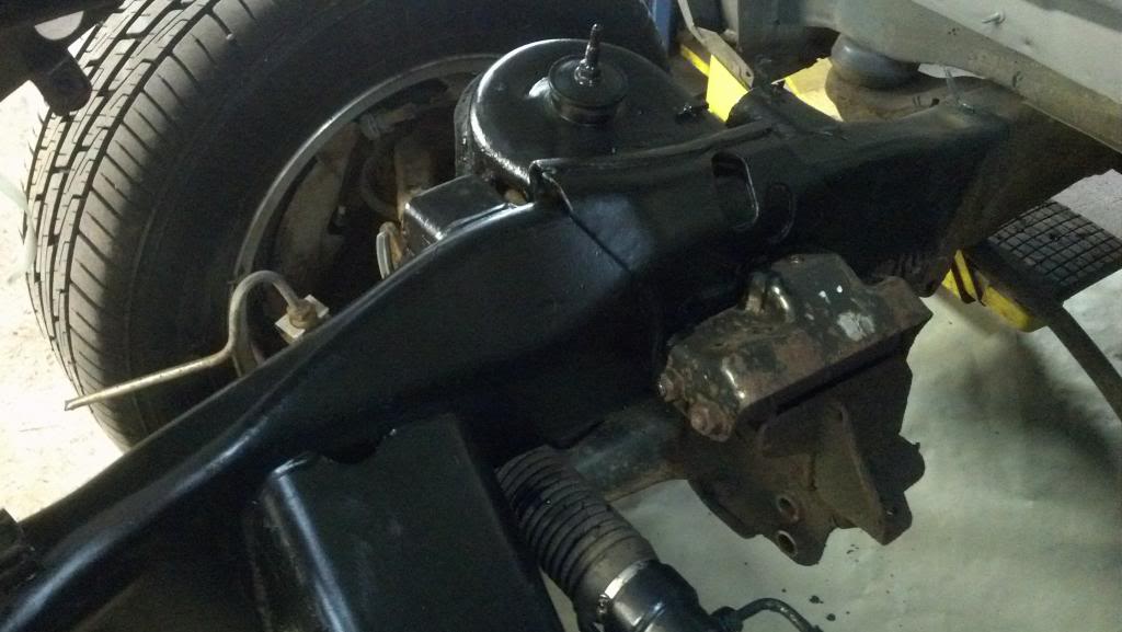

After our stupid busy work day today I broke out the wire wheel and grinder and started cleaning up the front frame rails/engine bay rails.

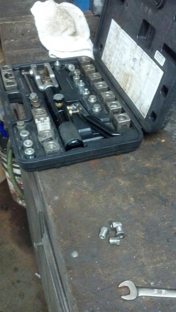

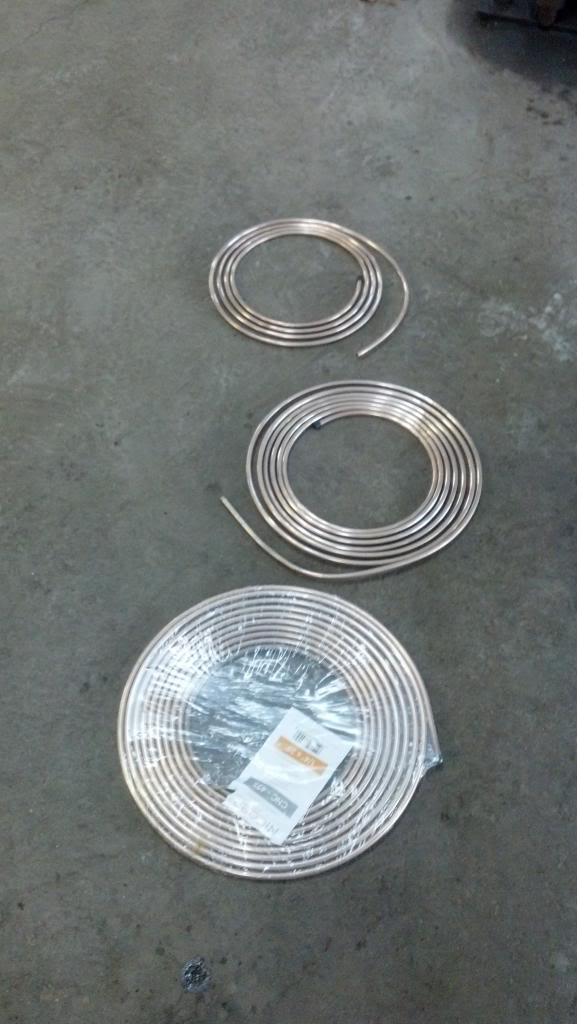

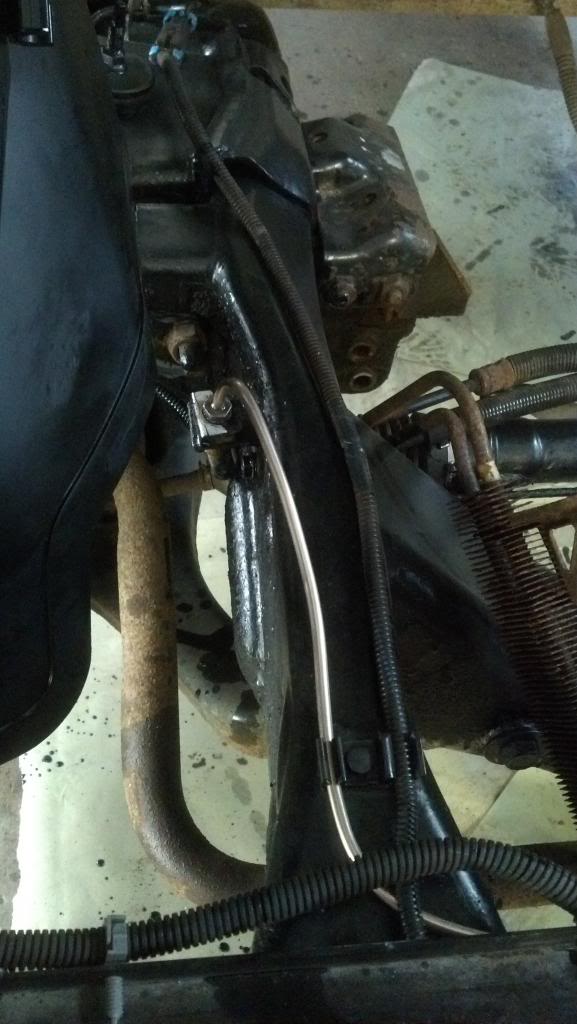

All the brake lines in the truck will be getting pulled off and replaced with all new 1/4 Bronze-lite line and new fittings, VT hasn't been kind to the drivers side front line or the rear line post ABS unit. Once that's done I'll finish cleaning up this drivers side.
I put away the wire brush and grinder and got out some "rough" scotchbrite pads and started sanding the insides of the fenders and the firewall.
I'm still debating what color to paint the inner fenders and firewall. I'm torn between either black or the East Coast Grey. I was thinking the ECG would look good especially with the black fender liners and black brake booster and all the black wiring, but then again I don't want it too be TOO grey in there. Also don't want it TOO black/dark. Thoughts/opinions on which color to go with would be appreciated!

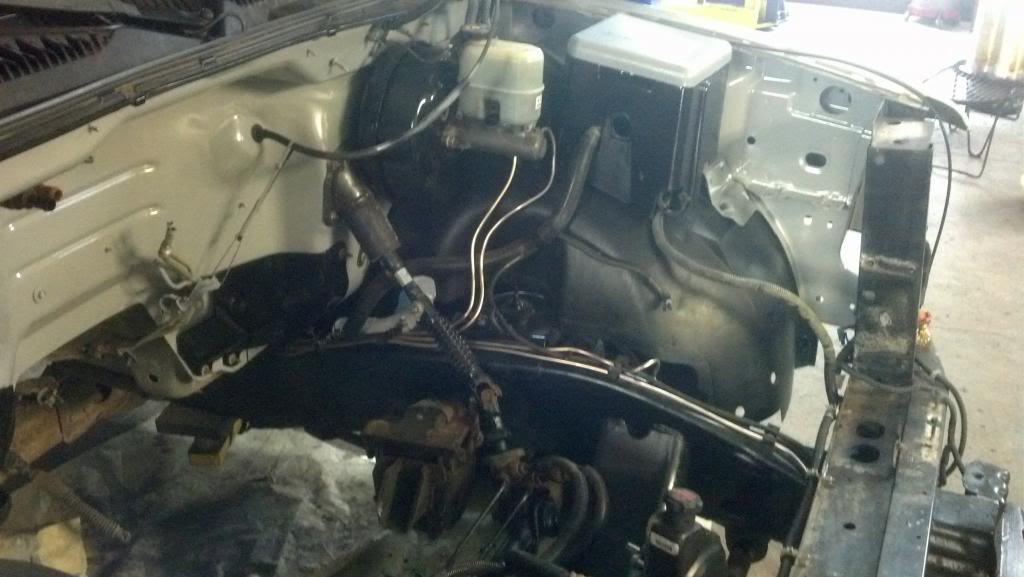

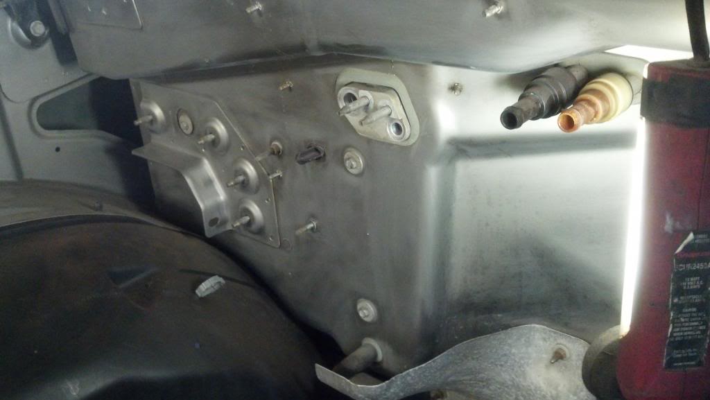

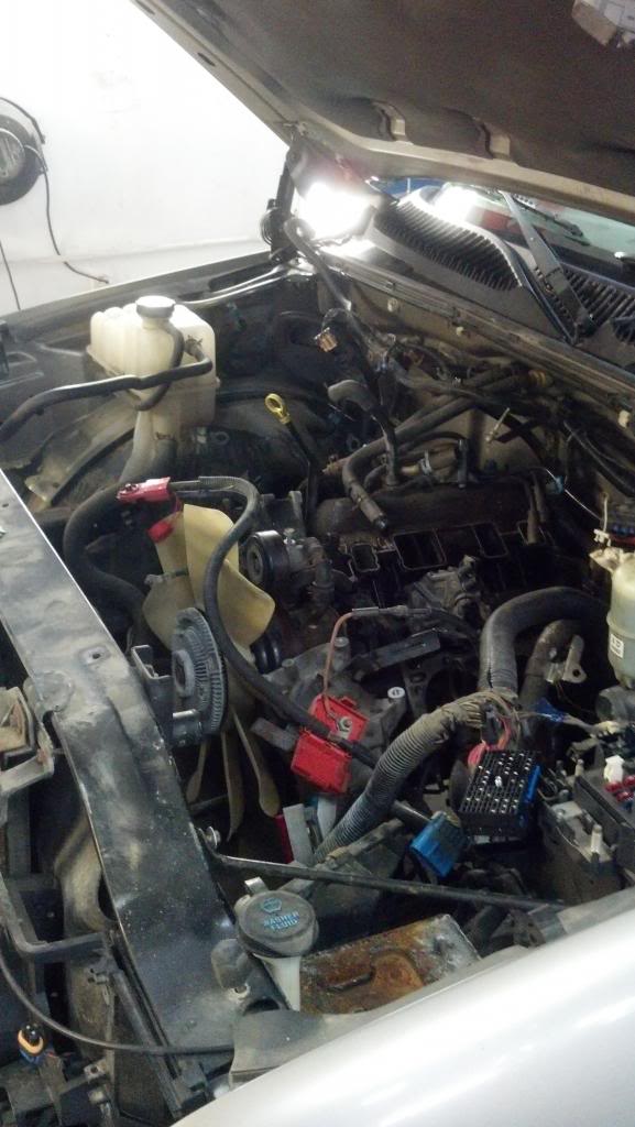

Just a heads up to you...
In the very last picture that shows the coolant quick disconnects going to the firewall, you WILL want to replace the one on the right (white). On BOTH of my silverados this piece has corroded and dumped coolant everywhere! And by the looks of how yours is changing color from white to almost brown, tells me its time to swap that out.
Just a heads up! Gonna be a great build you got going on here when all said and done!
Good to know! Thanks for the heads up, I'll order one of those up tomorrow!

I decided to go with East Coast grey on the firewall and inner fenders and paint other parts black. I painted a few things and repainted some other stuff today as well.

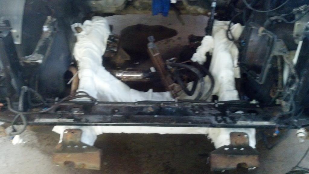

Going back out to the shop in another hour or two to pull the towels off the rails and see how this stuff worked.
Ordered up my EV1 injector pigtails today. Also after a little digging around online last night I came across this "Evapo-Rust" and decided to track some down today and give it a shot. Supposedly removes corrosion and rust and leaves a "like new" metal underneath, washes off with a hose, non corrosive/acidic, blahdy blah.
The instructions said for small parts, to let them soak in a bath of Evapo-Rust, and for bigger areas to soak towels in Evapo-Rust and then let them sit on the rusted areas for 1-12hrs.

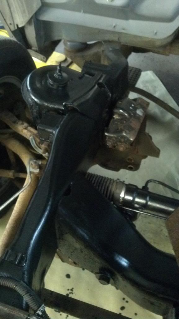

Evapo-Rust would work well for lightly rusted/surface rust things if you can let them sit in a tub of it over night as they advertise...the larger scale stuff where you have to soak rags and place them on the affected areas as per the instructions doesn't work incredibly well. The spots where I had already ground most of the flake off, it did indeed clean that up very well and leave the rails nice and shiny like new, other spots I hadn't touched yet not so much. Oh well, was worth a shot!
Post Evapo-Rusting

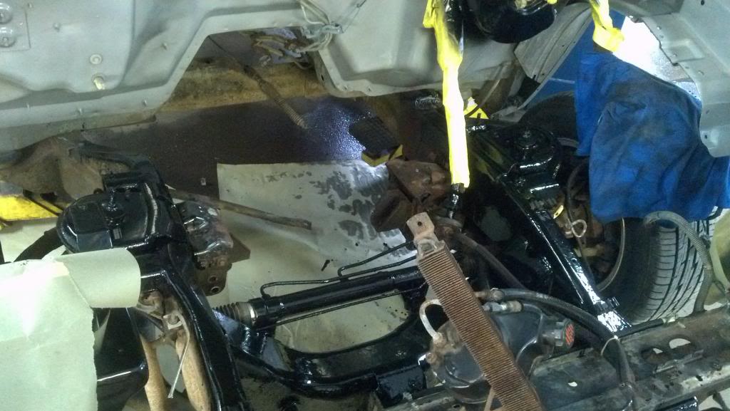

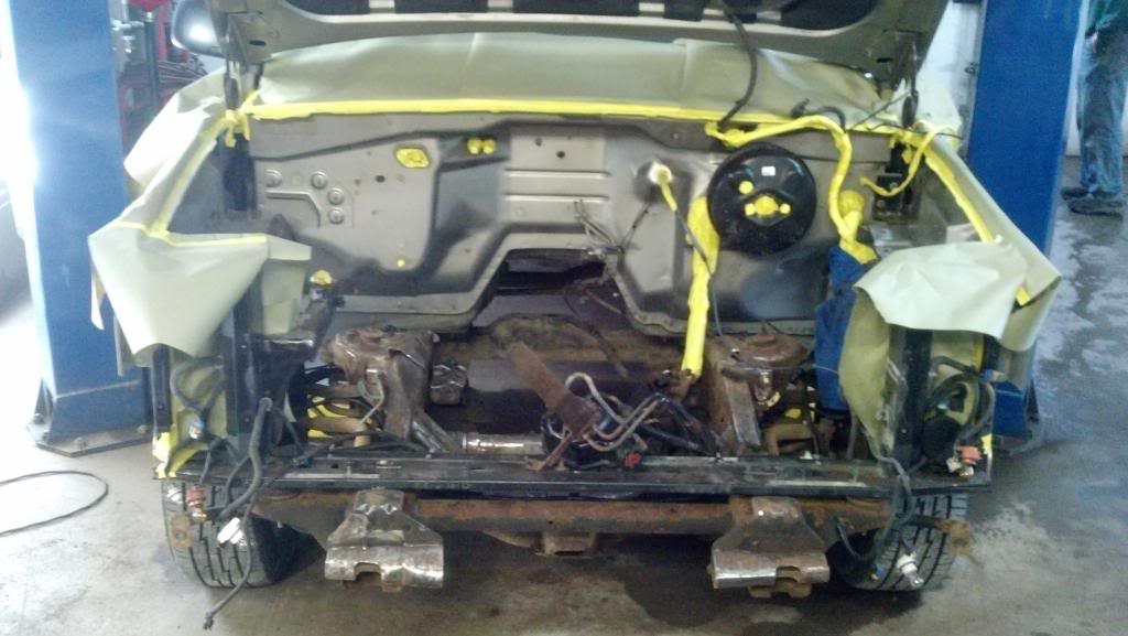

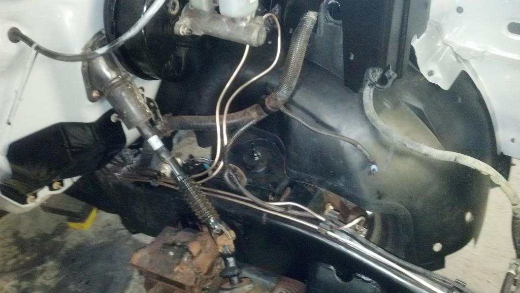

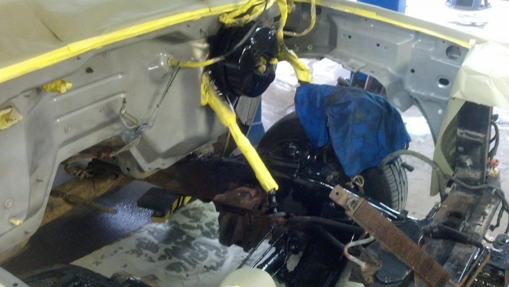

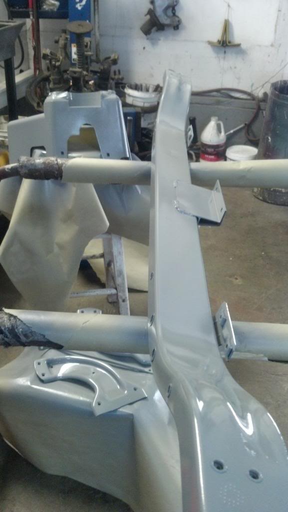

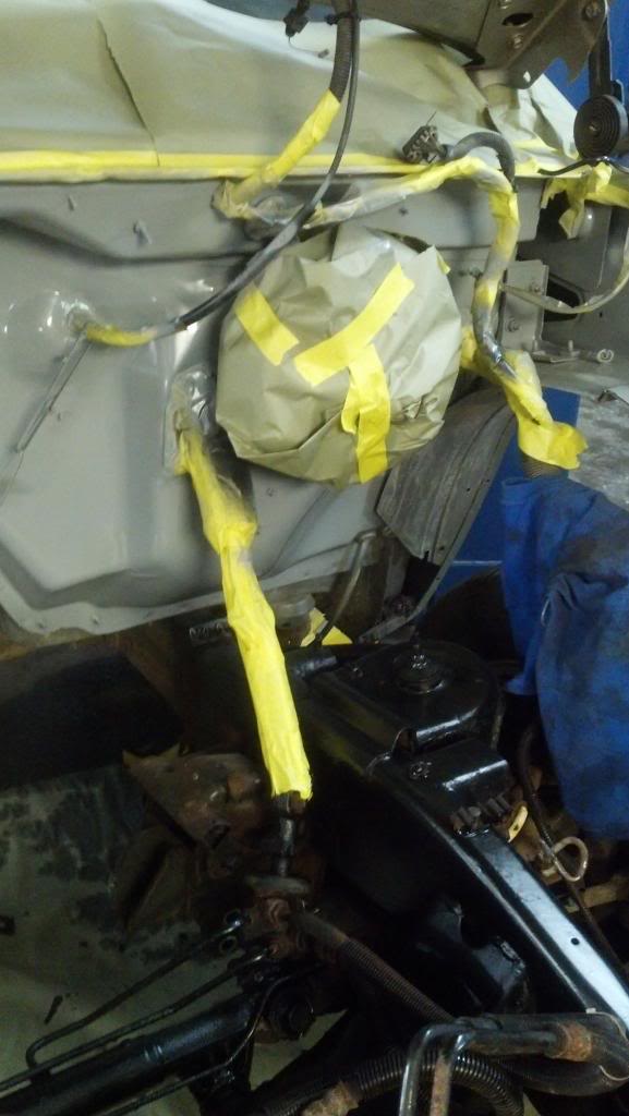

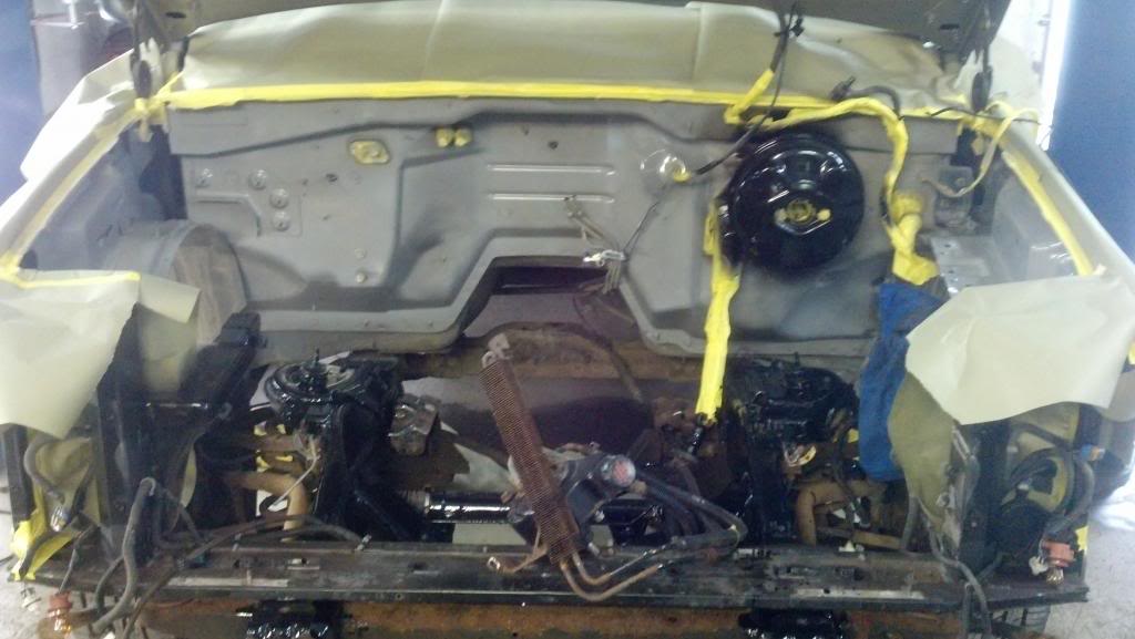

Today/Tonight I cleaned up the rest of the rails, got some more paint, got to taping everything off and went to painting!
Pulled the fender liners and started taping

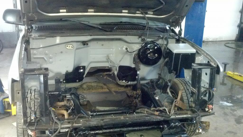

First coat of paint on the firewall and brake booster, also first coat of "Chassis Saver" on the frame rails and what not
Booster masked off so I can finish the firewall, and the rails were mostly dry at this point
This Chassis Saver works really well, would definitely recommend it to anyone looking to clean up any sort of chassis parts on a build
All finished and a few things back in the bay

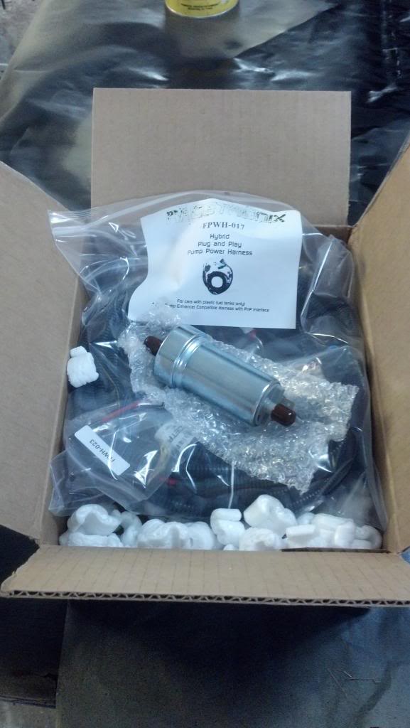

UPS brought a few boxes today, Racetronix package with the Walbro 400lph pump and the hotwire kit. I didn't realize at the time that I bought the Walbro pump only and it didn't include a sock or strainer as some say. So I spent a good 30min figuring out what sock to use/order and where to get it. Racetronix had it, it was $6.25, but you can't order online unless the order is over $10..so after adding four $1 hoseclamps to the order just to try and get it ordered they wanted $12.30 for shipping...lol@that. Did some more poking around online and found an Airtex sock that should work. Ordered via Summit for just under $15 shipped. So to anyone that makes the same mistake and needs a fuel sock for a Walbro 400lph, Airtex sock pn: ATX-FS158 should work. I'll know for sure when it gets here.

Post Evapo-Rusting

Drivetrain is coming out of the 'Vert this weekend and the shell is getting delivered, GM Parts Direct order with clutch line and what not will be here Tuesday, hopefully mid week the motor/driveline will be in.
Does anyone know where the GM quick disconnect fitting is on the truck master-slave line? Example, on F-body's it's AT the slave/in the bellhousing...I've seen a few different pictures of truck setups, some have the fitting at the master, and others seem to have it like F-bodys...any insight on this??
Not too much of an update today, got the brake lines from the master to the ABS unit and back up to the front two wheels done. I'll be doing the rear line when the bed is off to do the fuel pump and shackles.
New 1/4" bronze-lite lines
A couple fittings and the hydraulic flaring tool
Passenger line
Got the 5.3l stripped down most of the way
Not bad for 60k miles
Truck is going out tomorrow, 'Vert is coming in and I'll be stripping that out so I can drop it off to the new owner Sunday.
