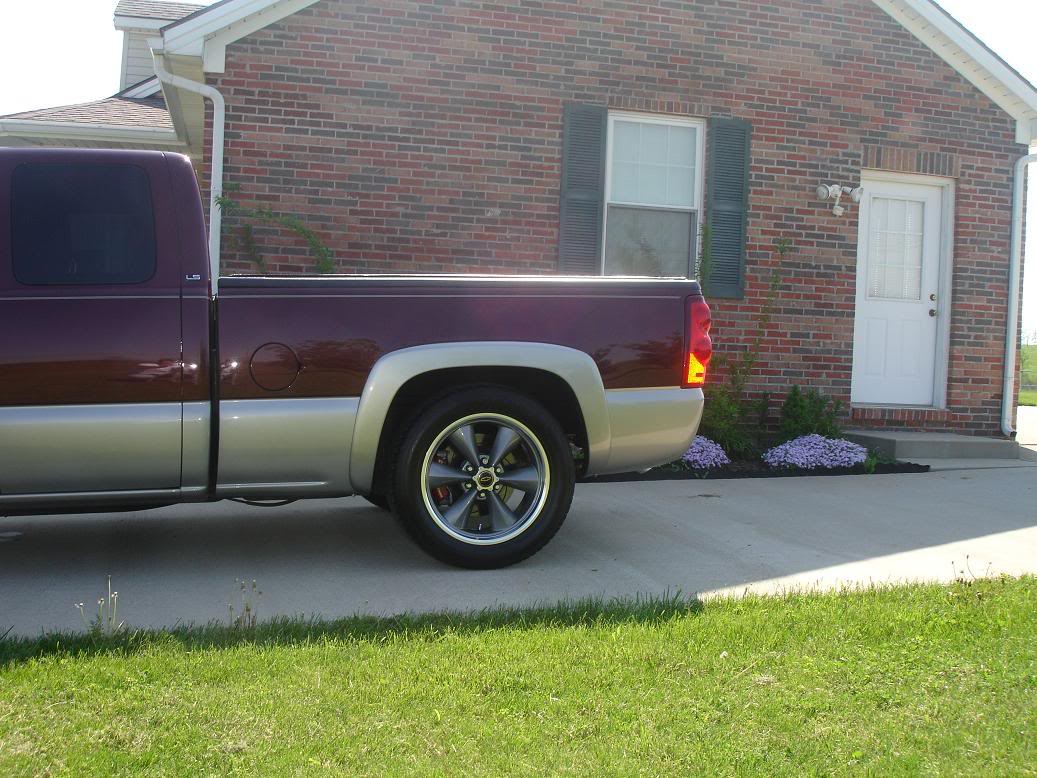

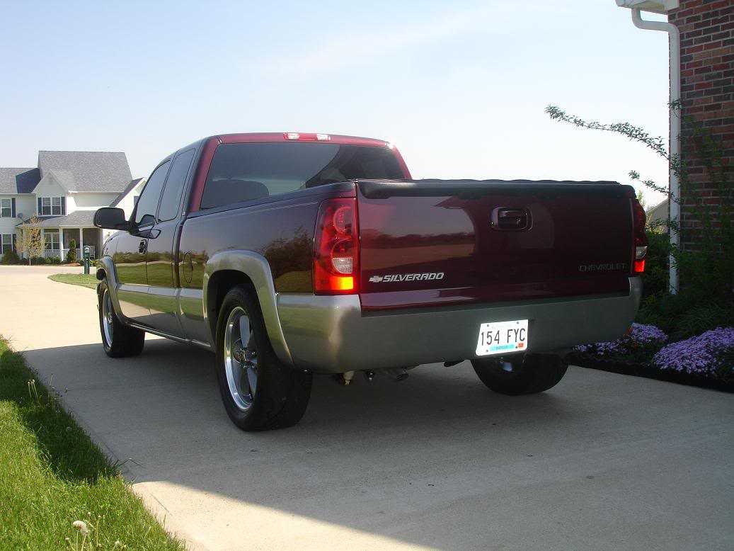

Sorry if I'm picture whoring, but I take a lot. Haven't washed the truck in couple months. Cleaned it up yesterday and snapped a couple more after getting the pan to where it is.
Can't get over how much shorter the truck appears with the bumper gone.

the truck does look a lot shorter... that's one reason I'm thinking I'll just keep mine on were you still planning to paint the bottom of the tailgate to match?
Yes, planning on painting the bottom edge of the tailgate.
Originally Posted by larsy87
Can I have your truck? ...just curious.
Hahahah.... seriously.... no.

not shorter, I think it looks just right
