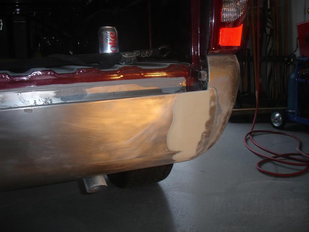

Now to the part that I am the most uncomfortable about. The filler. Doing one side at a time. The passenger side for what ever reason is the worst. I know I had it fit better than it turned out after I welded it. The pan is sitting to low here and will require the most work. You can see the low section in this first photo. Went back in with some 80 grit to scratch it real good before adding the filler.

Only so much I can take of this at a time. It's been 20 years since I've sanded any filler. Seems to sand much easier now. Any tips from anybody on how to gauge a good filler level here I'd be most appreciative.

What are you blocking with?(sanding) and what direction are you sanding it? are you going to use a guide coat?
Sanding palm type block. Cross sanding at 45*. Yeah I will guide coat it when I get closer.
