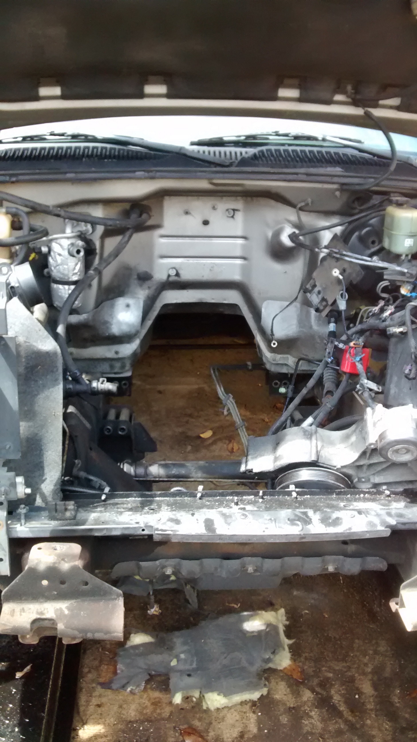

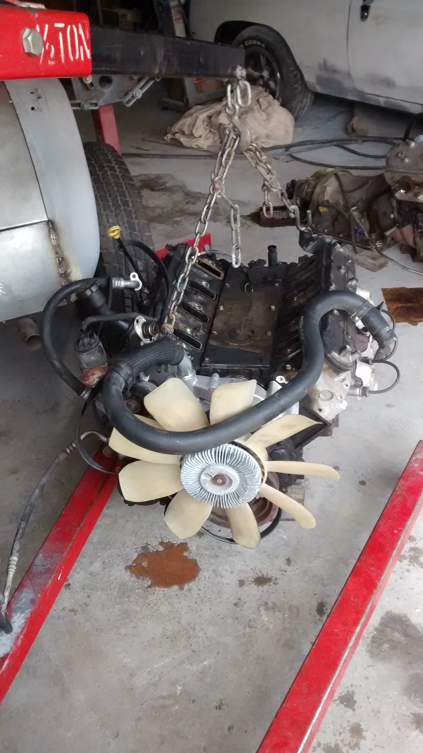

The planets finally aligned ...
Attached Thumbnails RCSB LQ4/80E swap... Take two-img_20160521_113001433.jpg   RCSB LQ4/80E swap... Take two-img_20160521_112934540.jpg

Took ya long enough jeez!!!!
