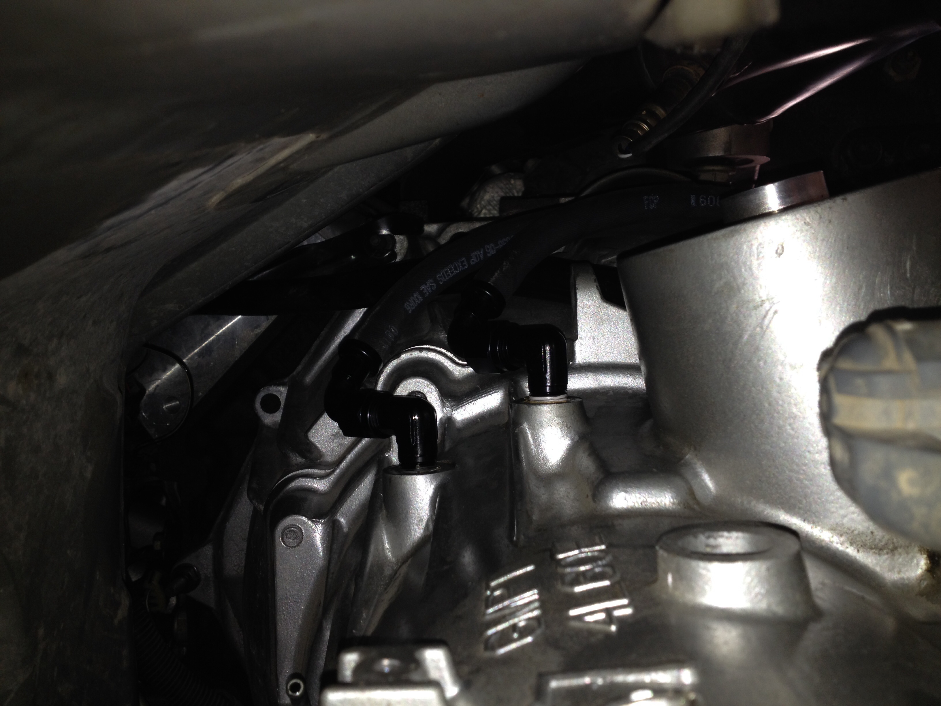

Well got the cooler installed, new converter installed. I ran all -6an pushloc aeromotive hoses

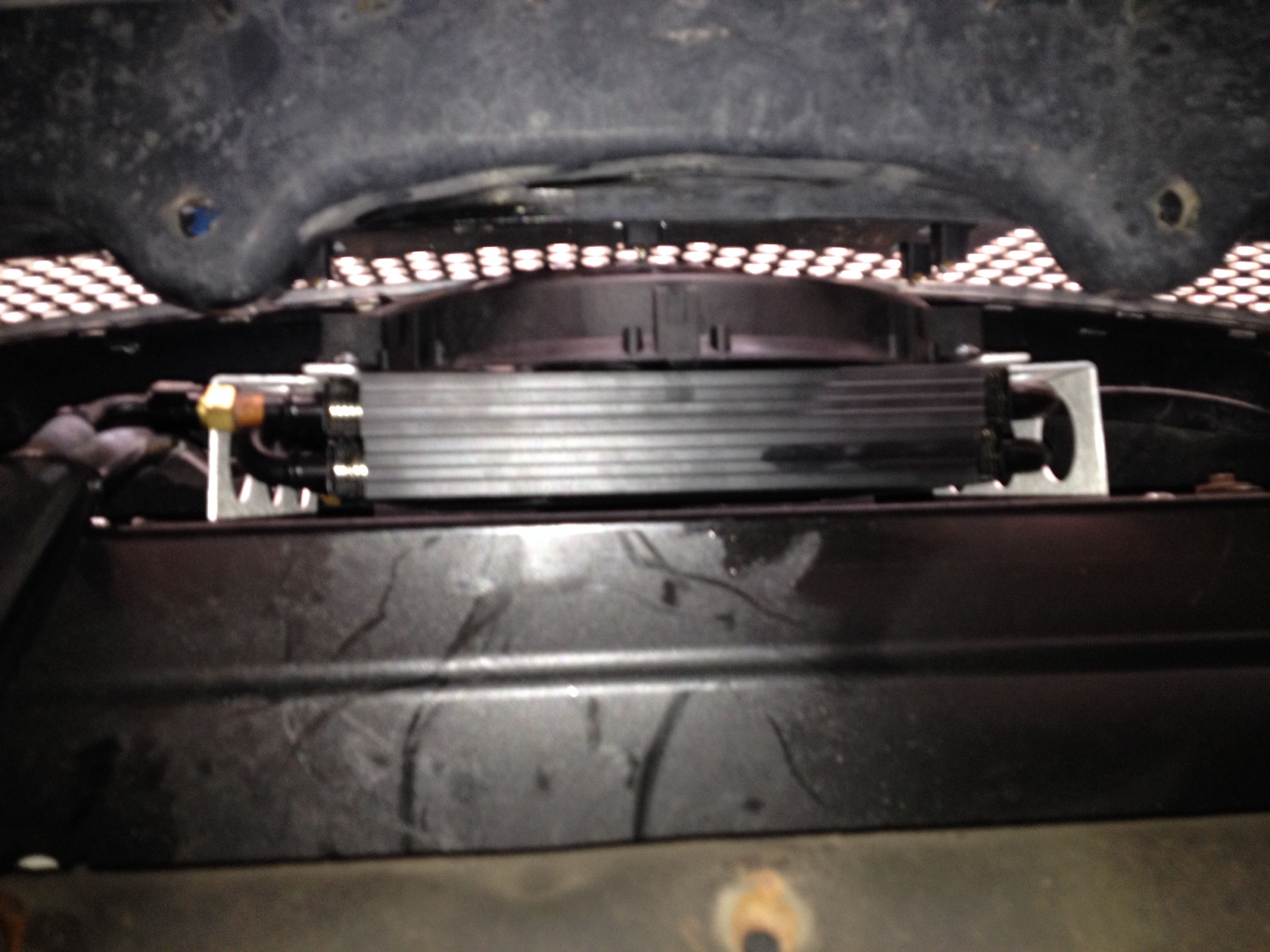

Another pic of cooler from underneath. I tried running the lines through the factory cooler. I pulled the fittings out of the factory tank. But the the cooler fell into the tank. Come to find out the fittings sandwich the cooler to the plastic. Not gonna lie felt stupid after that. Lol so I didn't end up running it thru the factory rad cooler, so I put it back together and I just by passed it. I also will tie the cooler fan into the radiator fan and turn it on at 180.
